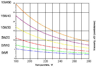

It's not my expectation, it's fact. I'm also not speaking about the compressibility of a fluid, but rather the ability of a less viscous fluid to maintain its properties outside of its intended range.
In this case we are talking about a 5w20 oil. Generally 10 mm2/s of oil viscosity is preferred at the bearing in a high load/ high sheer environment. That is on the high side, but it serves just fine to illustrate my point.
At 212F a 20w oil provides, at a maximum, <9.3mm2/s of viscosity, similar to a 10wt at 180*.
At racing temps, ~230, a 40wt approaches the viscosity rating closer to what is generally accepted, 10mm2/s.
The chart is rather rudimentary, but is based off SAE data.
The additive package in the base oil is important for lubrication, but that additive package can't do its job if the oil carrying it is too thin to provide an effective film. That's where viscosity comes into play.
It's not the compression of fluid, rather the ability of the fluid to maintain an adequate film to deliver the lubricant package.
Also, a hot 20wt is nice and thin and will undoubtedly wind up where you don't want it under high load/temp/RPM, like the intake.
And yes, I've built plenty of engines, the majority of which were modern Ford (modular) motors.
Picking oil weight for the track isn't about what it is when it goes in, it's about what it is at full tilt.
