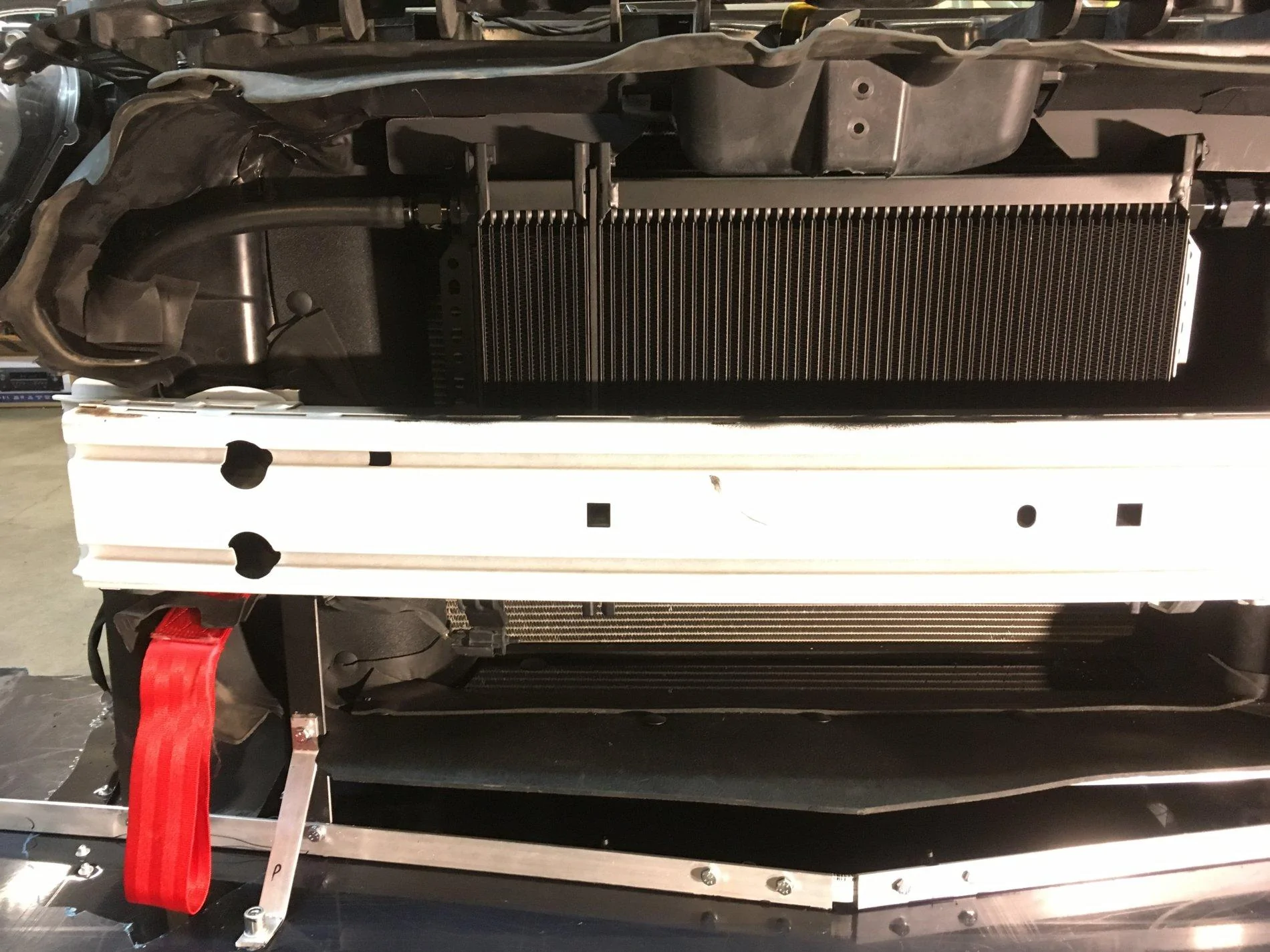

My 2018 Mustang GT experienced excessive oil temperature at a PCA HPDE event, which put the car in a reduced power mode. The oil temp was right at the green/yellow line on the electronic gauge. Anyone experience this issue? Moreover, I found that Mishimoto makes a bolt up oil cooler kit, but only for the 15-17 GT. Will not fit the new grill on the 18's and 19's. Any advice would be appreciated.
There are a couple of upgrades you should do first, the PP Rad will help since the oil cooler is tied to the Engine coolant, more efficient radiator will buy you more time. The oil cooler itself on the GT is good for about a 15-20min session if the car is driven very hard with the PP radiator in place. I am not a fan of the Mishi cooler unless you are going to use it in parallel with the OEM cooler. On its own it is barely enough to compensate for the removal of the OEM cooler. If you take the front fascia off its a good idea to take the time to seal all of the ducting in front of the radiator to force all of the air to go through the radiator and prevent any of it from spilling around the radiator. Hood vents are also a helpful item but require a bigger commitment to the track since it is a more permanent mod that can not be undone.
Another simple but less fun thing to do is to shift at 6800-7000 rpm and avoid high RPM shifts as this is were are large amount of heat is generated with not a lot of return for the extra 400-500 RPM. If you car is tuned, tell your tuner you are having temp related issues, often the tuner will try for every whp in the tune at the expense of building excessive heat in the heads and exhaust. Its better to give up a few whp for a cooler running engine.
I am in STL as well so if you want to see my setup in person or you need help sourcing parts let me know and I will see what I can do to help.
