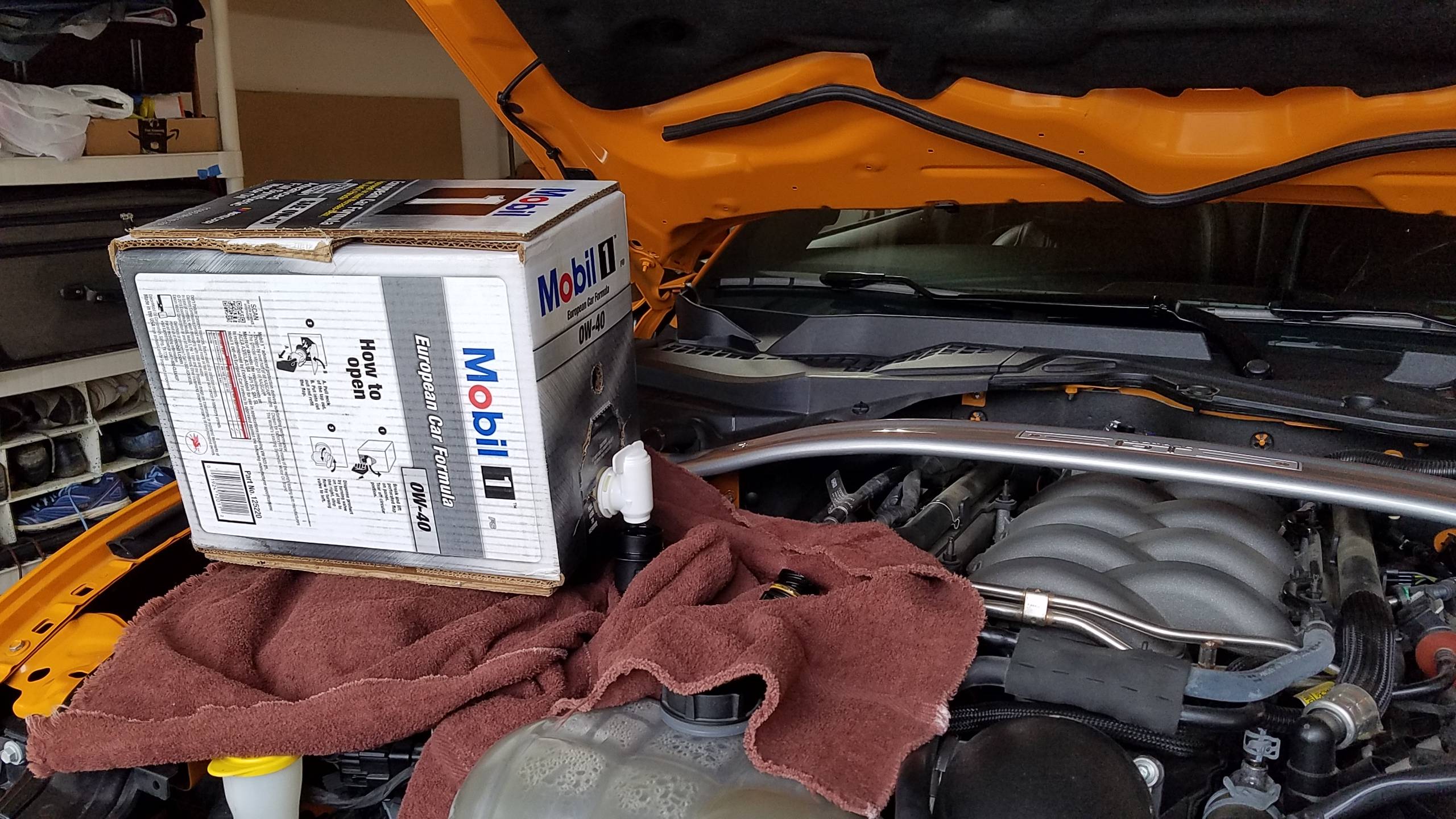

No, the auxiliary oil cooler was what was needed to lower CHT from 250+ to 235-240 220. I'm running 40w because track temp is still higher than street temp.
EDIT: Corrected CHT. @*****
Also, axle steady at 220F with DIY cooler, and A10 steady at 205 with 2nd OEM trans cooler.
The box oil can be put straight into the fill tube!
