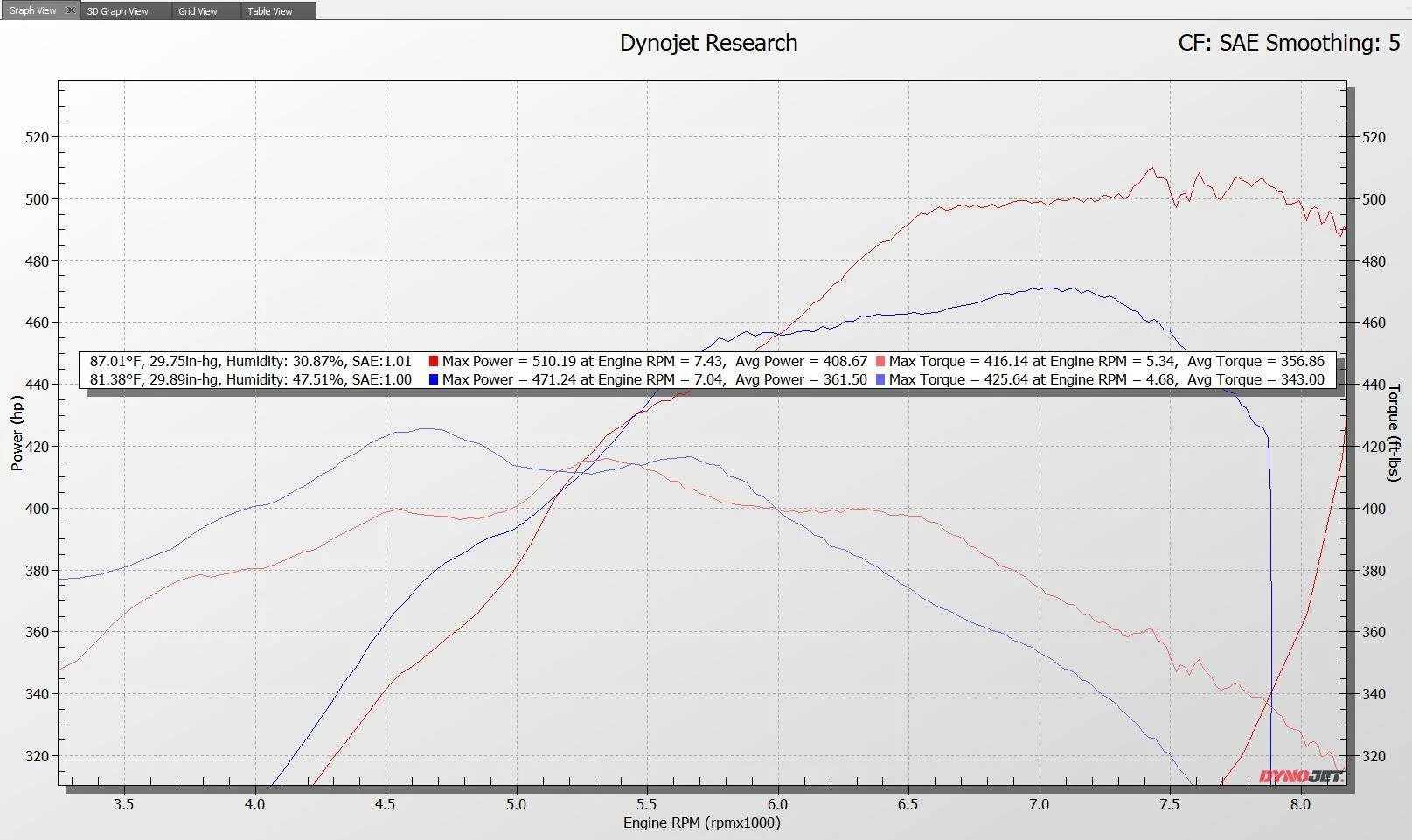

Several reports indicate the Holley may be as good as a ported CJ. My results show that when comparing to other results. I hassled through all the connections... it's manageable. No tapping new threads or anything like that, more figuring out a ton of fittings and a couple of AN hoses (rear crossover, main feed) I made 510 rwhp SAE. (Full exhaust, Comp camps, Holley, about 76% tested E85. 2022 car, A10. Dyno was wonky at the top (suspension or tire slip) in 7th so did all the tuning in 6th where it was smooth. Did the last pull in 7th to get the official SAE number. Holds power pretty good to 8000. And stock 87mm bullet TB, no oval or twin blades required... I think I have a hair left in the tune and some hp when I a 90-95mm round TB is available. (the round holley throat is 93mm but I opened it to 95mm) The blue is a non-cams/Holley run. Oh, also, I did valve springs, chain and tensioner upgrades and an electric water pump.

Holly dyno on a stock 21. Kinda weird result. Power was strong on 93 and torque seems especially strong. But it got it all done at a low rpm relatively: could be a great combination….or just the effects of dyno’ing in a tall gear like 7th.
