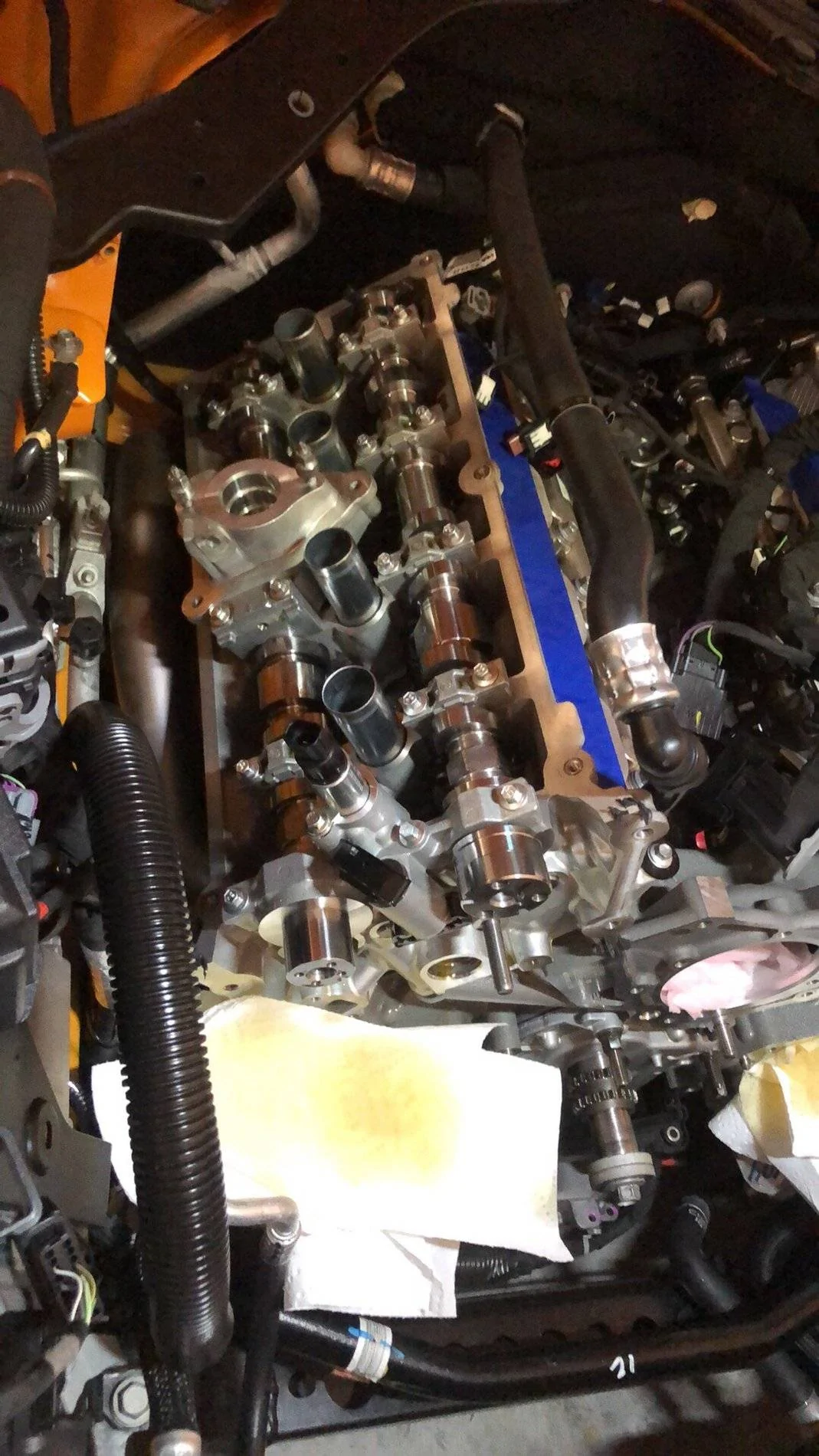

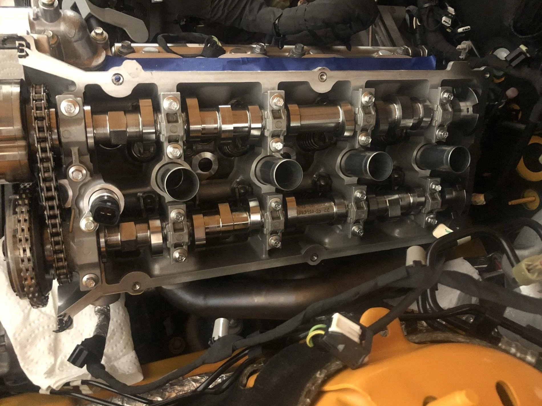

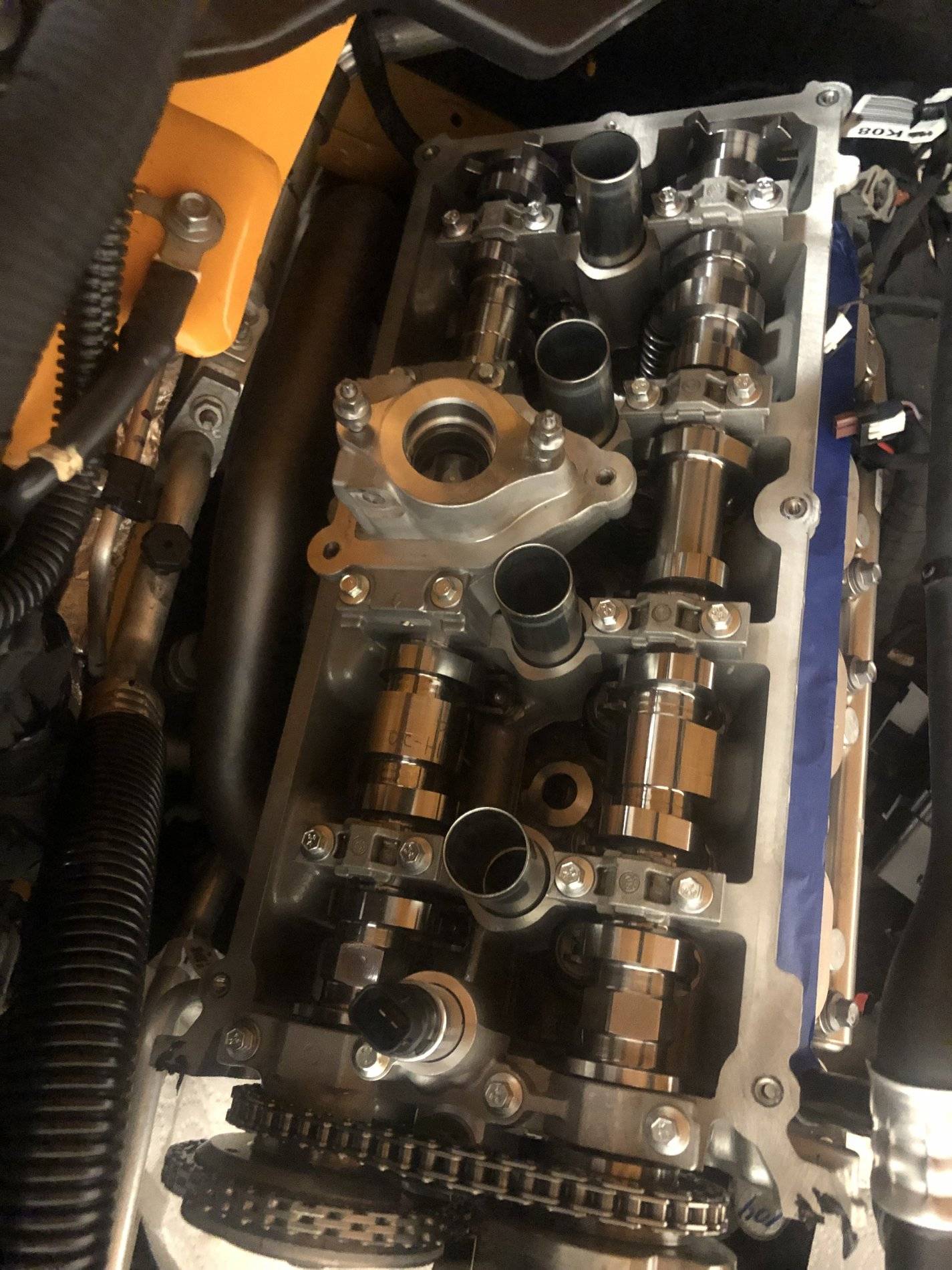

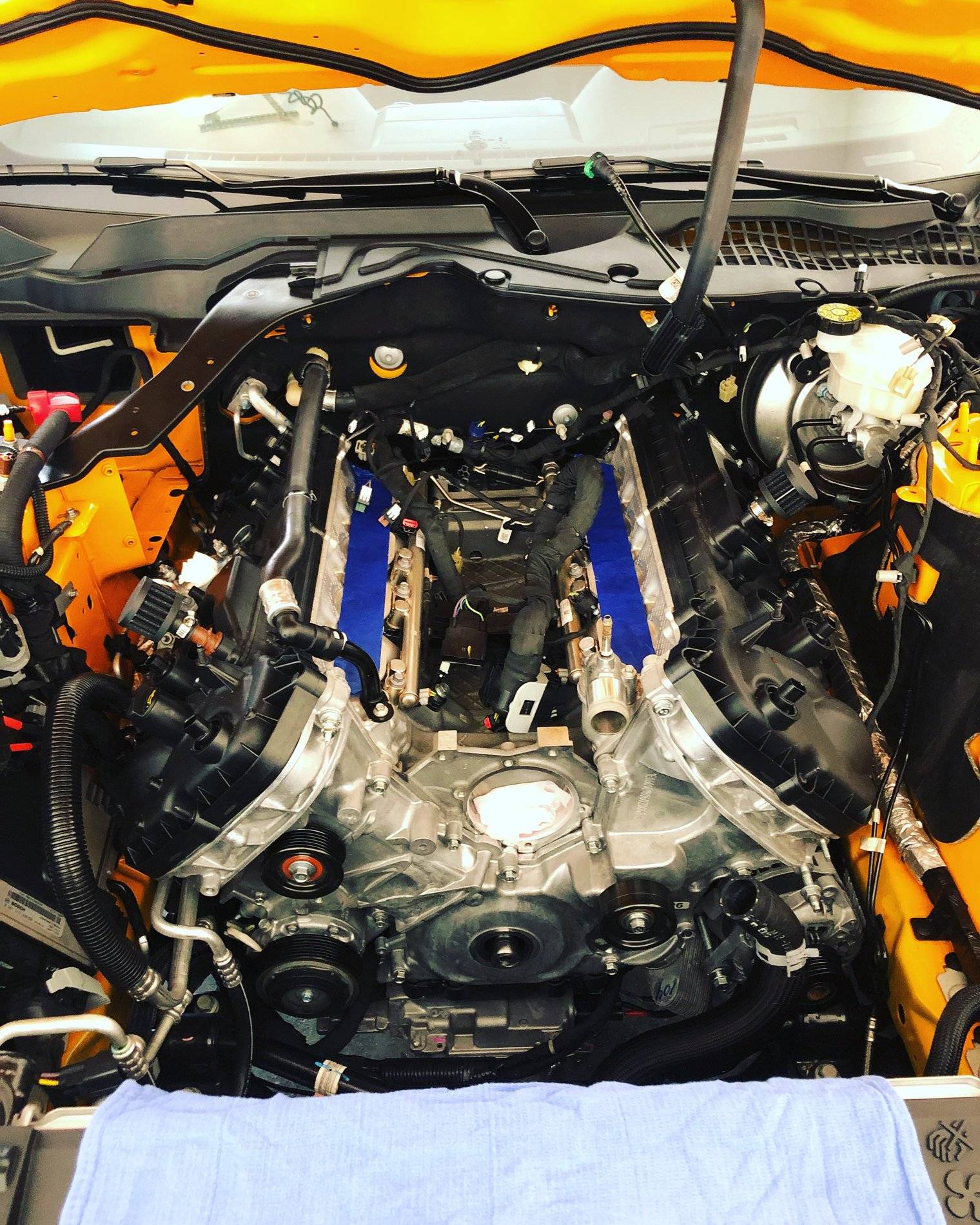

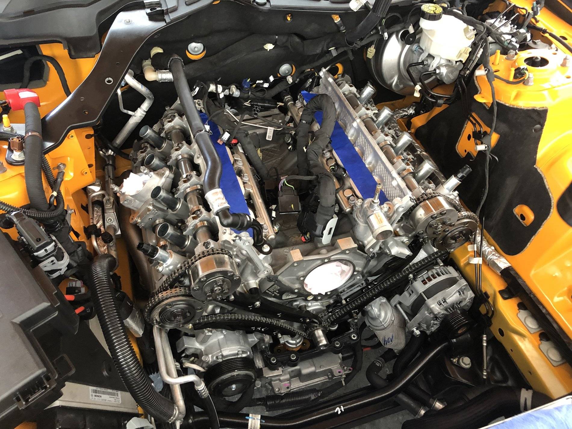

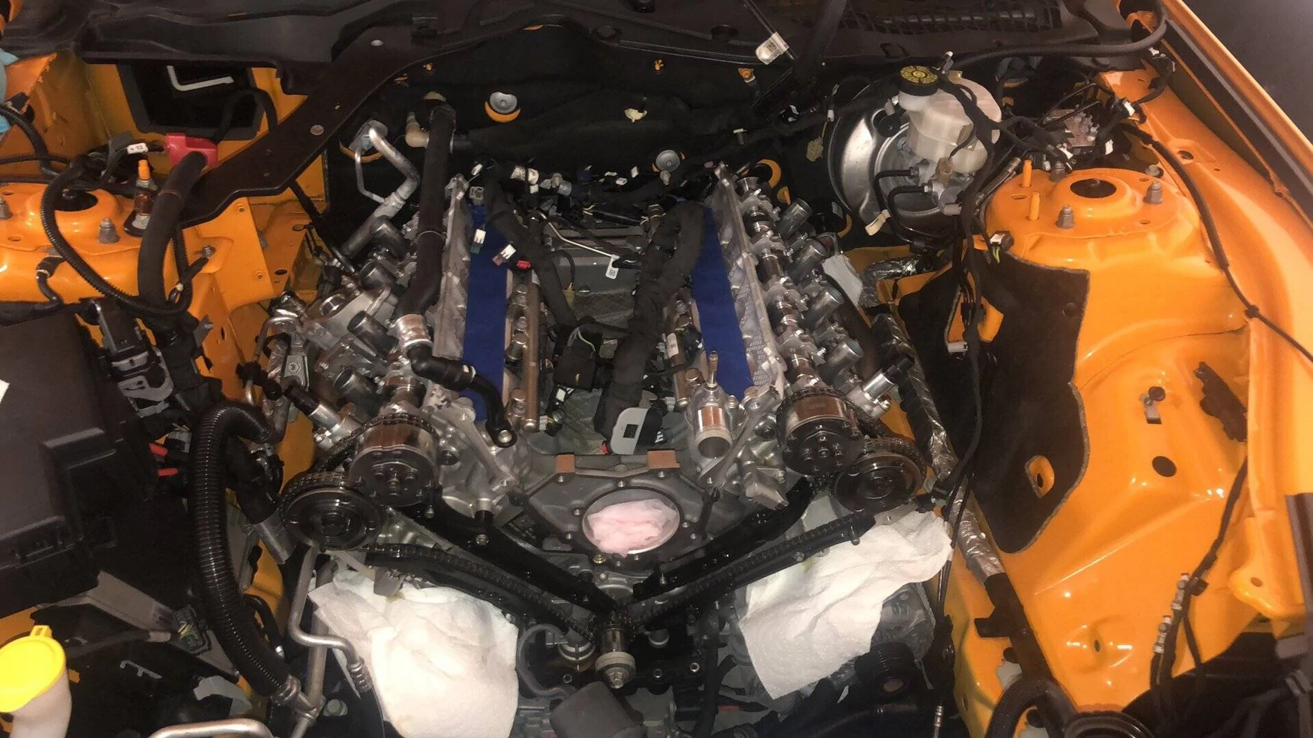

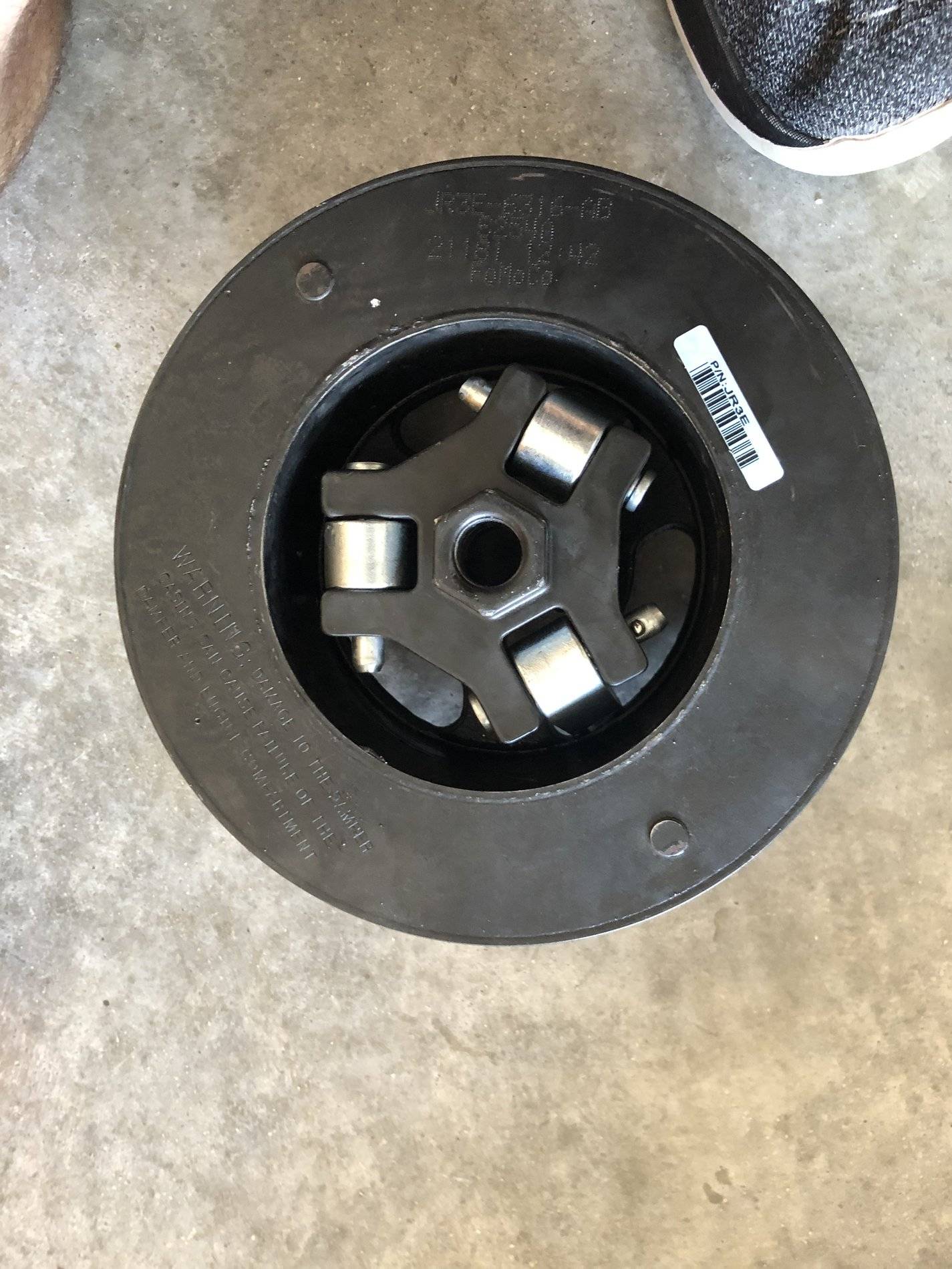

So yesterday I finished my install and initial logs for the comp cams stage 2’s. Install was straight forward and actually pretty easy to me. Pleased I was able to get it done myself with the assistance of a friend to hold the cams while I torqued the VCT bolts. Car fired right up with Lund jr’s base file. Already have done full pulls to 8200rpm and it feels great! MAF reading show a decent pick up in air flow over stock cams. Will be hitting the dyno later this upcoming week.
Here are some photos of the install.
