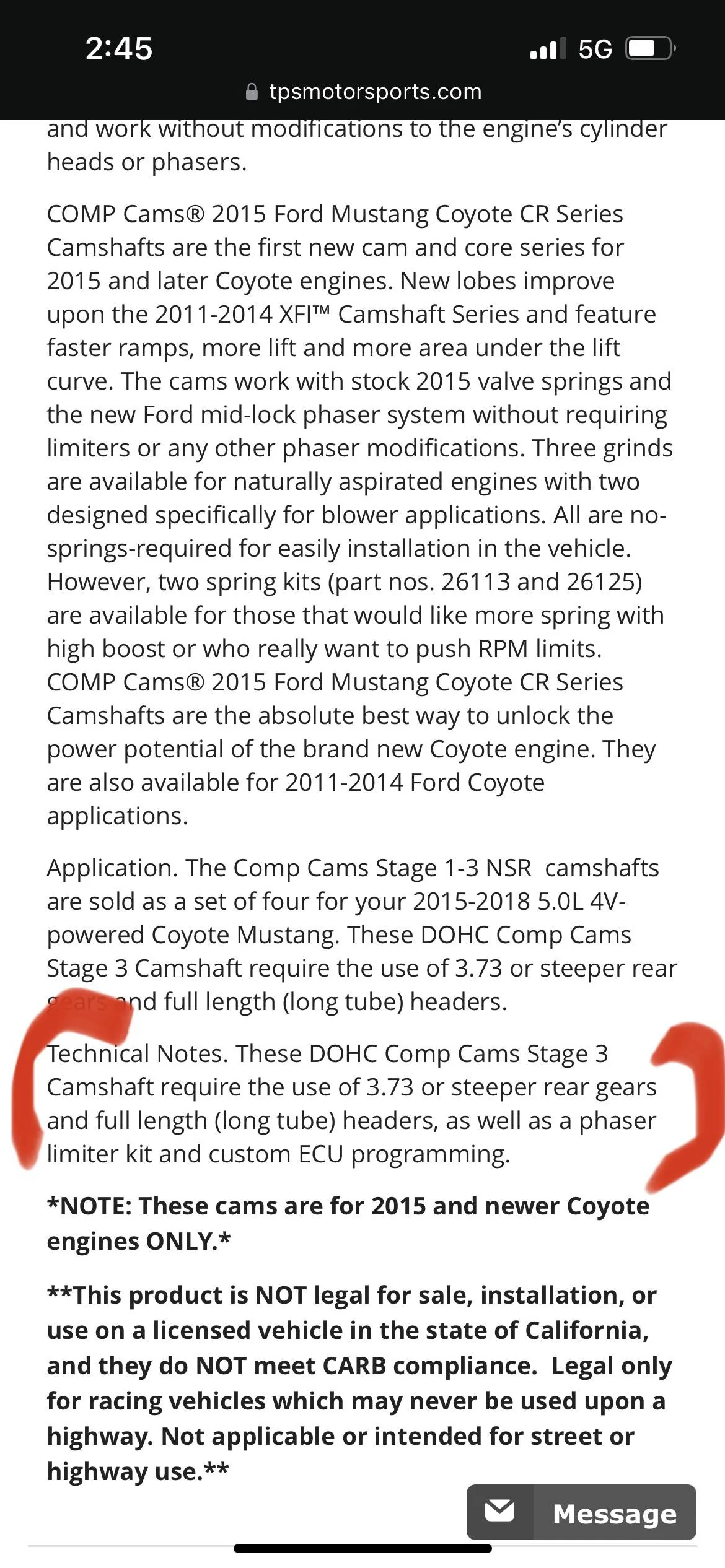

Ahh man I hope I don’t get killed for resurrecting this but just trying to do my due research.
Do Comp stage 3 CR NSR N/A cams require limiters on a Gen 2? Mixed info out there.
Was a tune ever developed for blower cams on N/A build (if you’re planning on forced induction say later)?
Trying to decide between stage 2 & 3 comp cams for my N/A Gen 2 build.

What I meant to ask is do I need VCT phaser limiters with comp stage 3 cams? I understand they don’t need springs.
as it says, the stage 3 will need the limiters, due to the size of the cam

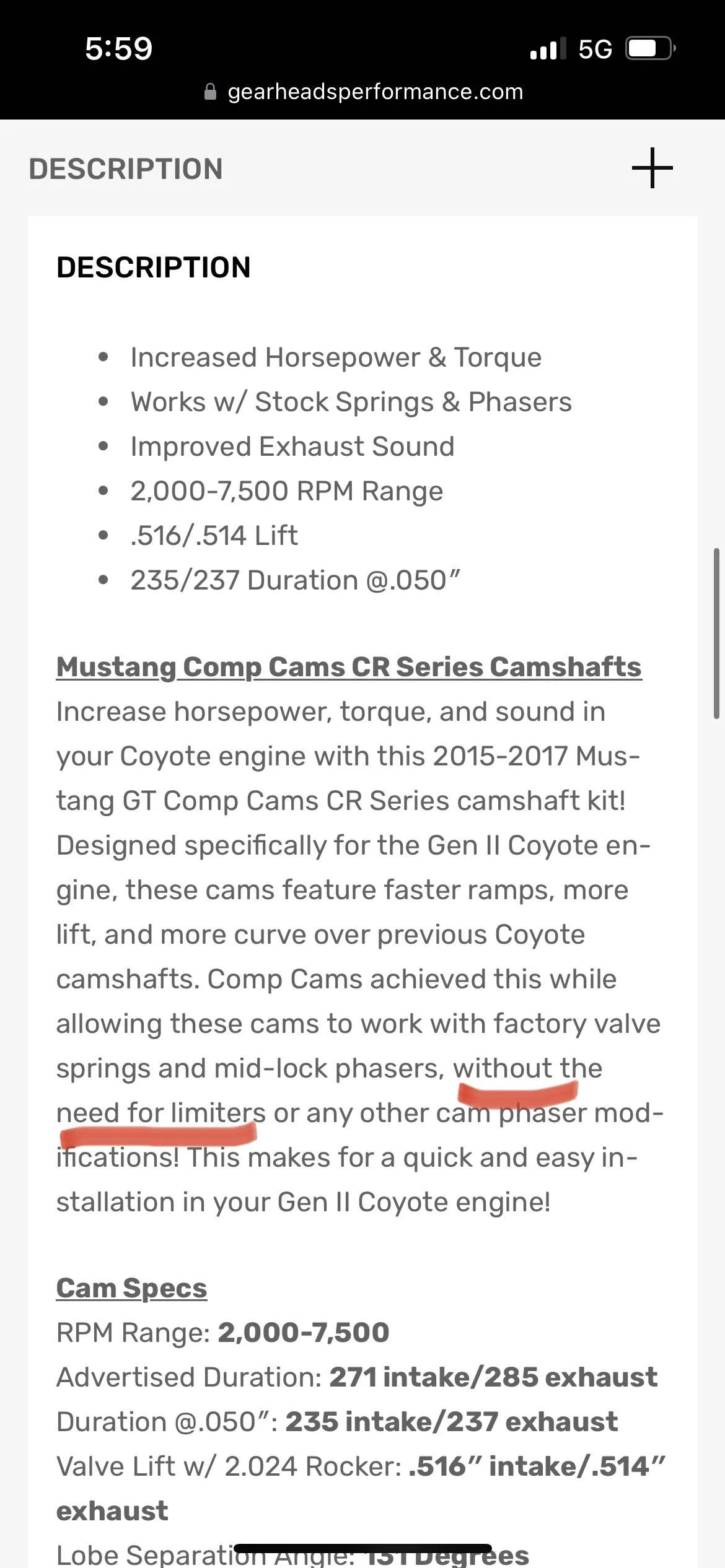

You know I appreciate your candor. I’m actually very literate FYI. Here is another source saying they do not hence why I came to the forums. Thank you for the expertise.
You do not need limiters. You can keep full vct function. I recommend springs and retainers but it’s also not required.
If you are for sure going boost soon just keep stock cams. The stage 3 N/A push your rpm band really high to where you don’t make power till 5k rpm.

I didn't see you weren't pulling the info from Comps website, Per comp, there info does not say any limiters are needed.
