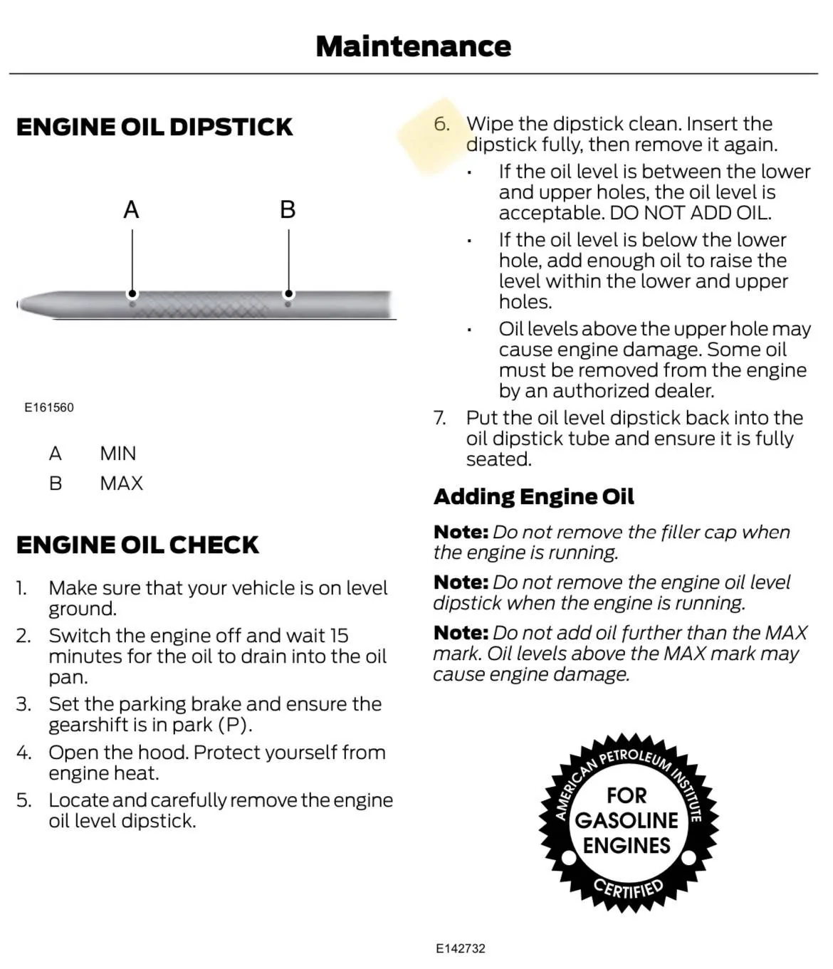

If the level of oil is at or just below the bottom of the hatched area of the dipstick, is it safe to drive (in a moderate fashion, not track)?

The R engine is different from the standard GT3550 until 2019 when Ford decided to use one engine. This is well established here
Im sure its fine to drive it slightly below the hatched area but Im not sure why you would.

Ford says 500 miles per quart is acceptable.

Keep a quart or two on hand incase you run into this situation. Add oil as needed.
From the Owner's manual:
From the GT350 Basics sticky:
  • According to the March 2017 Shelby Supplement pg. 48, oil consumption of "approximately 1 quart per 500 miles"while "driving high performance vehicles in such a way that might lead to higher oil consumption (this includes extended time at high engine speeds, high loads, engine braking, hard cornering maneuvers and track use."
