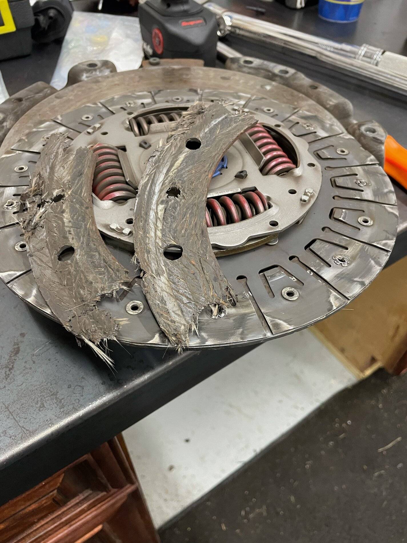

Just to give an update, been out of town with military.
Clutch was fried. My mechanic friend initially replaced the clutch pedal cylinder thinking it might fix the problem, which it didn’t. He finally pulled the tranny and discovered that it was indeed the clutch.
Replaced it with the McLeod, and all the other parts I bought. Got the car back yesterday and i got a yellow wrench pop up When I started the car for the first time. I have no idea what to do now. Car seems to drive fine.
New clutch is very light on the pedal feel. Not sure he installed the shifter right as now it is noisy/ feels loose when I shift, like it is loose around the reverse collar under the leather boot.
Any suggestions on what to do next?

Most likely the wrench light is because you need to perform the ‘crank relearn’ procedure since the clutch was replaced. Local ford dealer can help, or if you’re tuned talk to your tuner as most tuning devices have that capability.
