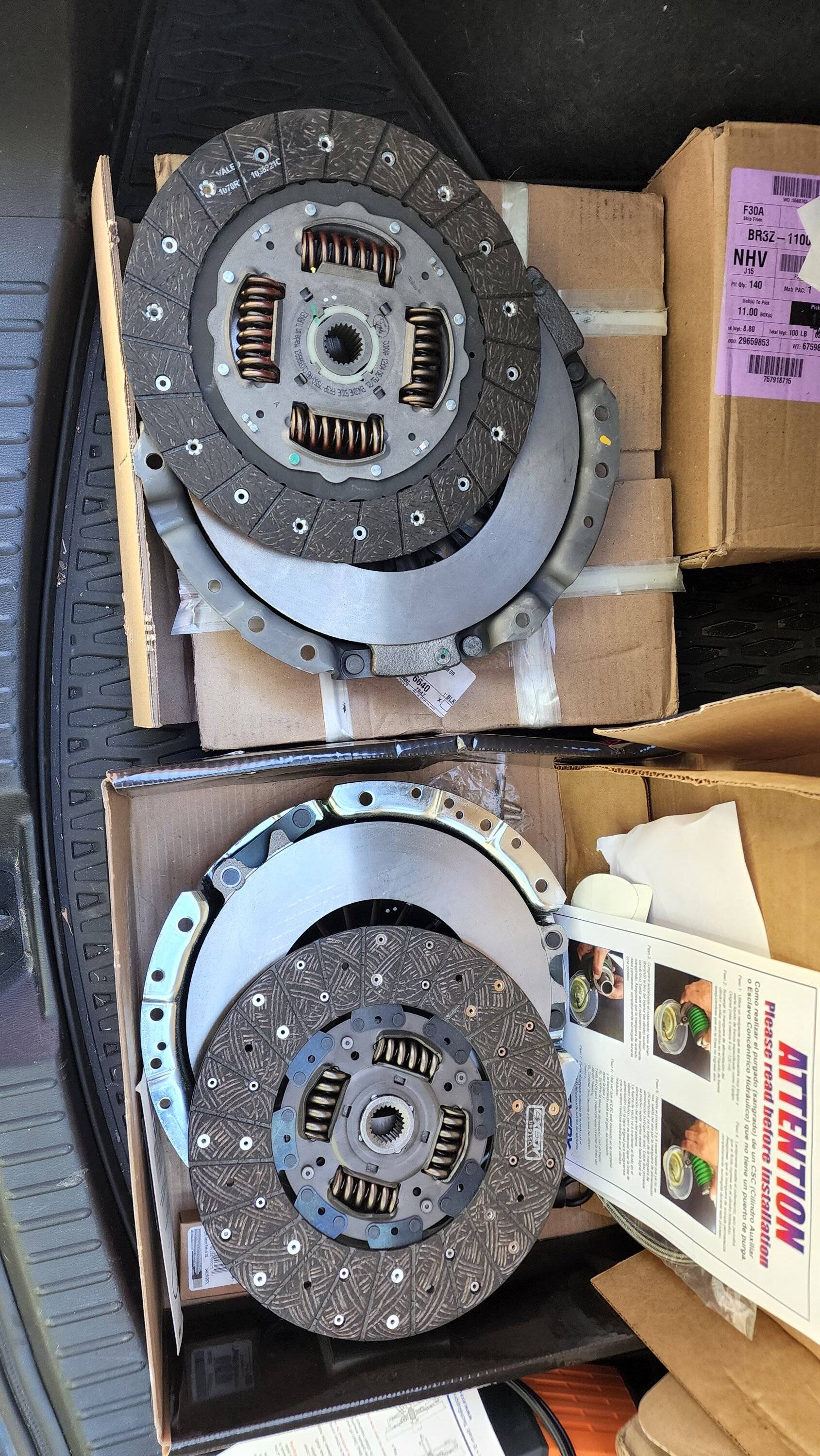

Try the Exedy Mach 500 with OEM flywheel. I should have gone with this when the original clutch went out April 2021 on the 2016 GT. I replaced it with OEM friction disc and pressure plate. The OEM friction disc grenaded on me while on track a few weeks ago. After some research, it appears the OEM friction disc is genuine crap, and is known to spontaneously fail, and is also the cause of many high rpm lockout issues in the S197s. I cant speak for longevity onnthe Mach 500 yet, but my clutch pedal finally has feel to it in my 2016 GT with it. Never had a decent clutch feel with the OEM units.
Here's the OEM unit (top) compared to the Mach 500 (bottom). Note the thicker band of friction material on the exedy, along with lack of the center plastic bushing ring that the OEM friction disc has (suspect to be high rpm lockout culprit).
