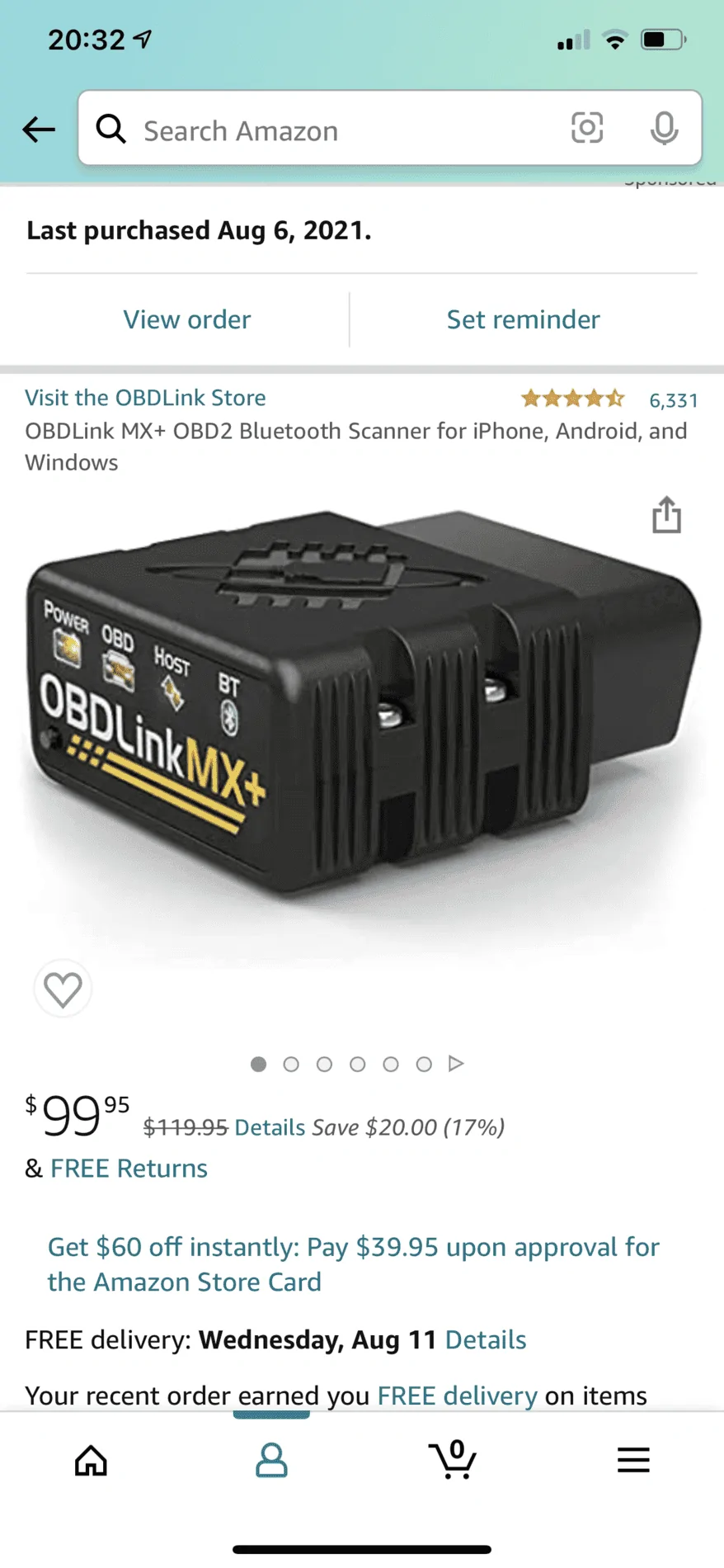

I bought one of these and FORScan lite app. Hopefully this might do it?

Hope normally isn’t a viable decision, but, hopefully that new reader will shed some light on why the wrench is still on. Makes me paranoid to drive the car because I don’t want to screw anything else up.

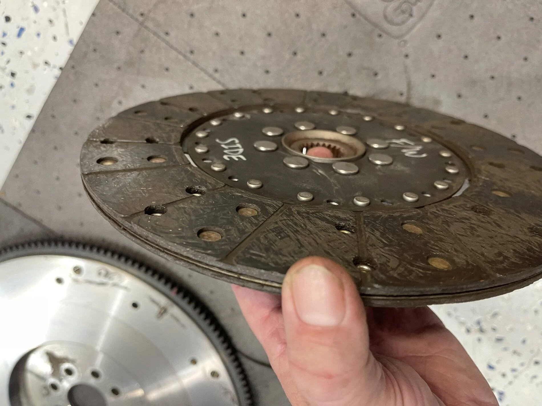

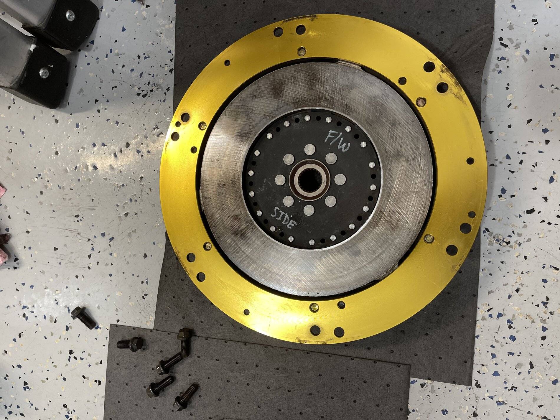

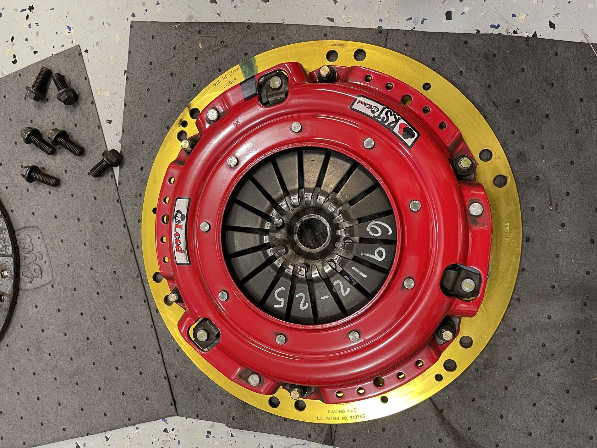

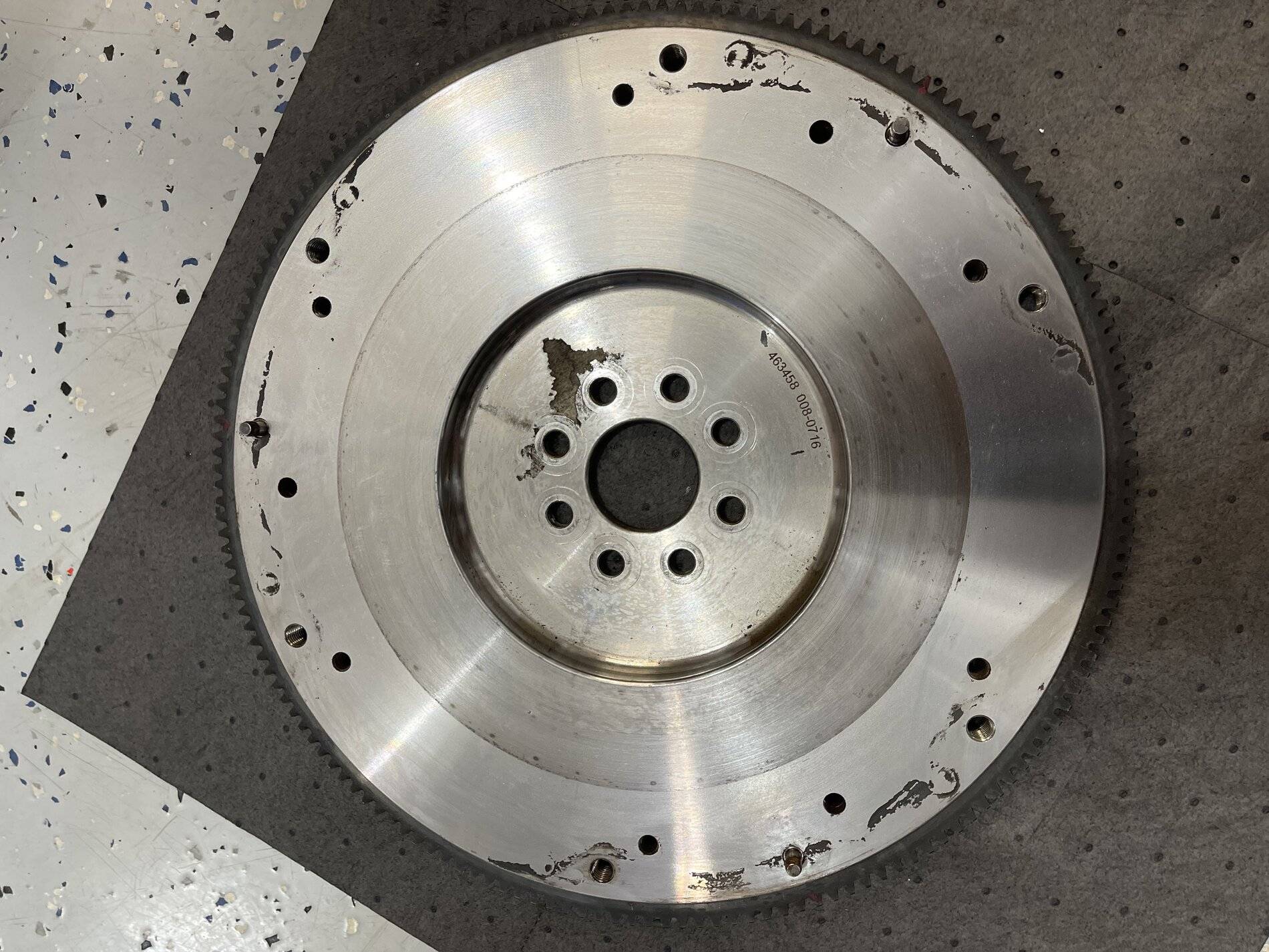

I’ve got a lightly used RST I just pulled from my car with flywheel. Shows zero wear. Pm if interested.
