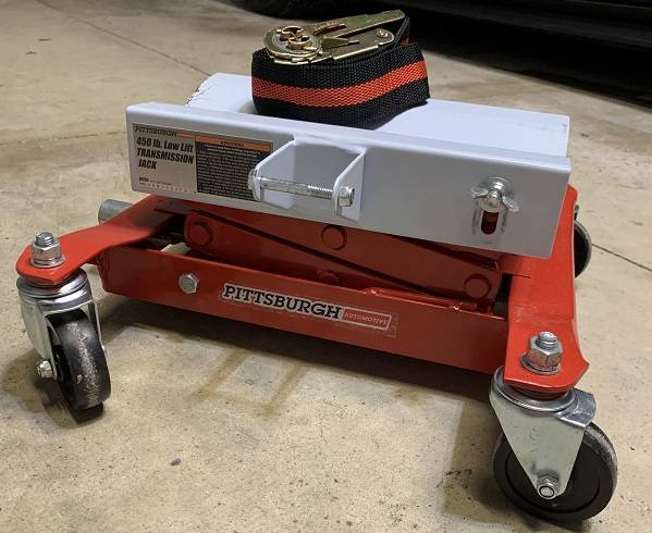

I did the clutch on jack stands and took my time. Went smoother than I thought. I would highly recommend getting a transmission jack. It definitely made the job easier.
