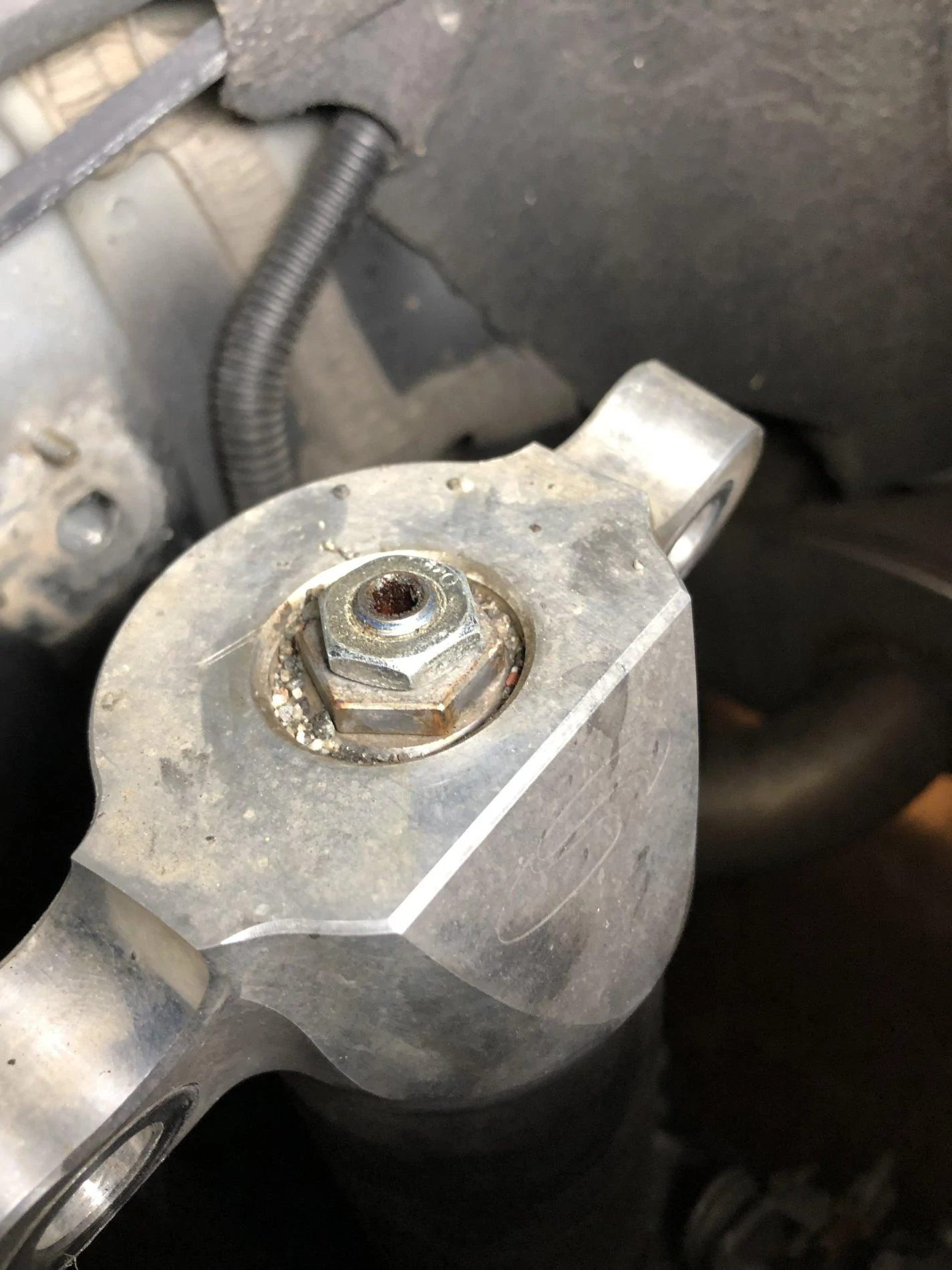

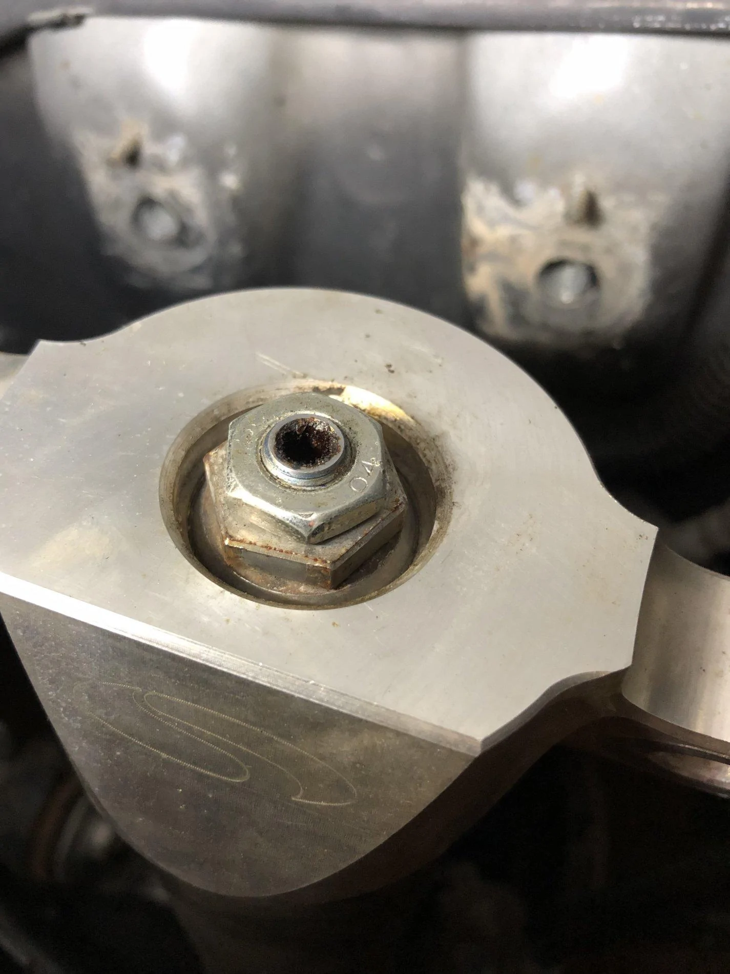

I had to get my passenger side Steeda shock mount replaced at one point, the new one has been great. Now I believe my drivers side one might have failed? I have new OEM mounts and nuts I’m going to install tomorrow to see if it helps.

Just pulled the wheel off and have started to poke around. Steeda Mount appears A-ok. No rattles or play. The bearing is smooth and feels tight. I will leave that alone and keep looking.
That being said It was full of dirt and debris, which I always wonder if that might bind the system up and cause some noises here and there.
The dust caps on these are pretty much pointless. All paint pen bolts are still snug. Axle-nut is snug. Gonna maybe mount a GoPro and go for a drive.
