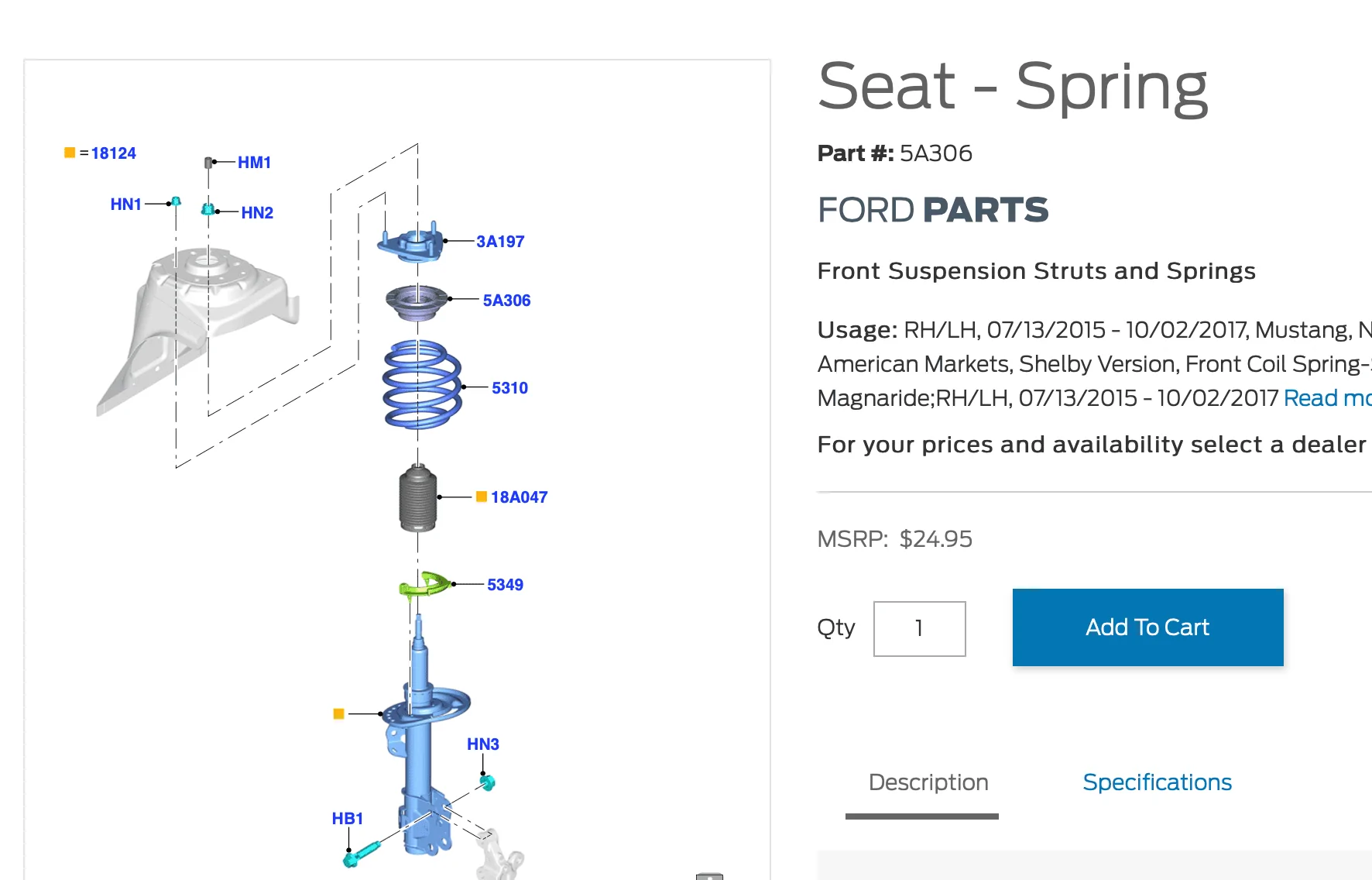

In my case, it was the spring isolators. Those covers that go over the springs themselves. It's important to have them oriented properly. I can't recall now exactly how I had them wrong initially. The guy on here from Steeda is very cool and will help you out. He works for Steeda.

Is the spring isolator that you are referring to Ford Part #: 5A306? I'll call Steeda. I'll try speak to Mike D because last time I had issues with their parts, I got someone who wasn't really helpful.
