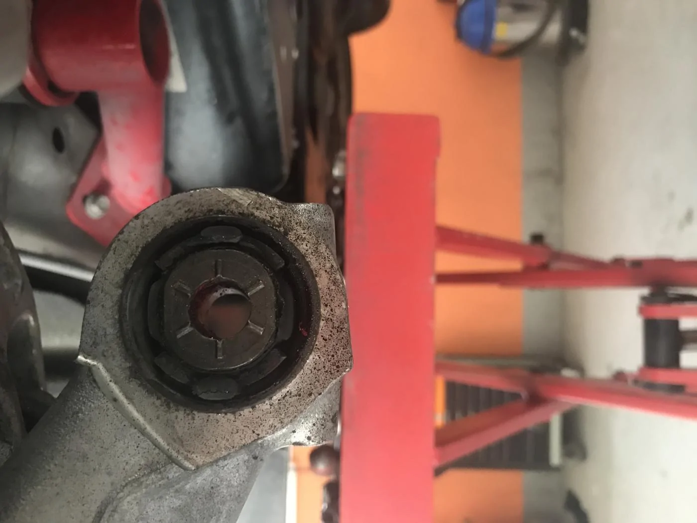

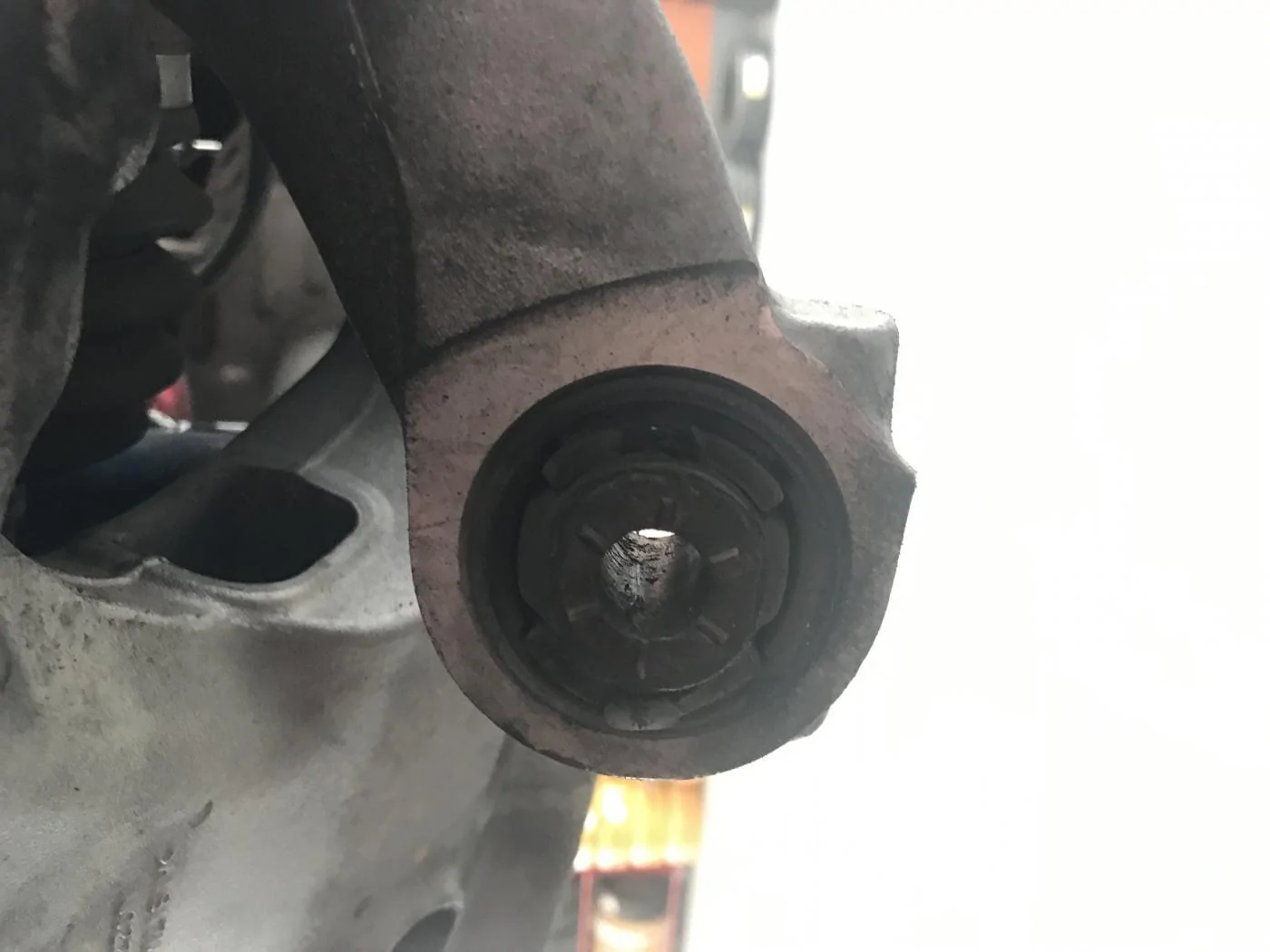

I took off the toe rods & the pic is attached. I got the work done outside & am working with another garage so not sure if its the frpp bearing thats attached or stock. Any advise?

I'm no expert but that looks like a stock one to me.
