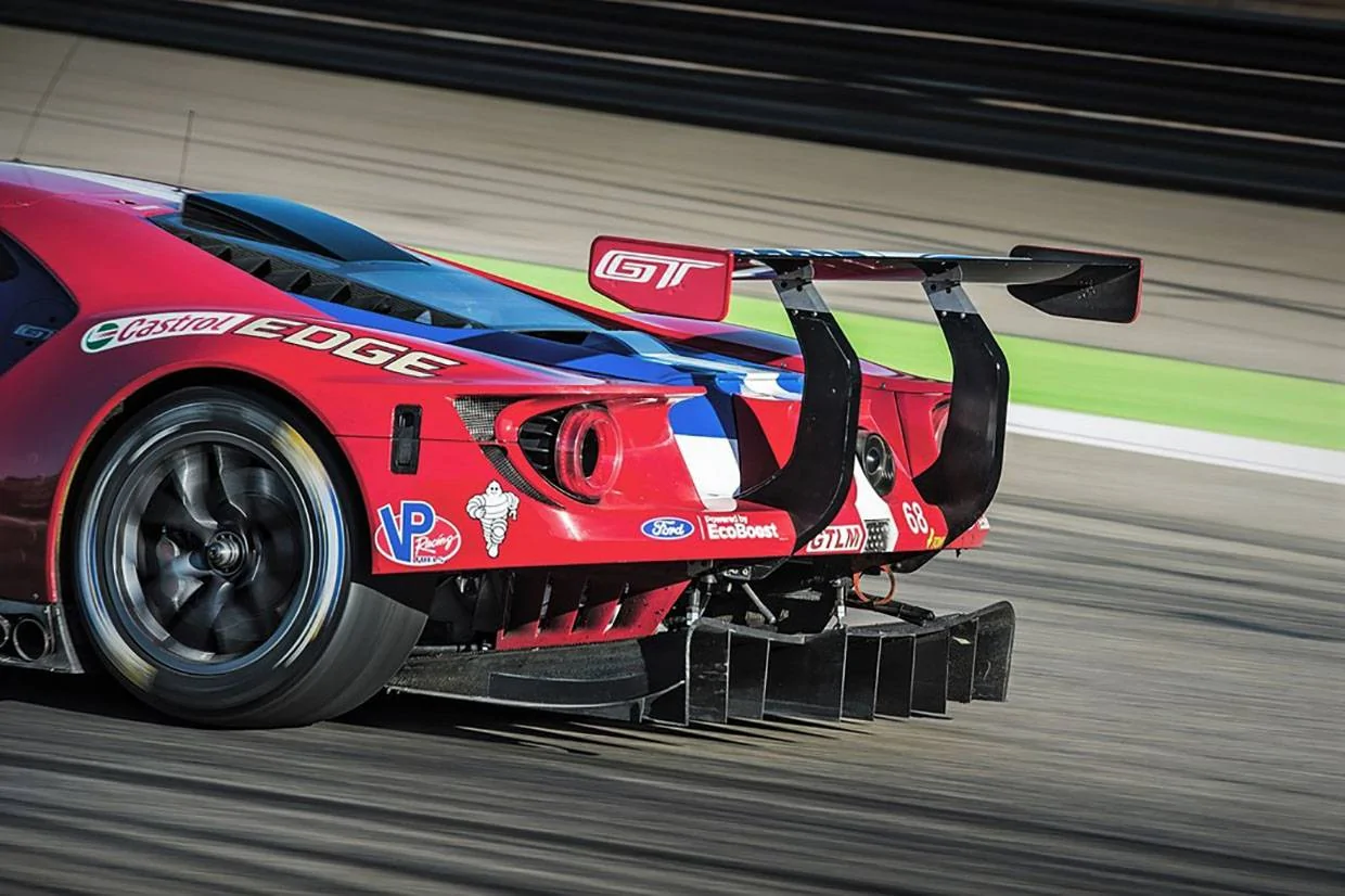

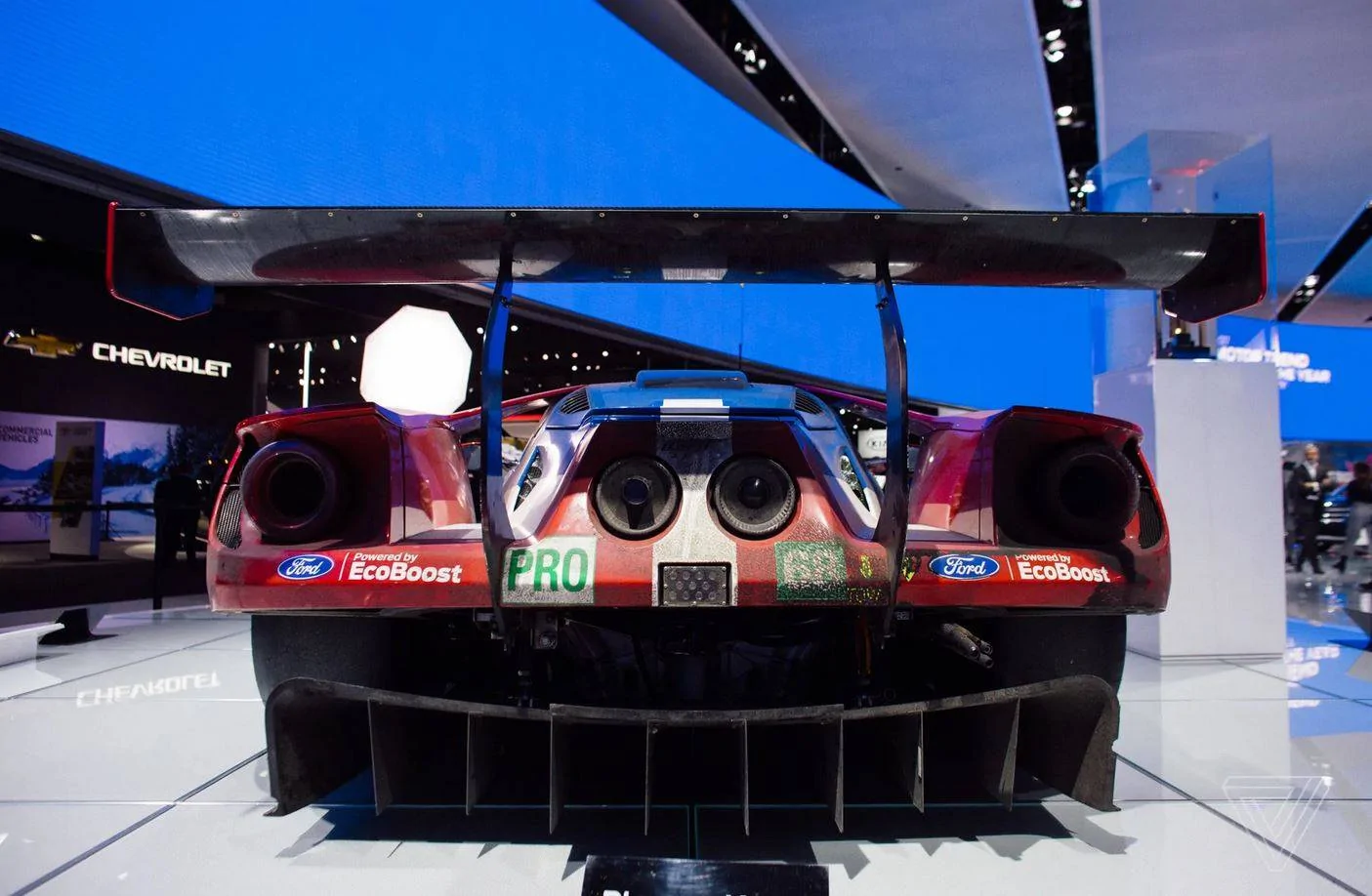

Verus produces a little over 800 lbs at 15 degrees AOA at 180 mph.
The CFTP falls between 5 and 6 degrees and hits the 550 lb mark. I'm curious where it would be if you tripled the AOA.
Bigsy said:
Wow. That’s more than I thought. It’s really an out of the box machine.
Ford/Multimatic spent a lot of time on the aero for the race version of the Ford GT and its fixed wing. The basic airfoil shape from that is what made it to the CFTP. That's pretty impressive.
effective lift would decrease and drag would increase. I'm sure the track angle that they came up with was based upon lots of testing.

I'd bet that Tom is correct when it comes to the AOA settings and I'd also bet that tripling the AOA would kill the DF and increase the form drag substantially. Tob's correct, Ford didn't just stick that thing on the car, they did their homework.
Evolvd
Instigator
Jan 19, 2015
186
6,882
5,898
Northwest Florida
Brian
2021 Shelby GT500
Agreed. The wing is just that, a wing. Increase AOA too much and you stall the wing effectively making it a giant air brake.
