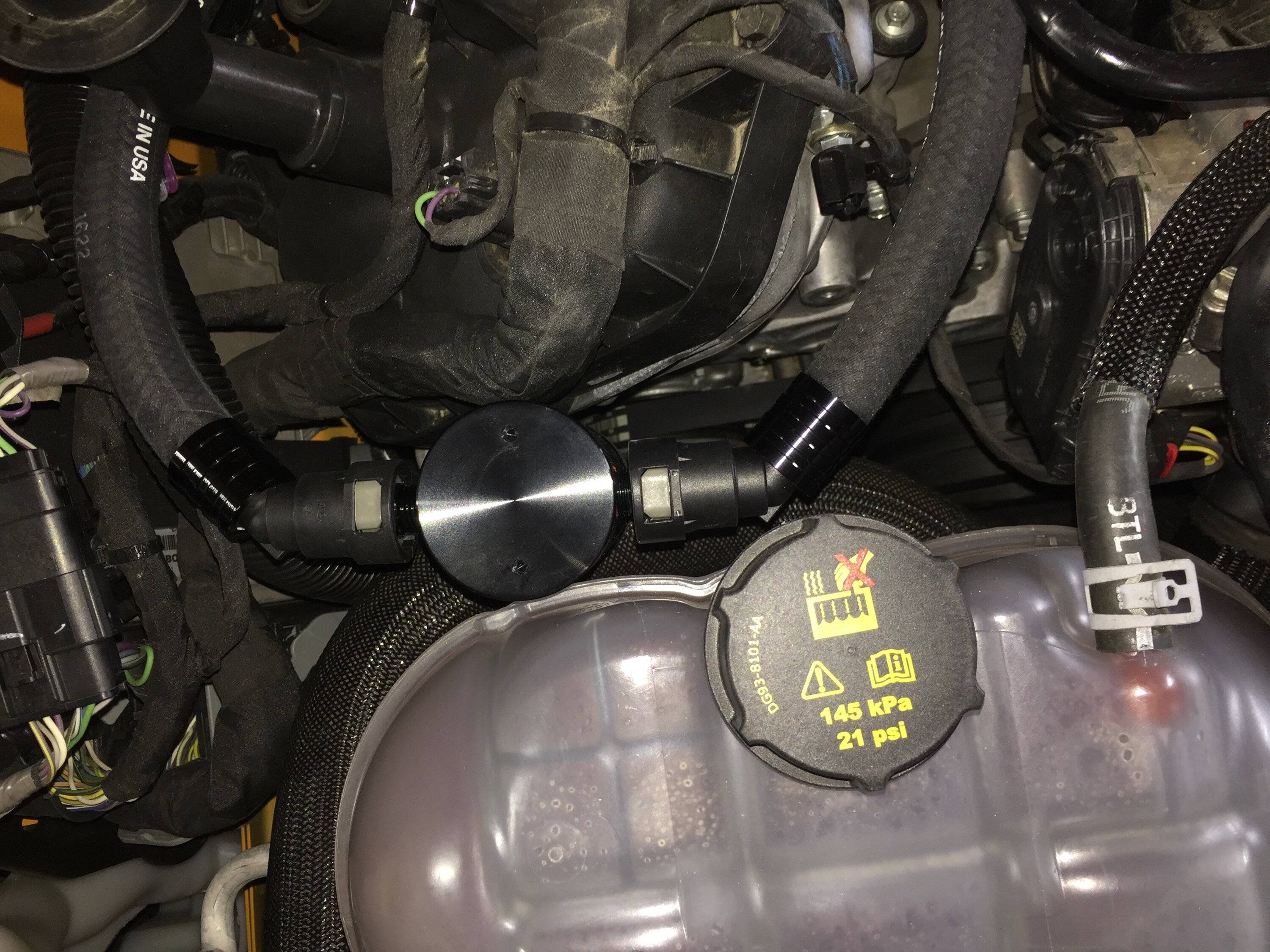

This OP. I have the one you linked on my non-boosted 21 for the passenger side. Quick, easy install. I get a few teaspoons worth of oil every 5,000 miles

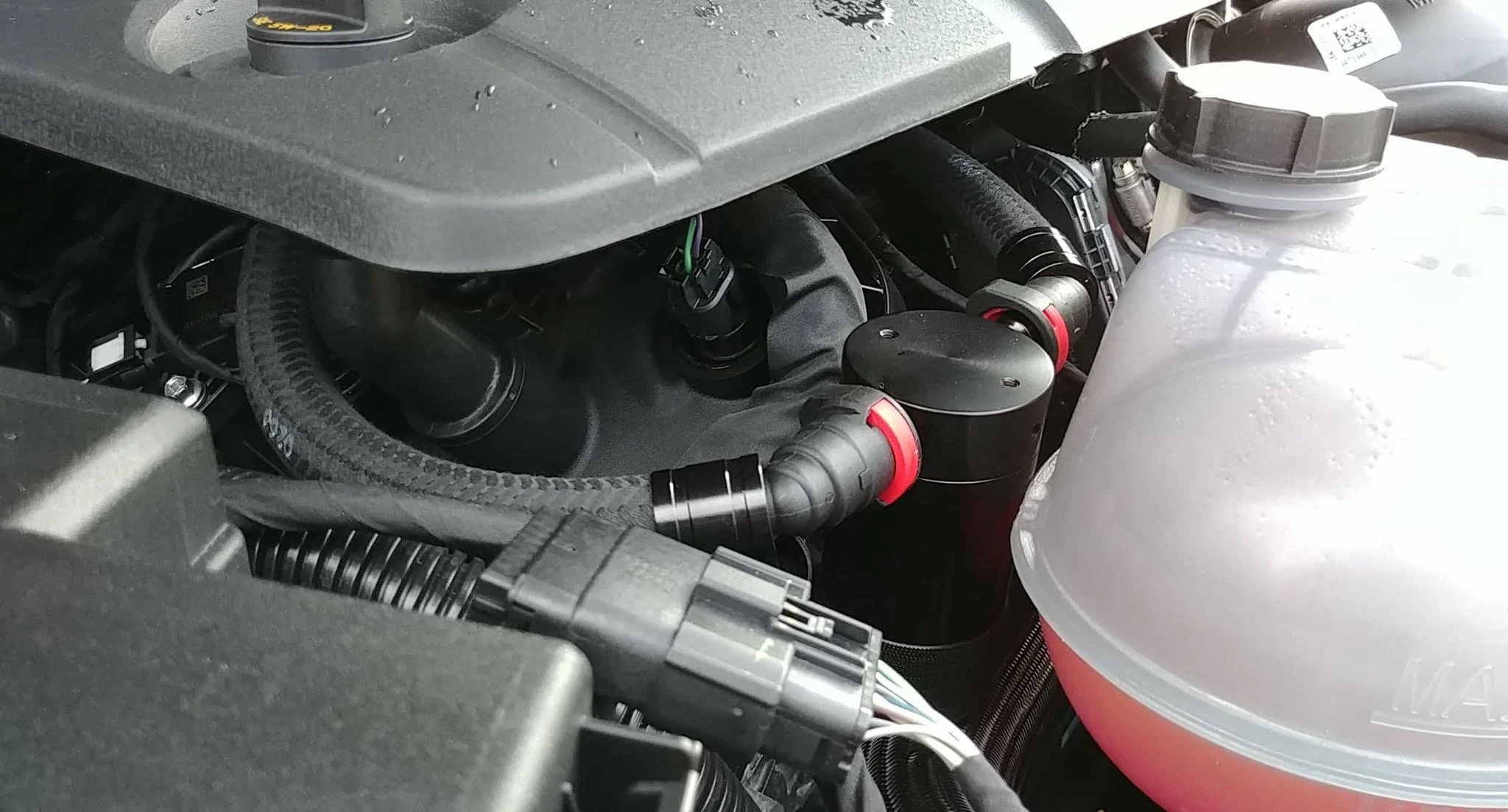

First mod was UPR catch can. Have also heard passenger side for N/A and both sides for boosted applications.

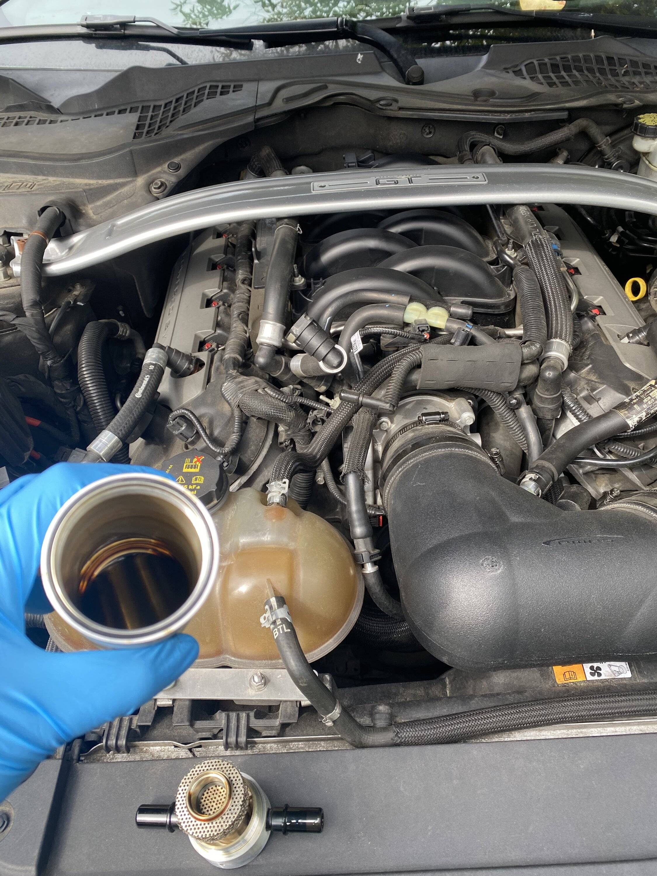

From what I see the ford brand separator is $250 and uses plastic for the catch can and tubing. UPR materials are higher quality and mine was $160.
The plastic actually has a purpose though, it provides better insulation from heat given the location in the engine bay. Catch cans operate better in a certain temperature range. When I had my UPR one that mounted next to the radiator, it would run cool enough to catch way more water and fuel than oil. My FP can only caught oil.
With that said, my car hates catch cans and none of the ones I've tried have fit quite right. I might try the UPR one that hangs in the location the FP one uses.
