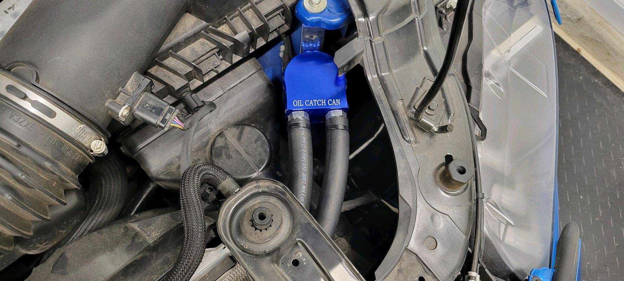

I've only ever built my own catch can systems from cheap ebay/Amazon baffled cans. The one I currently have has ss wool as the baffle media and works very well. So well in fact that over the winter on e85 I neglected to check it as often as I should have and it nearly completely filled with water after only a couple months. I used -10an fuel hose to route the lines to a mounting point away from engine heat as the catch cans purpose is to condense blow by gases and oil Vapor so keeping the can and baffling as cool as possible is key.
