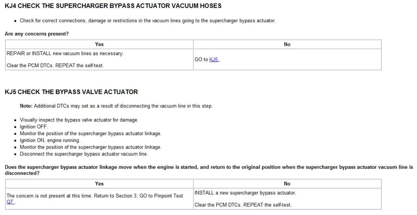

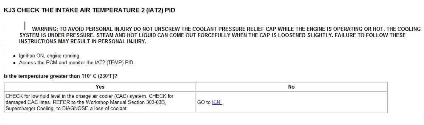

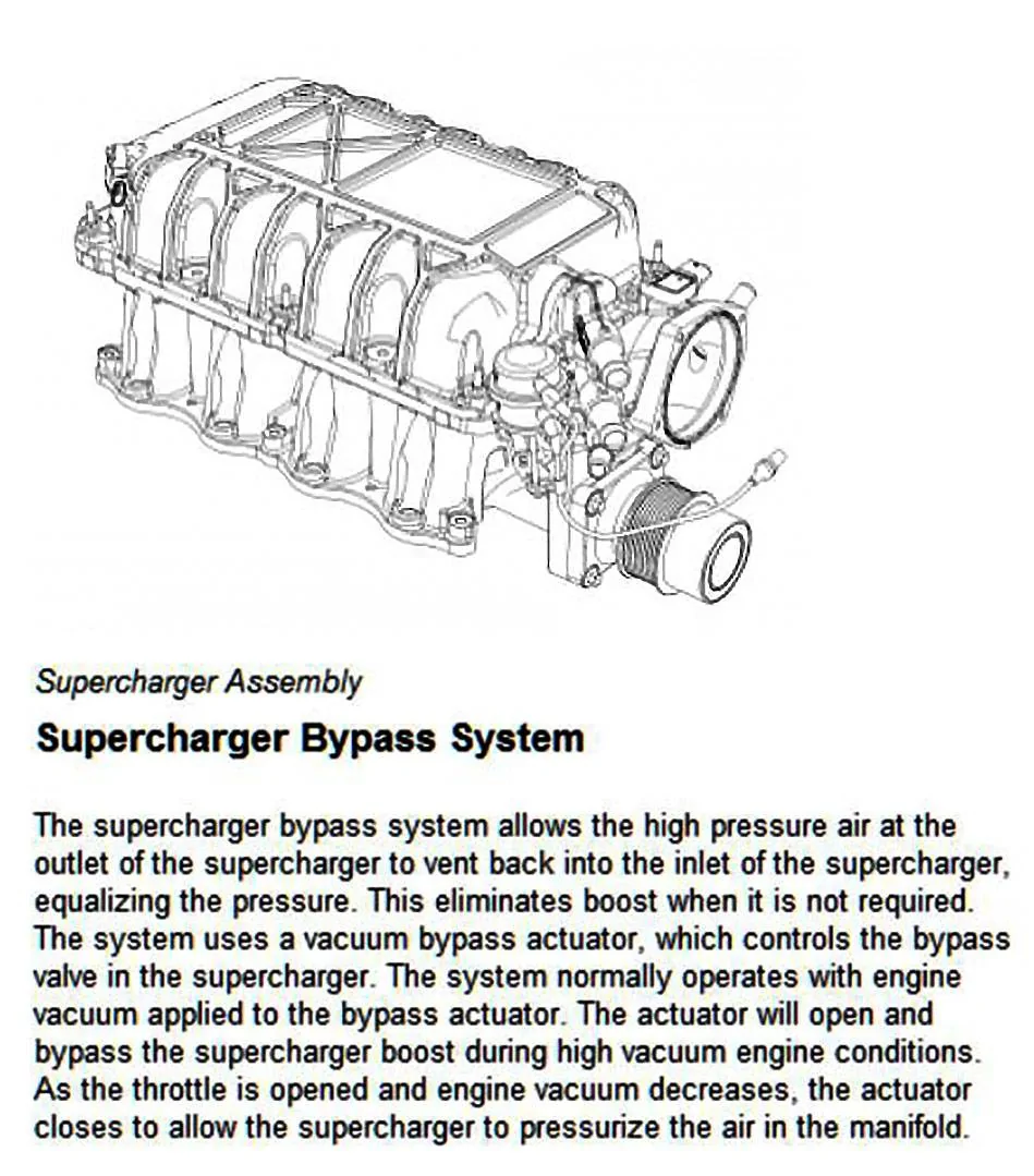

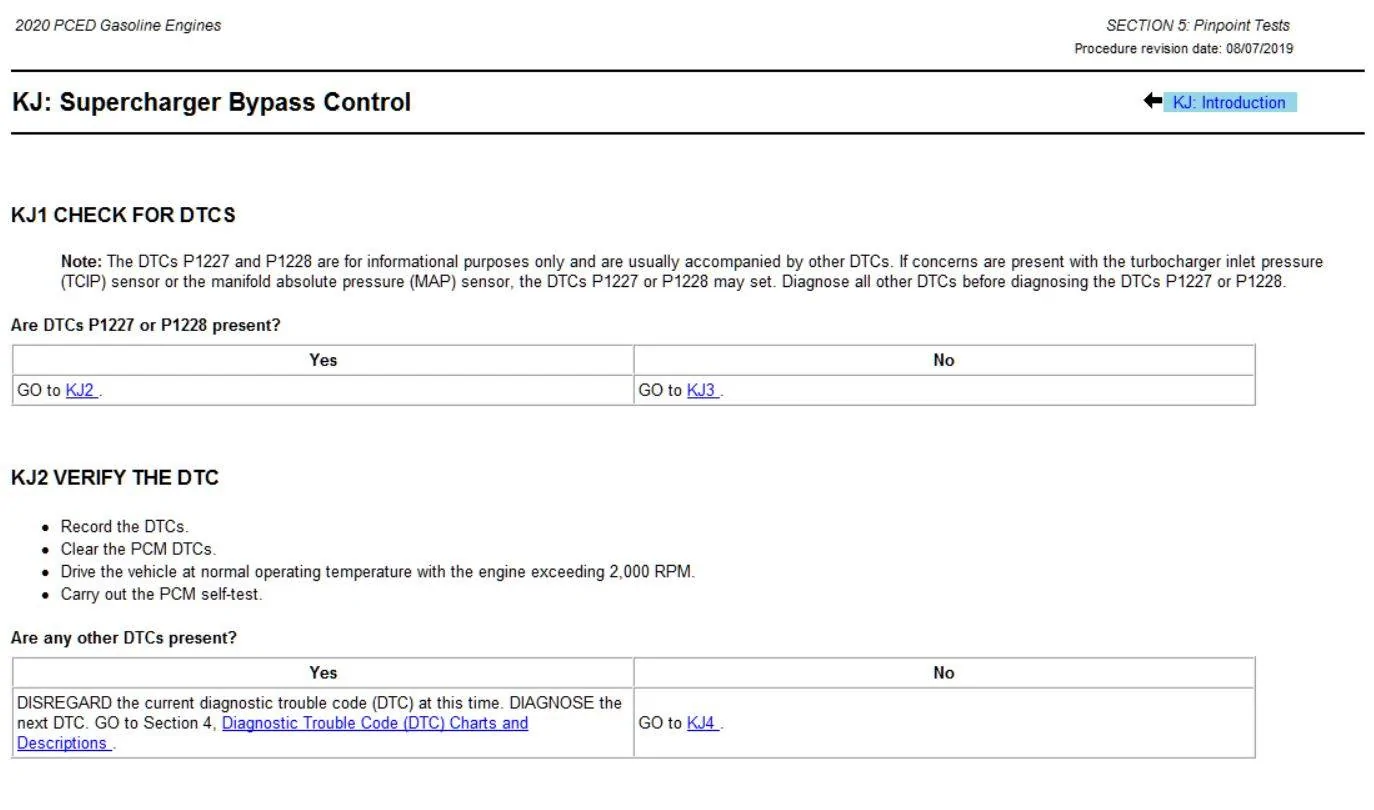

Some fodder if you want to educate yourself about it and take the bull by the horns. From the component description section in the factory manual...
The relevant pinpoint tests from the Powertrain Control/Emissions Diagnosis section...
Maybe the most relevant tests that you may want to check as these are pretty easy
You can do a simple check to see if the actuator rod is bound up as well as a check with a vacuum gauge. You may find that if you run the plunger up and down a few times that all is good - you never know. If checking with a vacuum gauge, you can see from this snippet of Justin at VMP's video what the position of the valve would be...
If you couldn't get through to Kong/Jokerz I would definitely call Justin at VMP and talk to them about it. If you still can't get anywhere you could try Whipple as well.
I just got through Jokerz and they said they have actuators in stock but said to get it checked first, so they referred me to Coastal Dyno over here in Florida. Both Jokerz and Coastal said they doubt this is an actuator issue and that the dealerships talking outta their ass. Going to take her there tomorrow to get diagnosed, fingers crossed!

You should be able to check out the actuator with a MityVac or vacuum gauge, everything is out in the open and easy to access. You can check for vacuum from the engine, a ruptured diaphragm in the actuator and disconnected or seized linkage. It shouldn't take more than 5 minutes.
