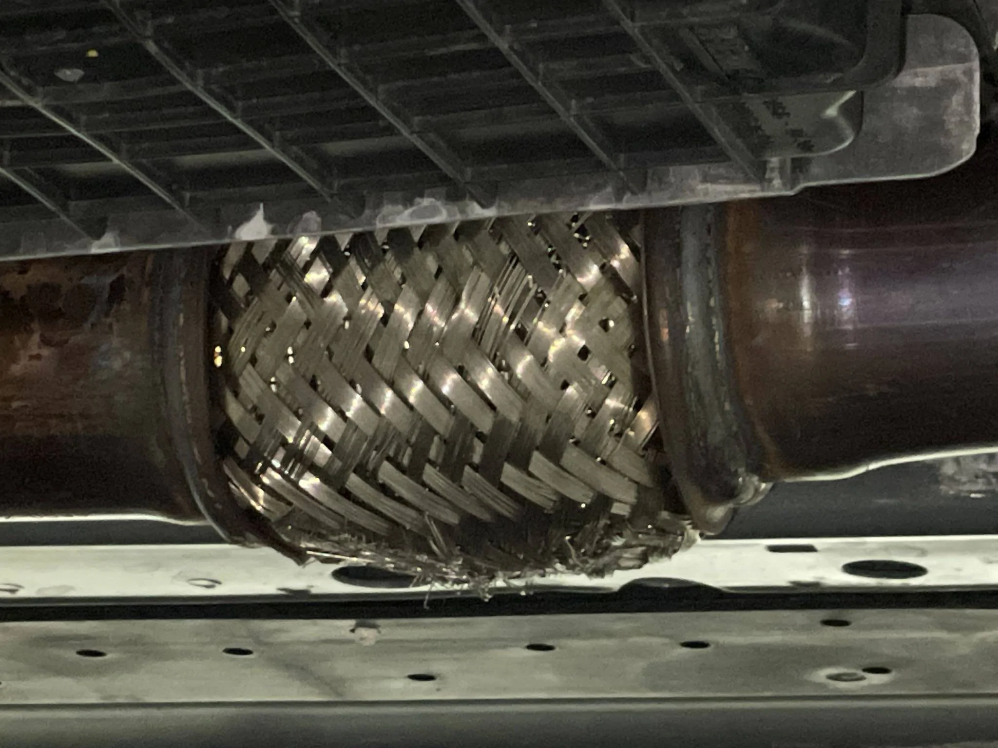

Can this be repaired or time to buy new?

Is it leaking/blow by?

Car is totalled. I'll take it off your hands, $50 bucks cool?
Just kidding. Honestly I wouldn't even bother replacing it unless it starts coming apart completely. Unless it's leaking.

I have both of my stock pipes if you’re interested in one. 15K miles, but in excellent condition. Let me know and I can send pics.

The braid actually sometimes covers up an accordion section underneath like this. So if you don't feel any exhaust leaking, it is not functionally broken. I'd replace it with an oem (used) section in the long term, or just switch to headers :sunglasses:

Thanks! Good info. I don't expect any leaking. I will take a look. I don't think i can go straight headers in Virginia. thinking about picking these up, but needs stud work.
