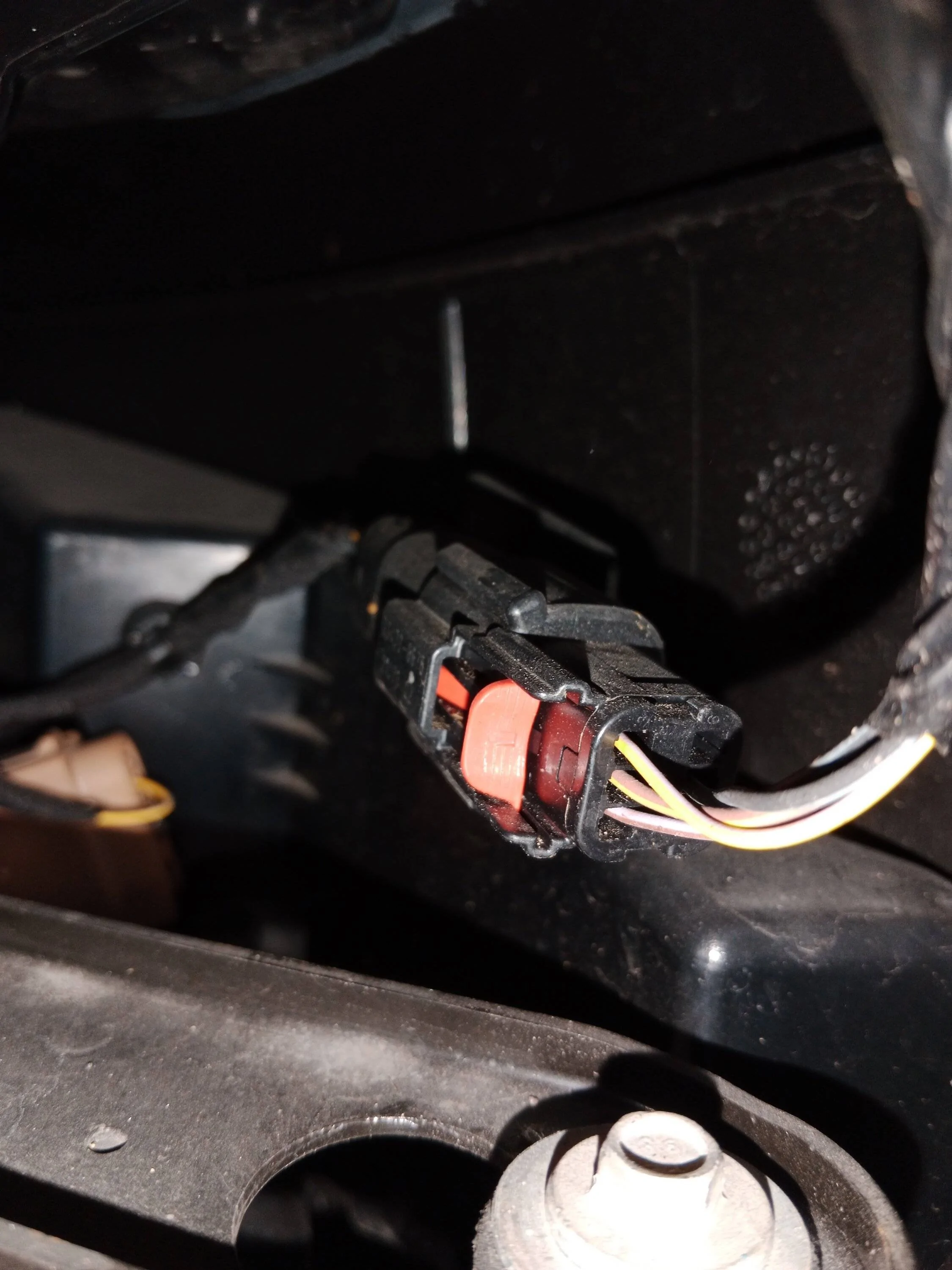

Could anyone tell me, how to loose this type of connector and dont break it?thanks
Looks like the red tab slides up to disengage the connector. Try a flat head screwdriver if you can’t get it with your fingers just go easy so you don’t break the tab

On the connector, the red tab is pulled back and the there is a plastic bridge located just in front of where the red tab was that you press down to release the connector shells. It’s sort of like the red tab is the release so you can press down the latch for the connector shells.

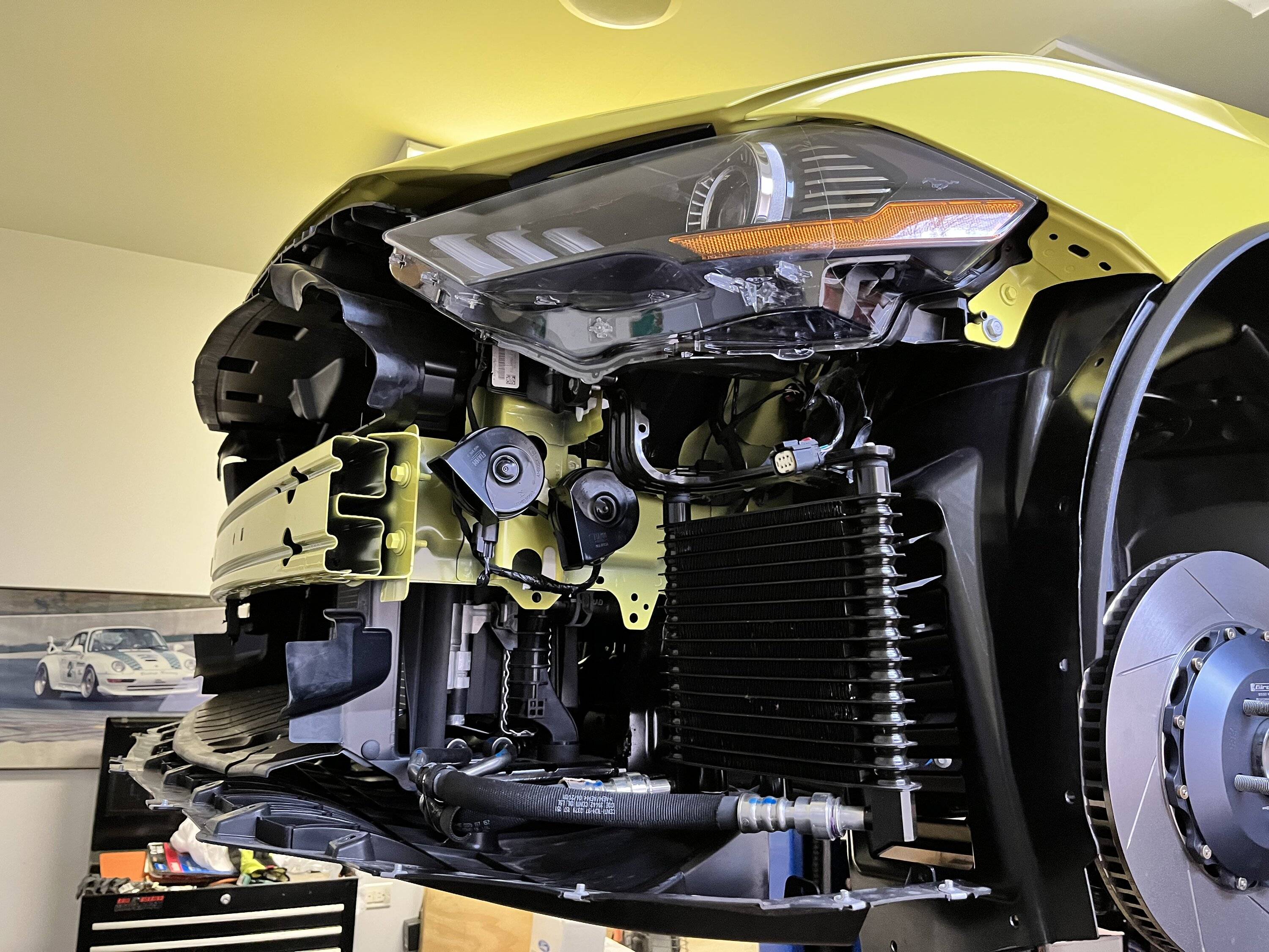

If you have an HP the lower splitter has to be removed or you can take the bumper cover off with the splash shield attached. If you do remove the lower splitter, after removing all of the plastic rivets, I would recommend M5 rivet nuts or well nuts and machine screws on the install in case you need to take the lower splitter off again.
You can easily access the two 10mm nuts on each block that attaches the bumper cover to the fender from the top with a deep socket, universal joint or flexible extension and a longer extension.

I am doing my custom splitter and thats exactly what I am going to do, because I will be using same holes as HP lower splitter. Unplugging connectors is always a terrible pain in the ass for me, but it went off without breaking, thank you

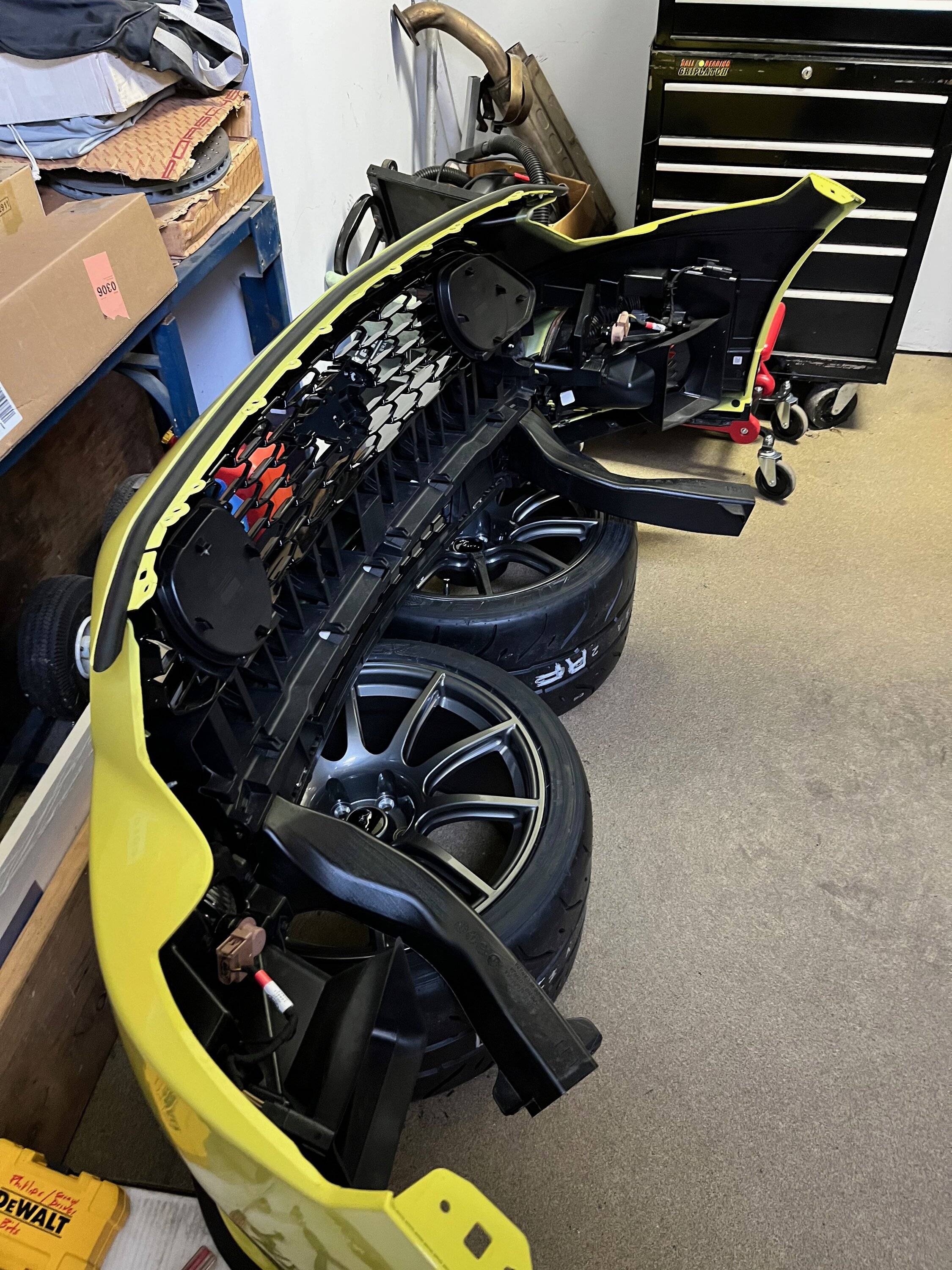

Do you have to remove splitter to remove the bumper? I would think you can leave it attached?
I didn't remove the splitter when I pulled my bumper cover off. The cover and belly pan came off together with no issues and went back together no issues.
Good point! For the HP cars, taking the bumper cover off with the splash shield/belly pan attached avoids all of the plastic rivet removal. I’ll edit my previous post.
