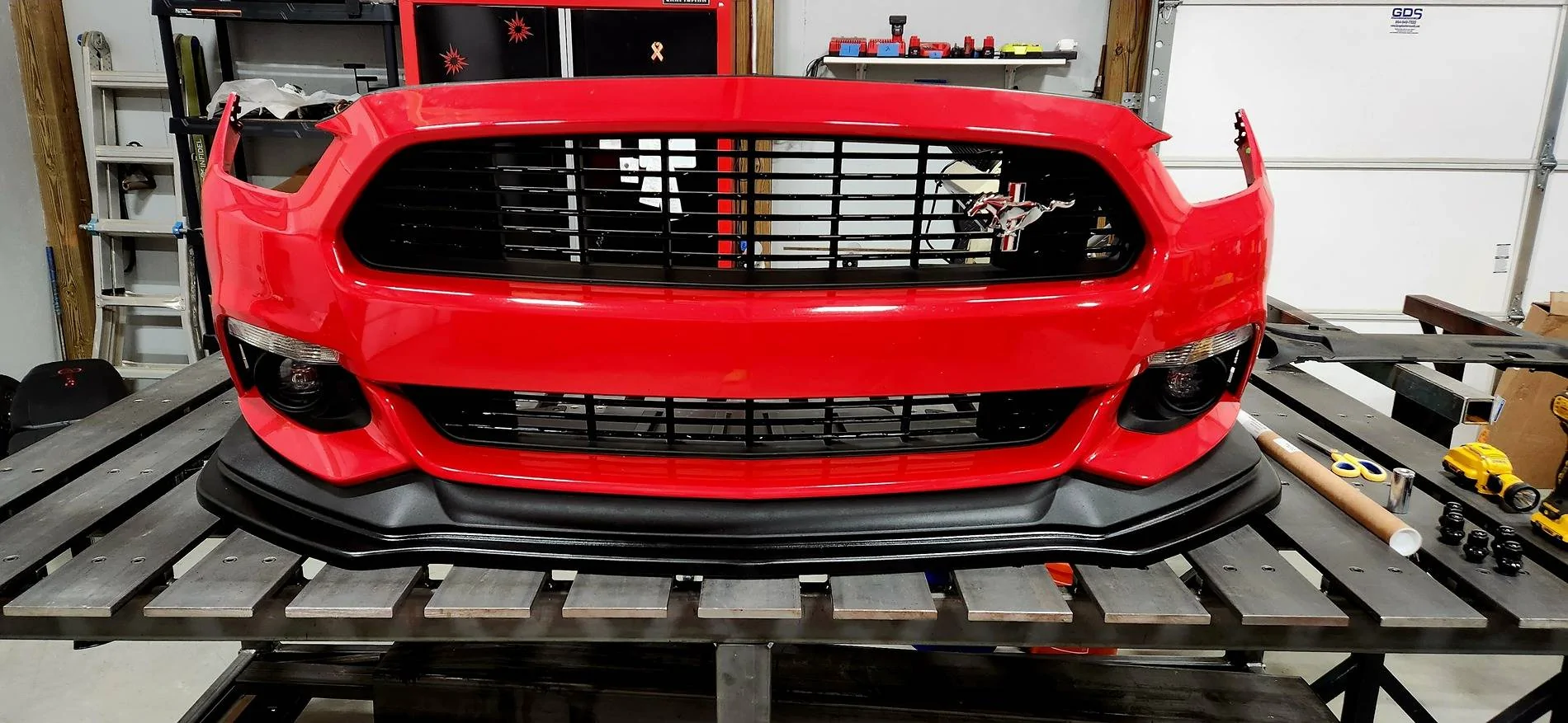

On my GT I always keep the splitter and belly pan with the bumper.
Once the ends are free from the fender I let it pivot down unsupported and then
disconnect the fog lamps.
Then I lift the entire assembly from the upper front edge and walk it over to set it down. The belly pan keeps the bumper upright.
Although things flex and while it is big and awkward, nothing gets damaged.

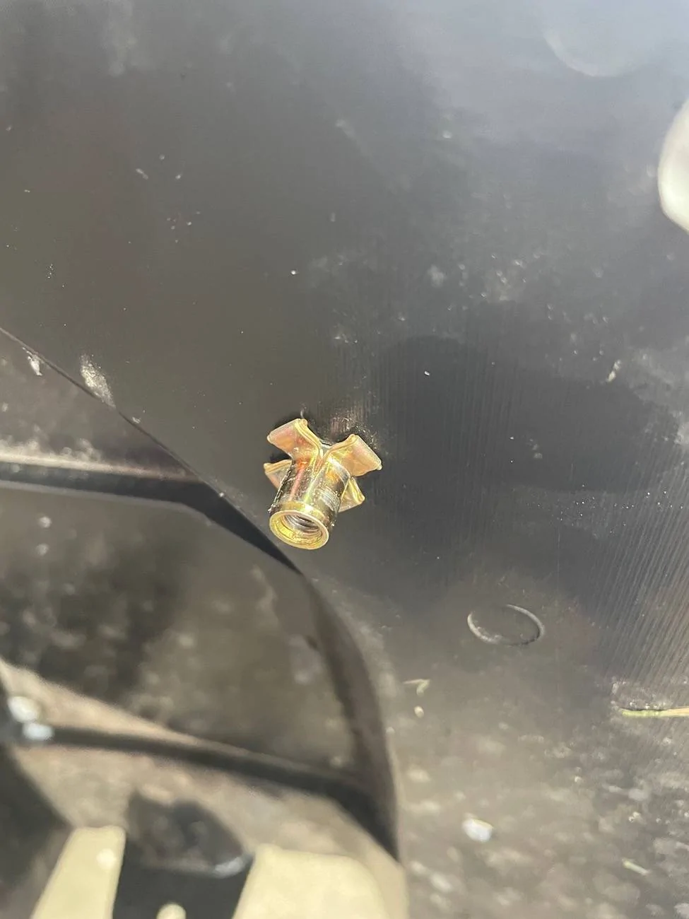

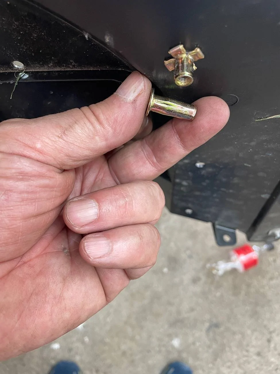

So I also wanted my splitter to be easily removable, on for track, off for street. I tried the aluminum rivnuts and found that they didn’t really crimp around the plastic as you’d expect, they just push the hole larger as you compressed them and never really crimped.
I ended up using this style.
That’s a rivnut plusnut or similar brand which they suggest using for plastic or thin materials. I just found those the other day but ended up not removing my splitter
