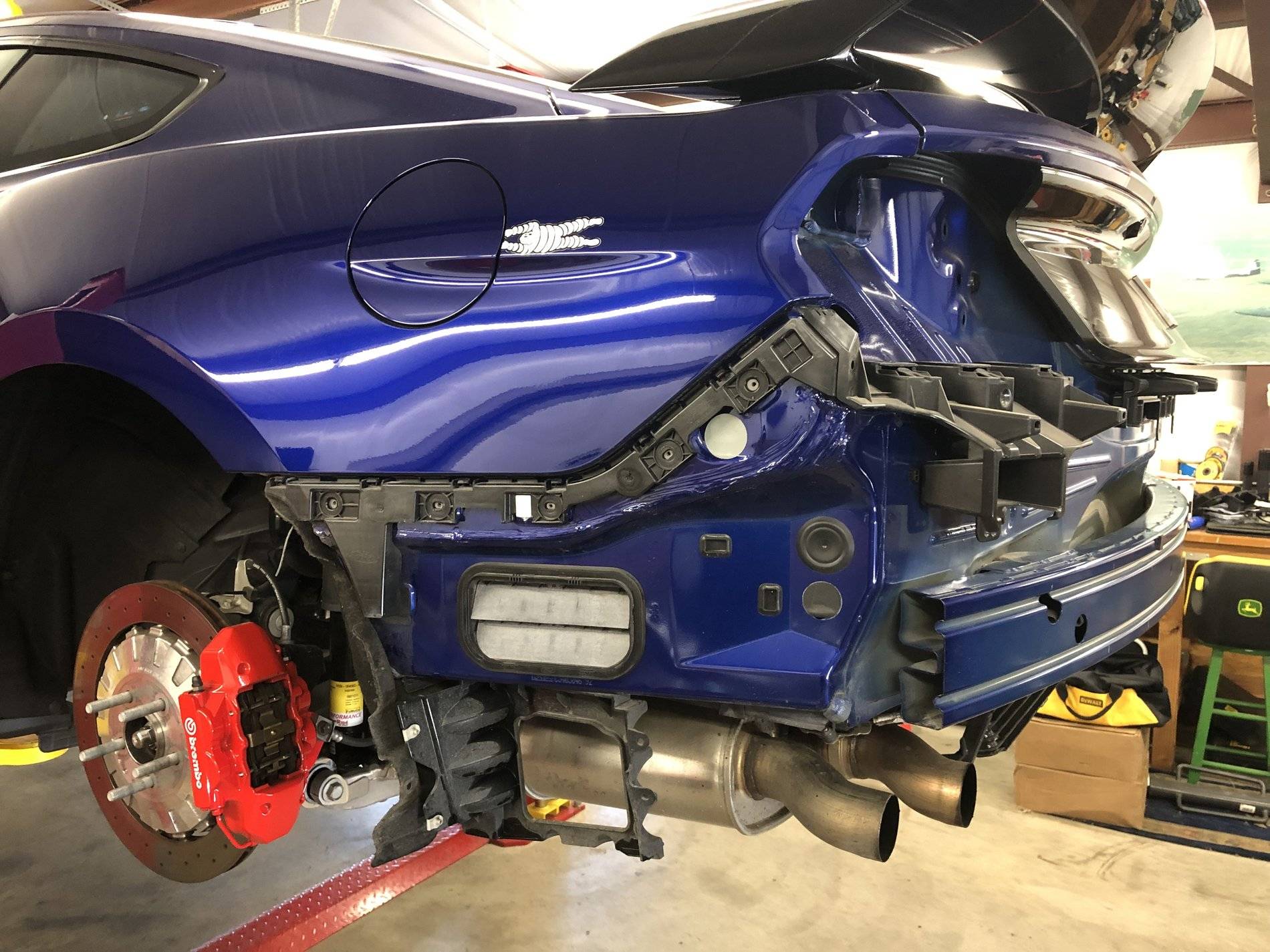

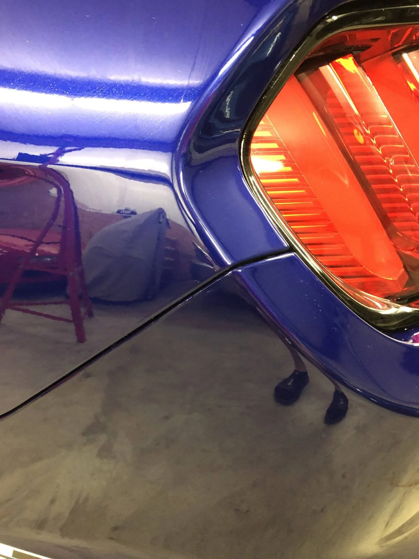

Pretty sure there is a person in here who fixed it themselves for little expense and it came out better than the Ford kit.
Yes and if is found he showed detailed pictures of what he did. And it looked real good. Now whether it held up or started sagging again is another story. I know one guy on here put hidden screws to close his gap but reported some time later that it was gaping again so he gave up.
That was me (there’s two or three of us that did our repair). I’ve got 10,000 miles on my homemade repair, including removing the bumper for an unrelated issue, and mine still looks perfect (knock on wood!!!!). I guess search for my thread on the topic if interested.
