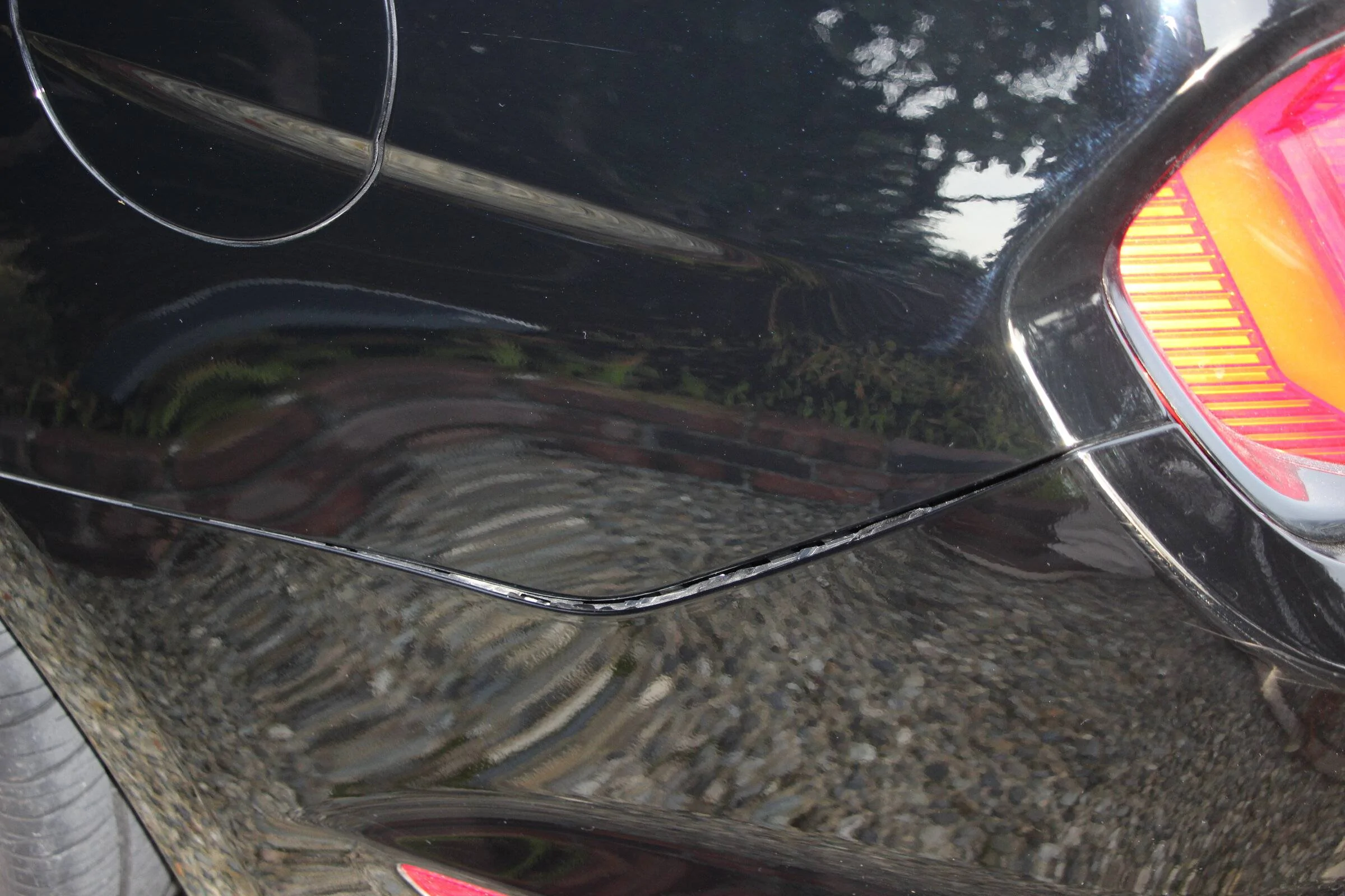

I have a GT Premium 2021 that was purchased new from a Ford Dealer end of October 2021. It has 2,400 miles on it and today I saw what looked like someone hit the left rear bumber panel. No dents, no scratches so I googled to see if it is an issue. It lead my to this site/forum.
It looks like it was mostly on GT 350's 2015-2018 from what I can tell according the the Ford TSB dated March 29, 2018.
Mine is really bad, separating to the point tabs can be seen (picture attached).
Has anyone had theirs repaired by a Ford Dealer under warranty and did it fix the problem and last?

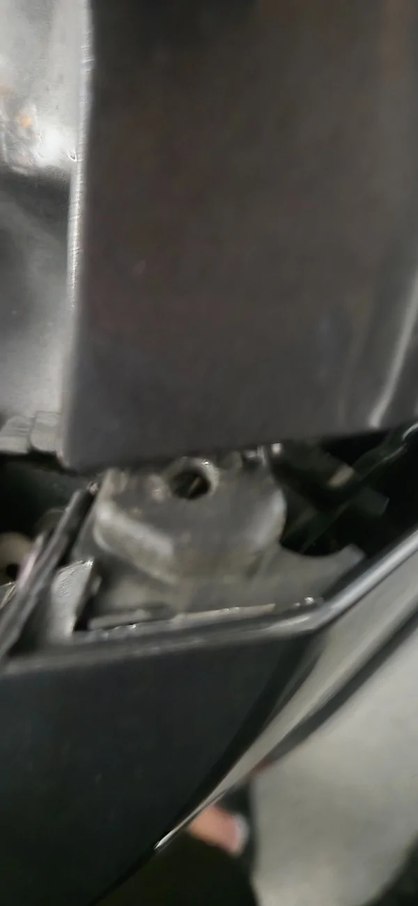

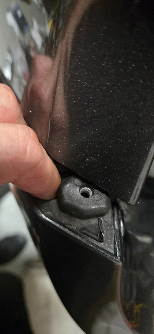

This weekend I decided to take the bumper apart to inspect the brackets. To my surprise, I found that the right side of the bumper wasn't threaded by the tail light, and the bolt was just free spinning (2nd photo).
I used a M5x0.8 thread insert, everything is holding well, and the bumper sag is now better, but not perfect.
Note: The front and rear bumper retaining brackets s have little v-shaped metal clips inside. You can push a flat head screwdriver under them to make them "grab" again.
