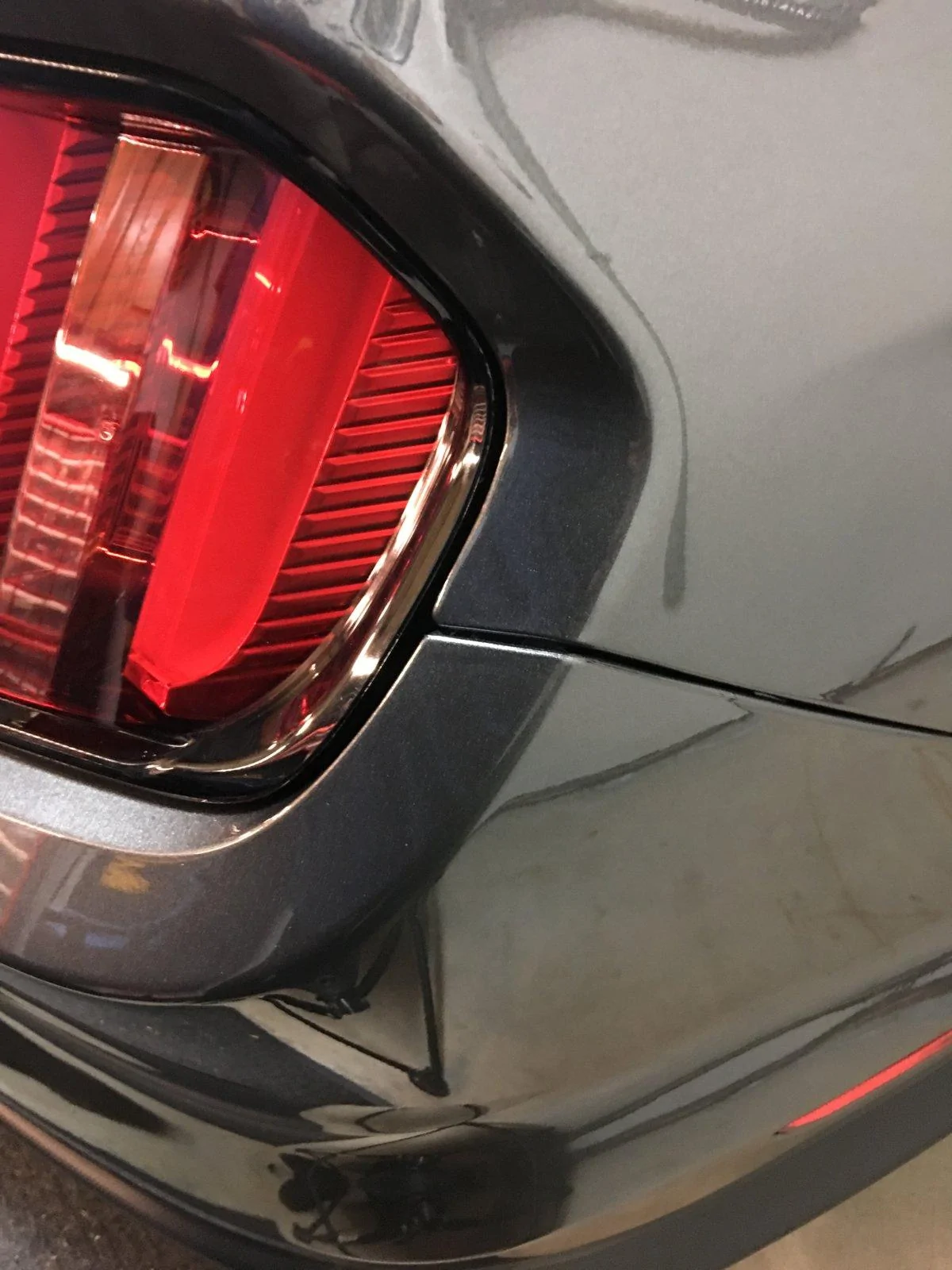

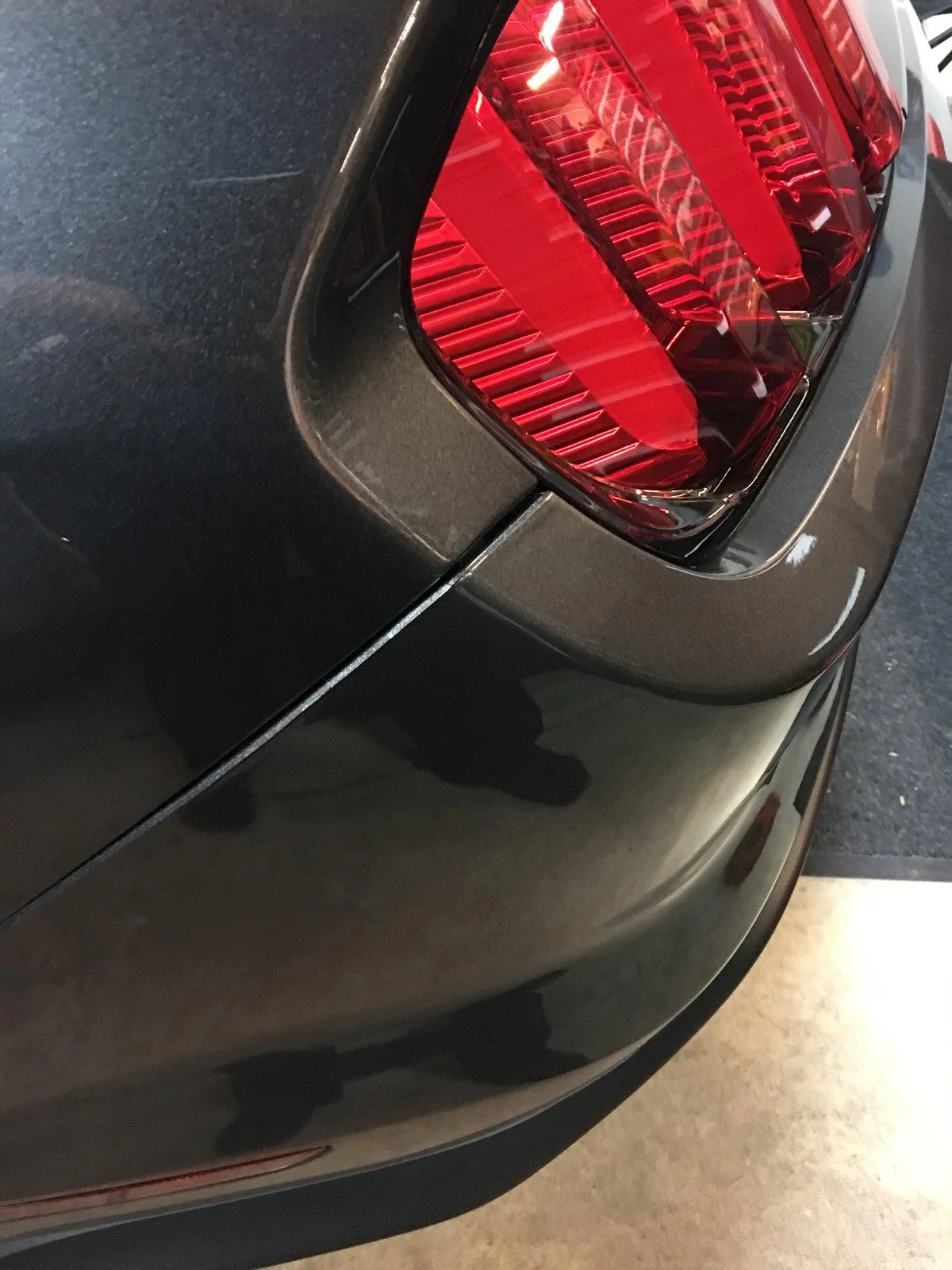

Anyone have a pic of a NON repaired bumper gap.. Curious .. Thanks!
NDALLAS40
Jul 23, 2018
171
148
N TEXAS
2016 GT350
I do, but I'm not publishing it. Just go to your nearest Ford lot. At least half of all Mustangs have it.
