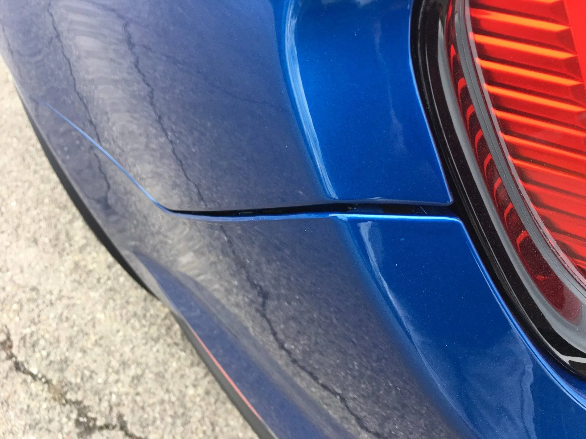

Thanks for all the support guys! I'm currently working with the dealer to resolve this and should have full details on what's going to happen tomorrow.

Update:
I Spoke with the Body shop manager yesterday and he couldn't understand why the car never made it to his department. I have to meet with him on Tuesday to discuses how were going to fix this situation. Hopefully it will just be a paint less dent repair.
The body shop manager has a history of restoring old Shelby's and owns multiple Shelby cars. He seems very knowledgeable and was much more understand of the situation than the previous people I spoke to.
No_step_on_snek
No_step_on_snek
Mar 27, 2018
46
Eastern Pennsylvania
2018 GT350
Second Update:
The body shop manager for the dealer group is the real MVP and also Shelby enthusiast as well! (Owns a 2008 GT500.) The dents were able to be fixed with paintless dent repair in about 30 minutes.
He's also ordering another TSB kit so in about two weeks we'll try and get this bumper lined up again.

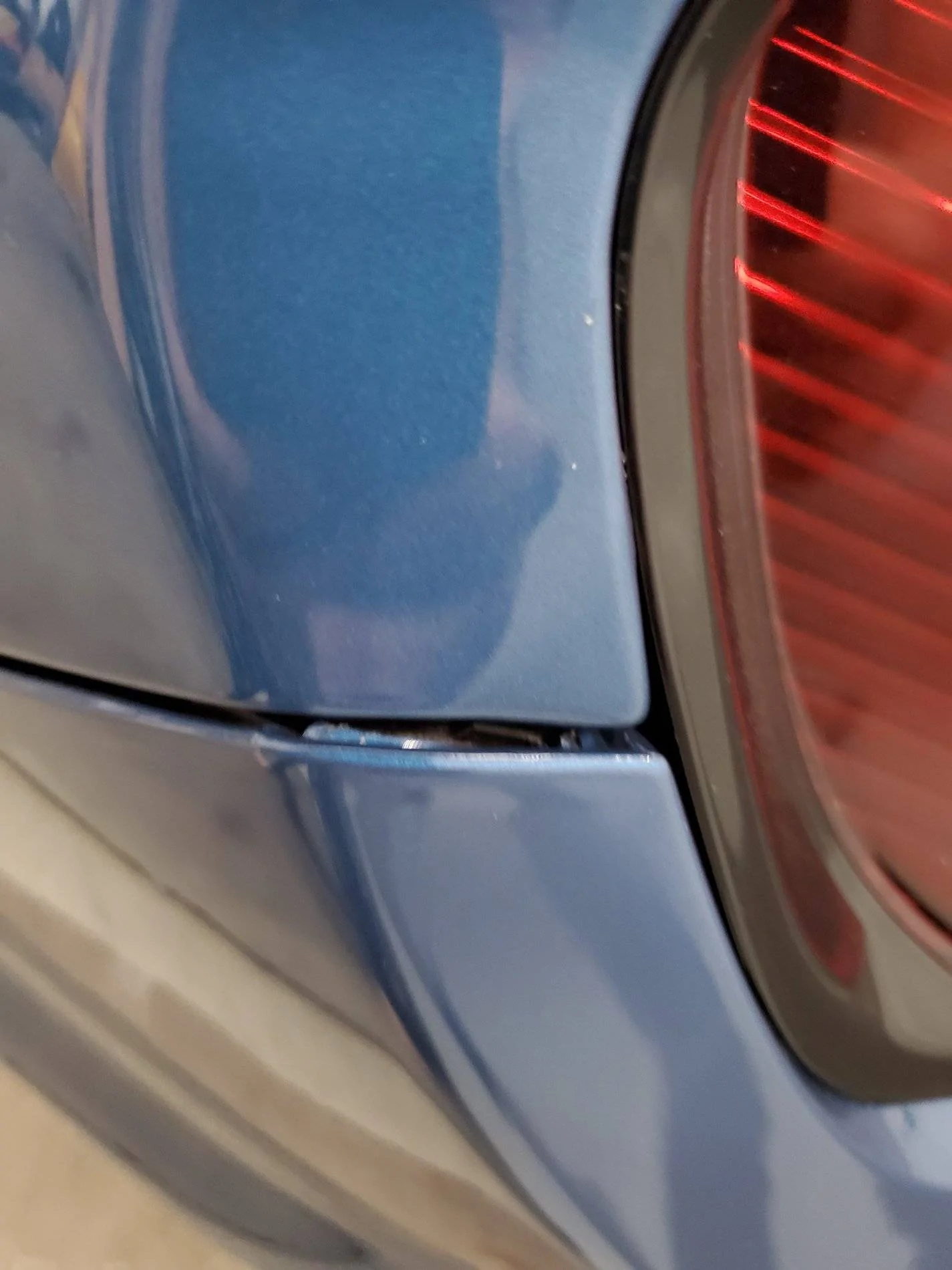

This is mine, which has 5 miles. Is this even worse then normal? I will assume not, based on all this

I am sorry to ask (embarrassed) but what is "TSB"?
TSB is Technical Service Bulletin. I cannot say what is typical but for what is essentially a new car it looks like a large and uneven gap. My car is over 2 1/2 years old and my gaps are less than that. I’m sure others will have additional points of view.

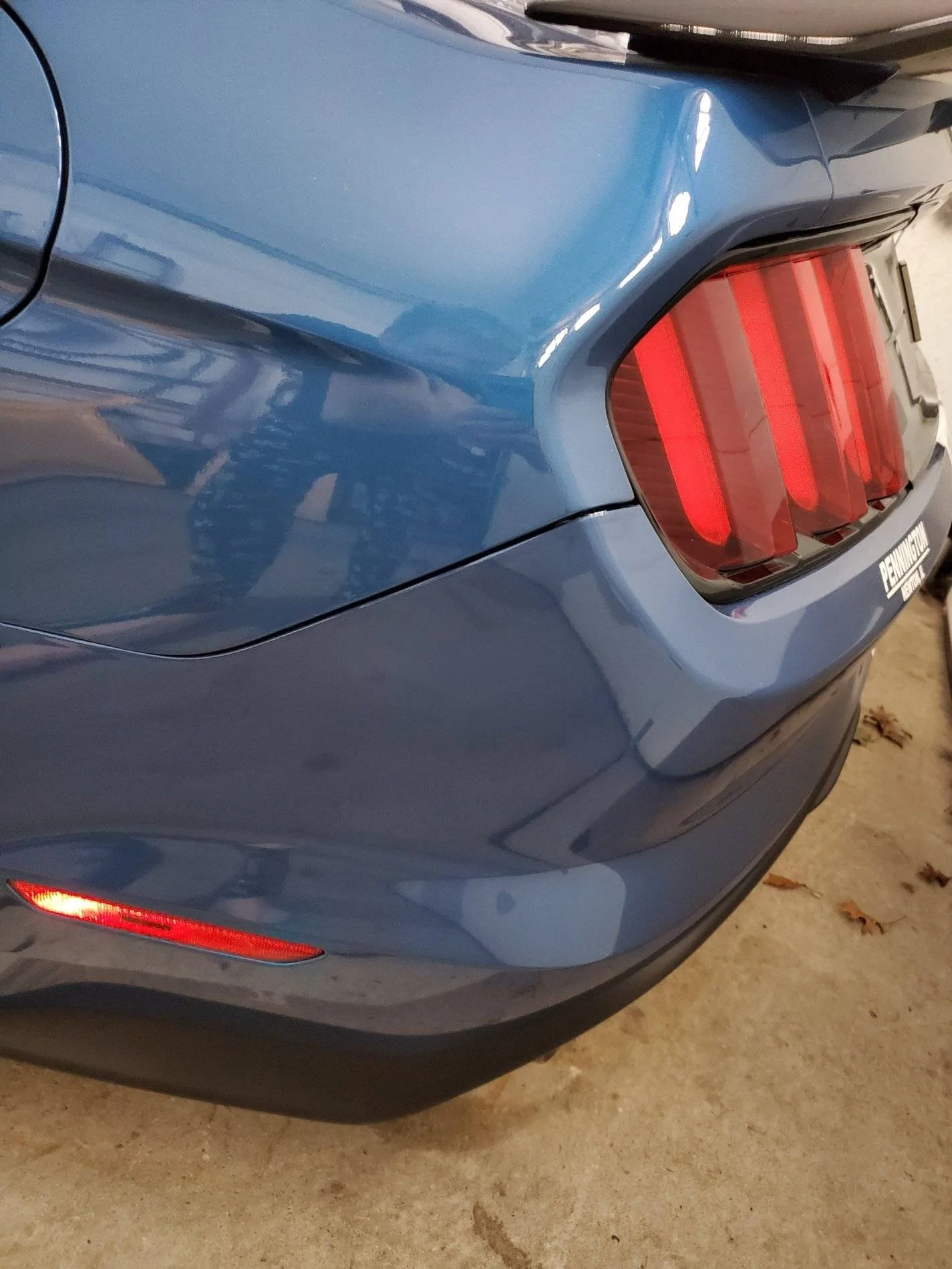

Anyone else willing to share pics?

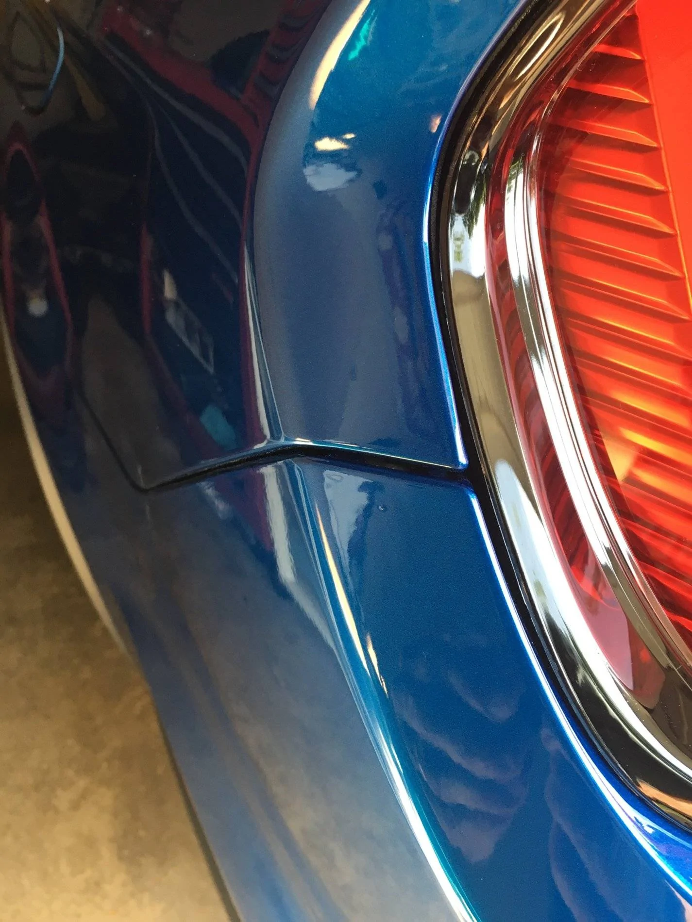

Before:
After:
As you can see there’s no real difference, maybe slightly worse. On the plus side it hasn’t gotten any worse since the TSB work was done. At some point I’m going to do the method that was a linked above.
