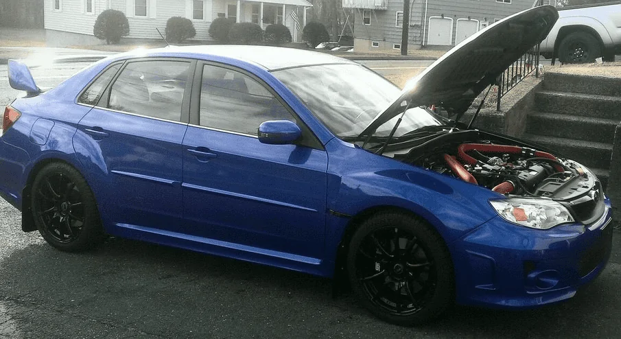

I traded my modified 2012 Subaru STi Limited for the 2020 GT Premium.
4/21/21 | 4,100 miles | $42,4k (the budget was $35k.. whoops!)
4/10/21 | 38,138 miles | 540hp/425tq | $22k trade allowance
iwsti.com/member_journal

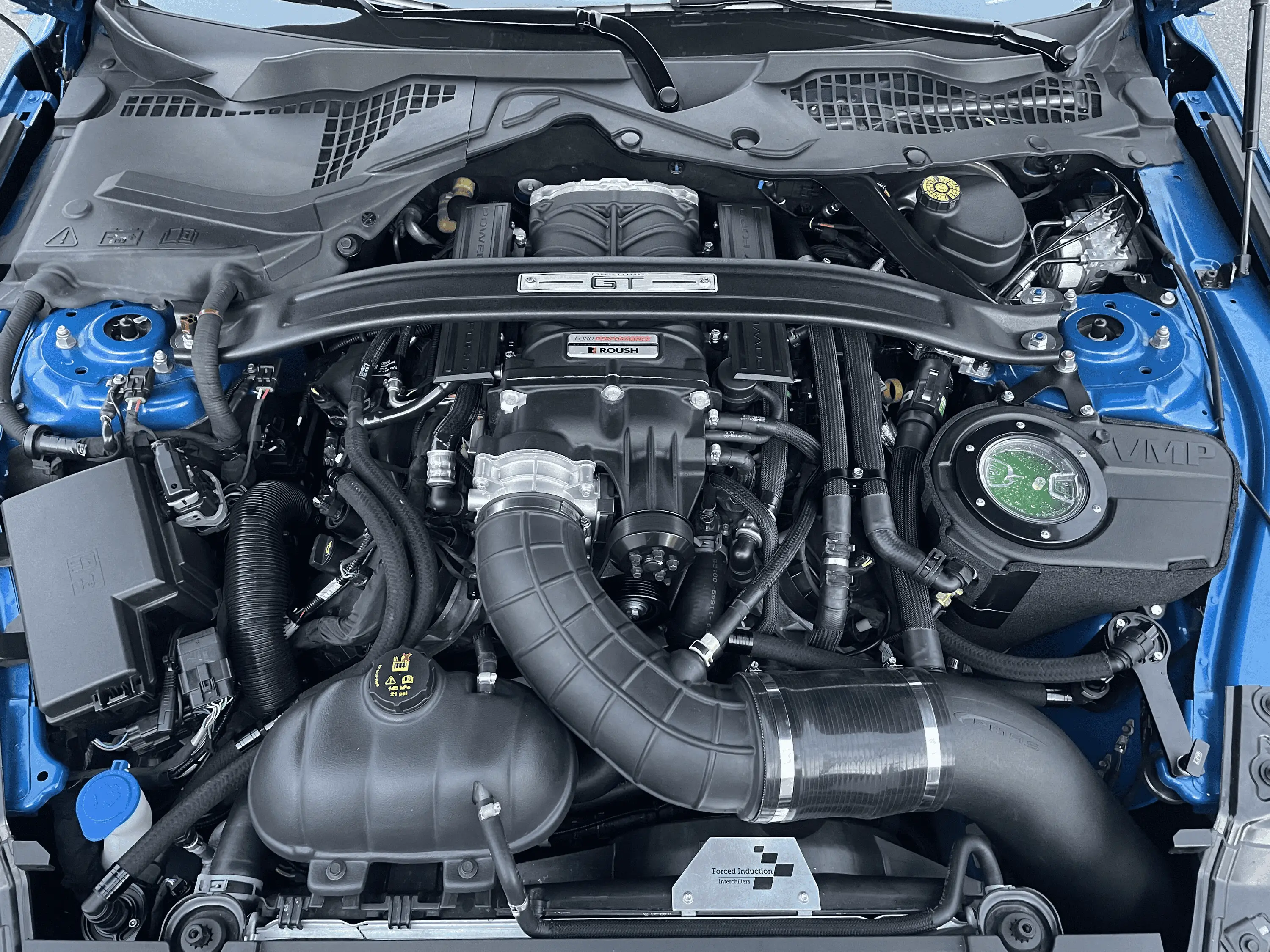

Current Day & Table of Contents

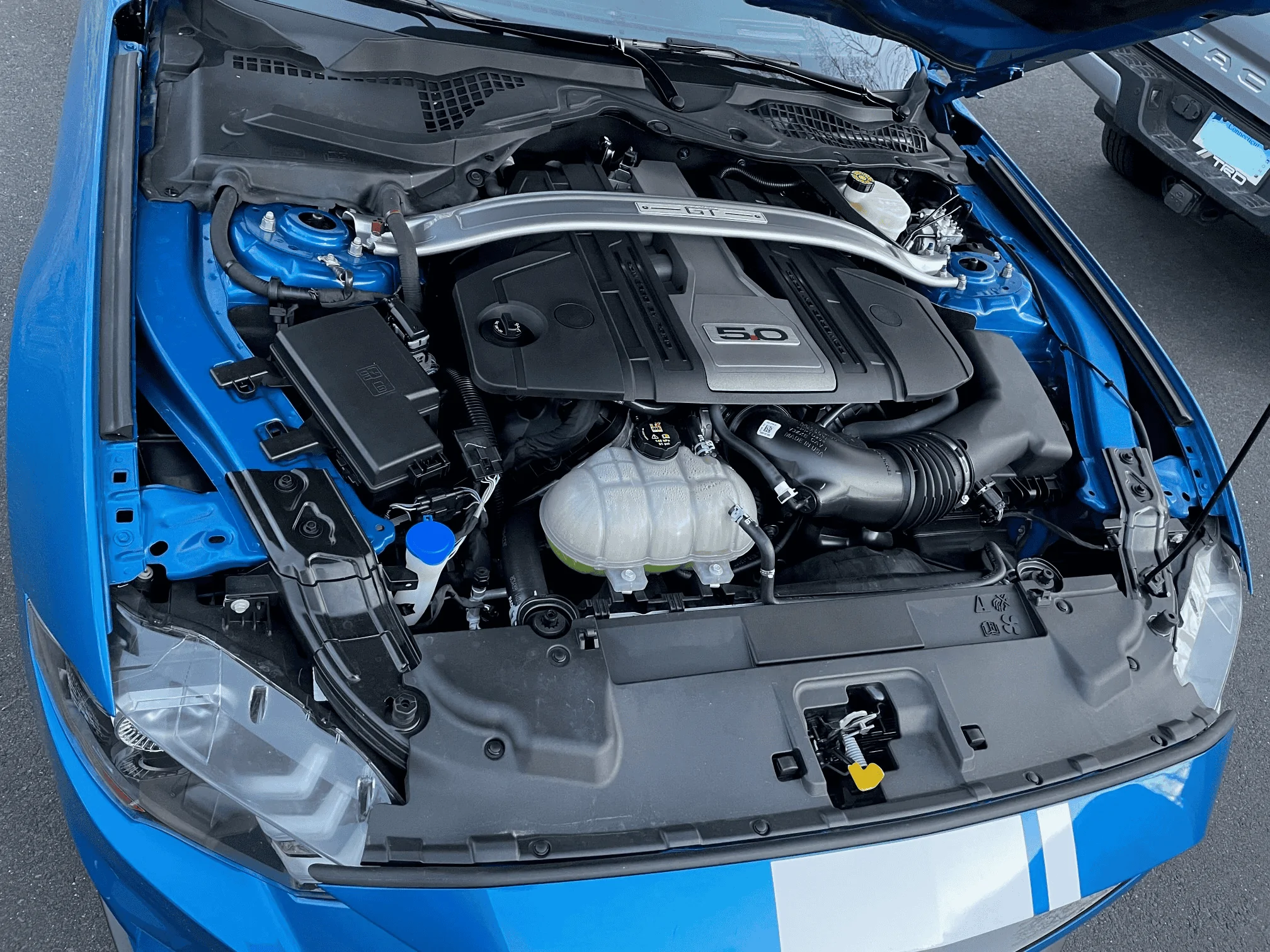

ENGINE/POWER:
Gen3 Coyote 5.0L

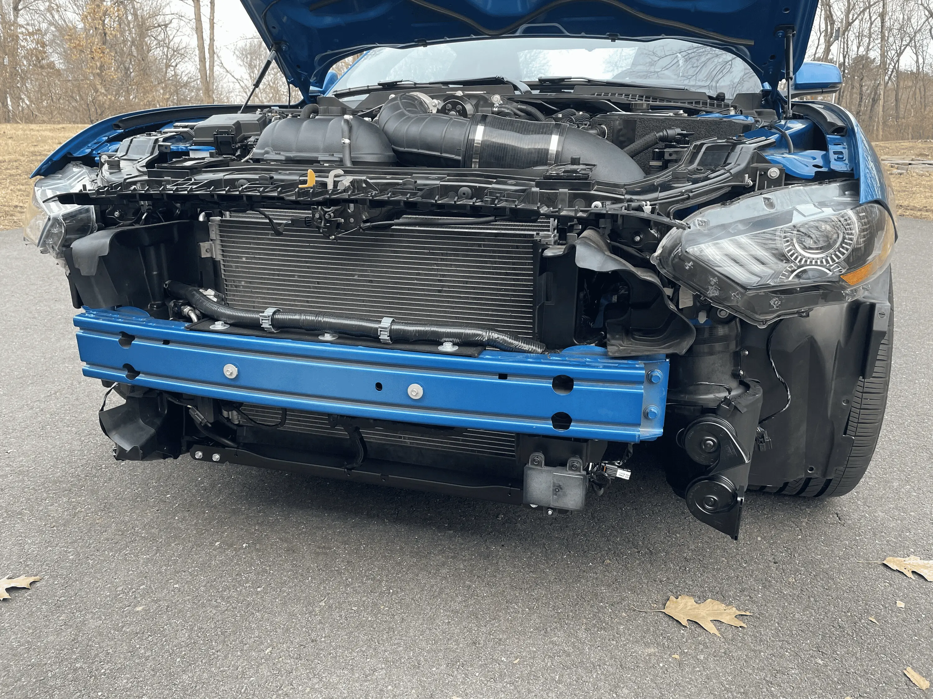

Roush TVS Supercharger Kit Phase 2 $7,860 post #32 -> post #52
Forced Induction Interchiller Stage 1 $1,682 post #65
Roush H-pipe $295 post #56 & #101
JMS Fuel Pump Voltage Booster $490 post #22
Motorcraft 5w-50 Oil
Ford Performance Spark Plugs M-12405-M50A
Ford Performance 47lb Fuel Injectors 13119F593K
UPR Dual Oil Catch Can Kit $370
J&L Dual Oil Separator Kit 3.0 Black Anodized $329 Returned post #23
VMP-SUC059 Ice Tank for the GT500 $499 post #102
PMAS N-MT14-3 Fenderwell CAI $349 post #102, post #114
Filterwears F215 Pre-Filter $32 post #103

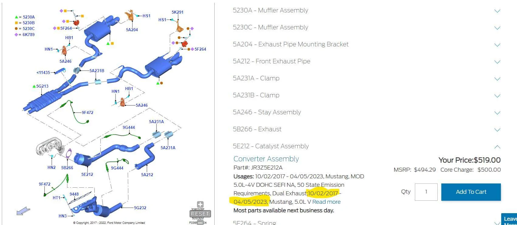

Game plan if the supercharger results cat failure??
shop.2mfabrication.com/mustang-gt-gt350-gt500

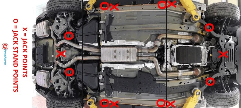

Jack points:
https://www.cjponyparts.com/resources/how-to-jack-up-your-2015-mustang
QuickJack Tutorial
https://www.quickjack.com/support/downloads
https://www.youtube.com/@quickjackusa

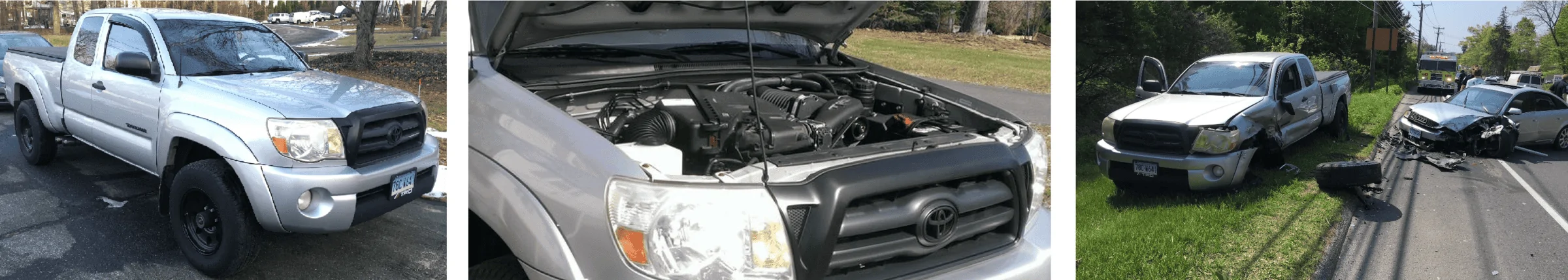

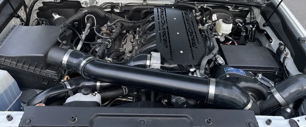

What's in the garage??
2019 Duke 790
2021 Sportsman 450
2021 Supercharged Tacoma
Honorable
Mention
2006 Supercharged Tacoma

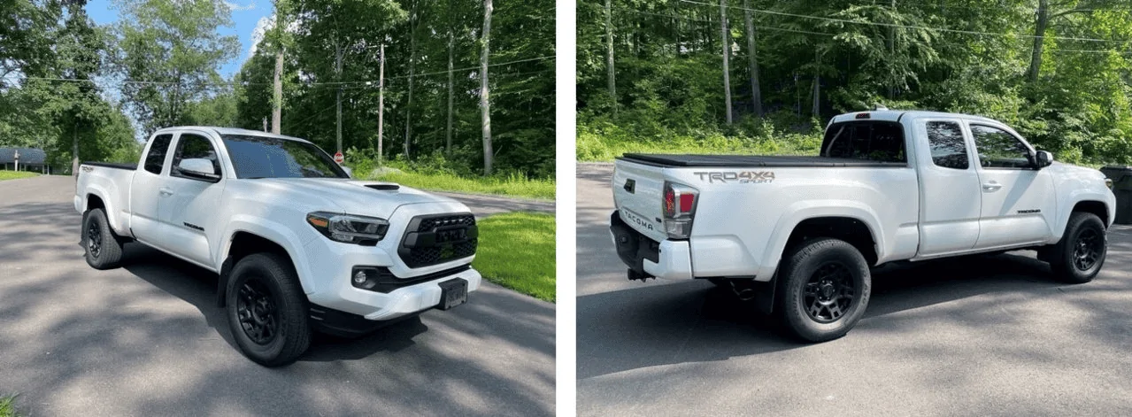

Very cool. That bike is a beast.
I leased a 2018 TRD Off Road after my 2006 got totaled. I hate the fake hood scoop on my TRD Sport.
I love the mustang so far. Getting power to the wheels is effortless. I ate a bit of $$ on the trade, but this S550 was local and had everything I wanted. The wife is a little pissed that I didn't get the 10 speed.
I don't think I'll do much else other than the Roush SC phase 2 kit, pump volt booster, and some oil catch cans. Although, the mod bug is contagious.
Roush blower on 18up is a no go. Intercooler brick is insufficient. Procharger, now that will get you taken care of!
