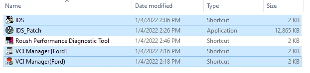

I'll also share my findings for other's who are curious:
I followed the download instructions on vxdiagshop.com.
I downloaded the IDS software for VXDIAG using VirtualBox and a shared folder. Worked great. Ford IDS V124 (3 files); Ford_Mazda IDS Patch (1 file)
Just for kicks, I also tried to download without using the virtual machine. Had success on the PC using my phone's hotpot network (company network blocked it).
Only pushback from antivirus occurred for the IDS_Patch.exe. Luckily it allowed me to Run Anyway.

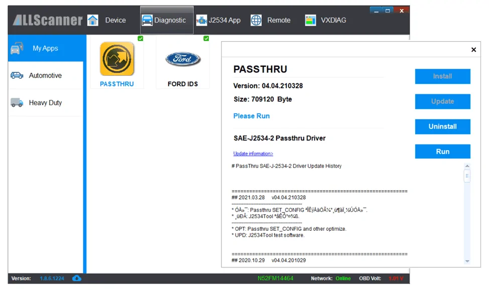

you have to either run a virtual machine with usb ports functioning or disable your antivirus as the driver download thinks its a trojan. works perfectly though. performed this exact operation few weeks back using roushes RDT
download the driver for the passthrough j2534 only using their vxdiag manager
Thanks again! Now that I have the VXDIAG VCX Nano your post makes complete sense.
Whoops.. I downloaded the VCI Manager instead of the VX Manager.
I’ll clean up my confusion in post #4 for other's who are curious:
Helpful links:
**VX Manager driver**: http://www.vxdiag.net/?lang=en
Ford IDS install: https://www.vxdiagshop.com/info/vxdiag-diagnostic-software-download-4048.html
How to RDT install and flash: https://www.roushcleantech.com/pcm-programming-with-rdt/
I found the instructions that came with the VXDIAG VCX Nano to be easiest to follow:
I followed the entire process above, so Ford IDS is also installed. RDT and VX Manager are all I have needed so far.

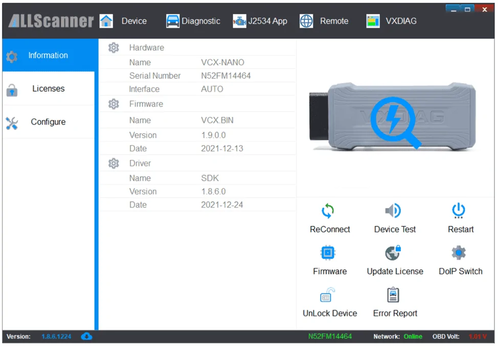

Linking and Setup
-I connected the vxdiag device to my laptop and open the VX Manager.
-The app recognized the device immediately.
-Clicked on the Diagnostic tab.
-Clicked PASS THRU.
-Installed PASS THRU.

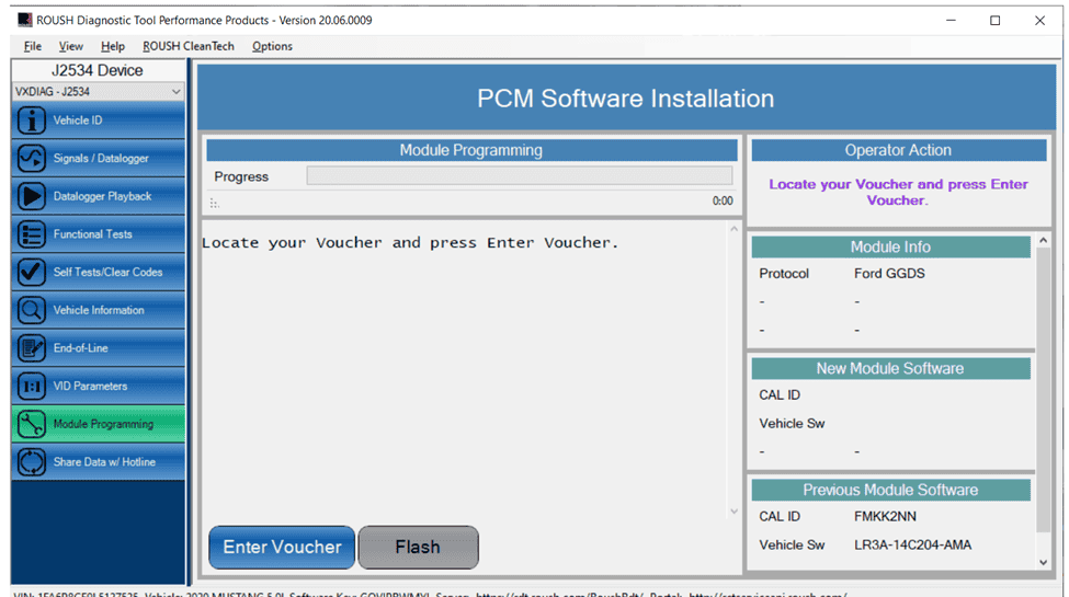

-Installed and registered the Rosh Diagnostic Tool following the Roush clean tech video:
-Opened the RDT app and followed the clean tech video up to the entering the voucher.
All seems legit.

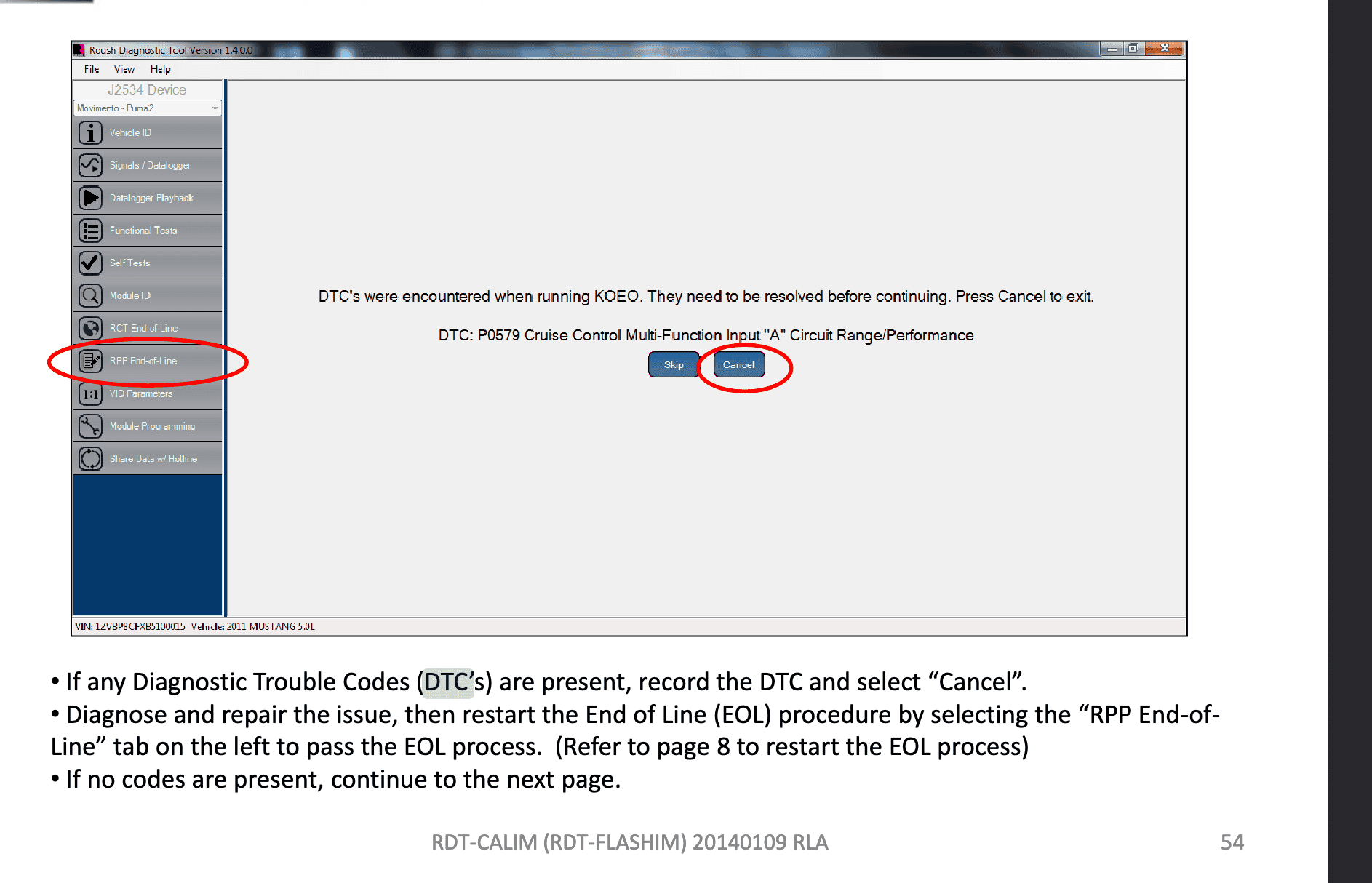

@SH!FT Hope you don't mind if i resurrect this thread with a question.
Is this misfire profile correction part of the Roush tune? or is it a separate step?
RDT will prompt you to do it during the reflash process.
You'll need to do it if you are replacing the crank pulley. The correction is easy. You'll just rev the engine to 4K a couple of times.

I think I installed the VCX pass-thru firmware/software in a weird order but its showing as "installed" with the green checkbox like in your example, so hopefully there's no issues.
I did the Ford VCI and IDS install after doing the patch. Then ran the patch again one more time after that hoping it would matter. The reason for all this being, that the ford ids was showing as not install in the My Apps tab. I think it was broken from the initial VX manager install config/setup run. But I followed this blog from their website to fix the issue if anyone is wondering.

Also what do you mean by "4) DTC needed to be ignored." I should select skip button instead of cancel ?

Yeah the software install was a little confusing. As long as the RDT "Vehicle ID" function connects to your car you should be good.
The correction revs take less than a minute, but the car with need to idle in the garage for a while. The engine needs to get to temp before some of the prompts during the reflash can be completed.

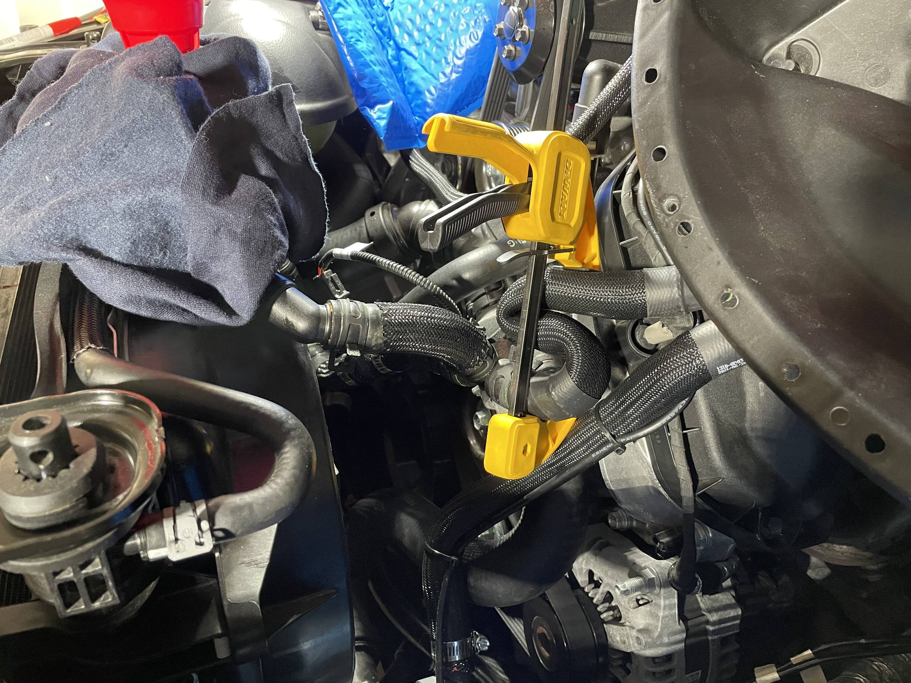

For the coolant:
The degas bottle is tiny and super easy to over fill. I recommend only half filling the bottle at first.
I've drained and filled the IC coolant a few times now. The first gallon goes in easy. Then I have to force the rest of the air out. Pumping and folding the return hose helps burp it. The coolant foams, so I always have to top it off again the next morning once it settles.
