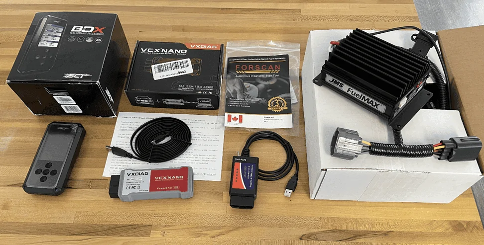

Electronics are here. I’m installing these before the blower to insure all is working correctly and that I’m able to flash the tune. Also might grab some naturally aspirated data for comparison.
P2000PPM15 JMS Fuel Pump Voltage Booster
I’ll do a separate post for the JMS booster install.
JMS install video: video link
JMS programming video: video link
JMS manual: https://www.jmschip.com/content/PowerMAX_V2/PM2000-PPM11_PM2020-PPS11_Install_V11_WEB.pdf
40490 SCT Performance Programmer BDX
I registered the BDX Programmer on sctflash.com. They don’t offer a preloaded tune for the Roush supercharger kit. I may try one of their NA preloaded tunes after I’m done playing around with FORScan.
**Edit** The BDX is not compatible with the Roush calibration.

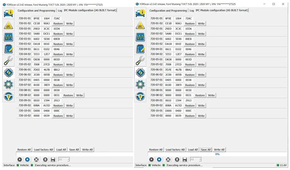

The FORScan software and ELM327 adaptor are pretty straightforward. I used these two videos below to enable the factory boost gauge:
How to save and load as-built files: video link
Easier video to follow for the software download and setup: video link

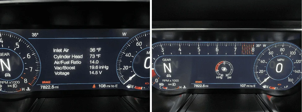

I first tried the 12 digit code provided in the 2nd video link above. The boost gauge appeared, but it disabled the oil pressure gauge. It’s easy to reload the factory settings as long as they’ve been saved.
Simply changing the 3rd digit of the factory code to “7” worked for me (720-06-01: xx7x-xxxx-xxxx).
My factory settings shown on the left above. The ECU was able to correct any checksum issue during the write. The 11th digit was automatically changed from “1” to “A”.
I’ve added links with more as-built value info in post #3.

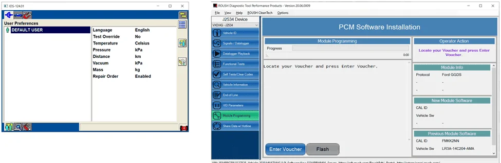

VXDIAG VCX Nano J2534 Programming Device
J2534 device compatibility with the RDT software was a bit of a gray area. Roush’s recommend devices are super expensive. I got some great help here:
https://www.mustang6g.com/forums/th...compatible-with-the-free-rdt-software.169914/
I’ll continue to post updates there.
The VXDIAG VCX Nano seems to work great with RDT and Ford IDS. Worst cause I mail the ECU to Roush. I’m ready to purchase the blower.

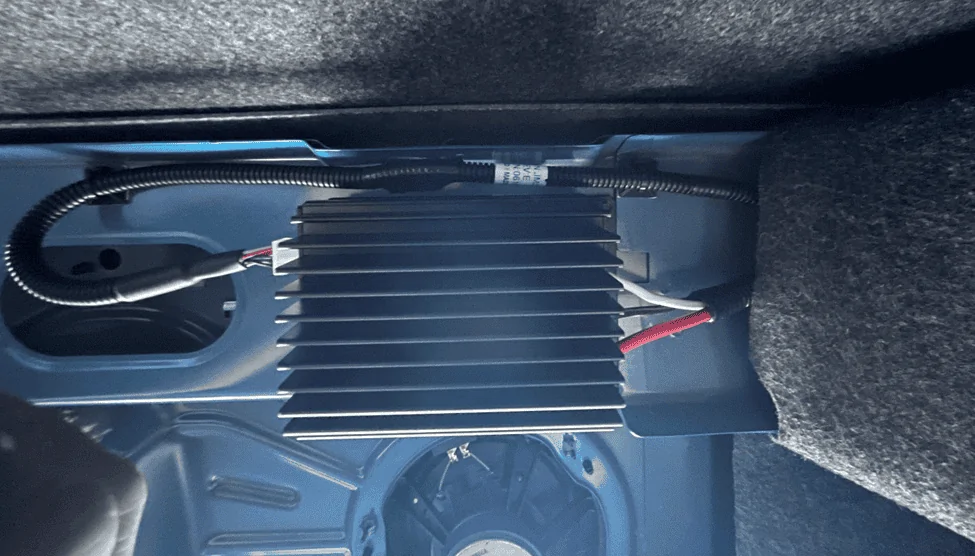

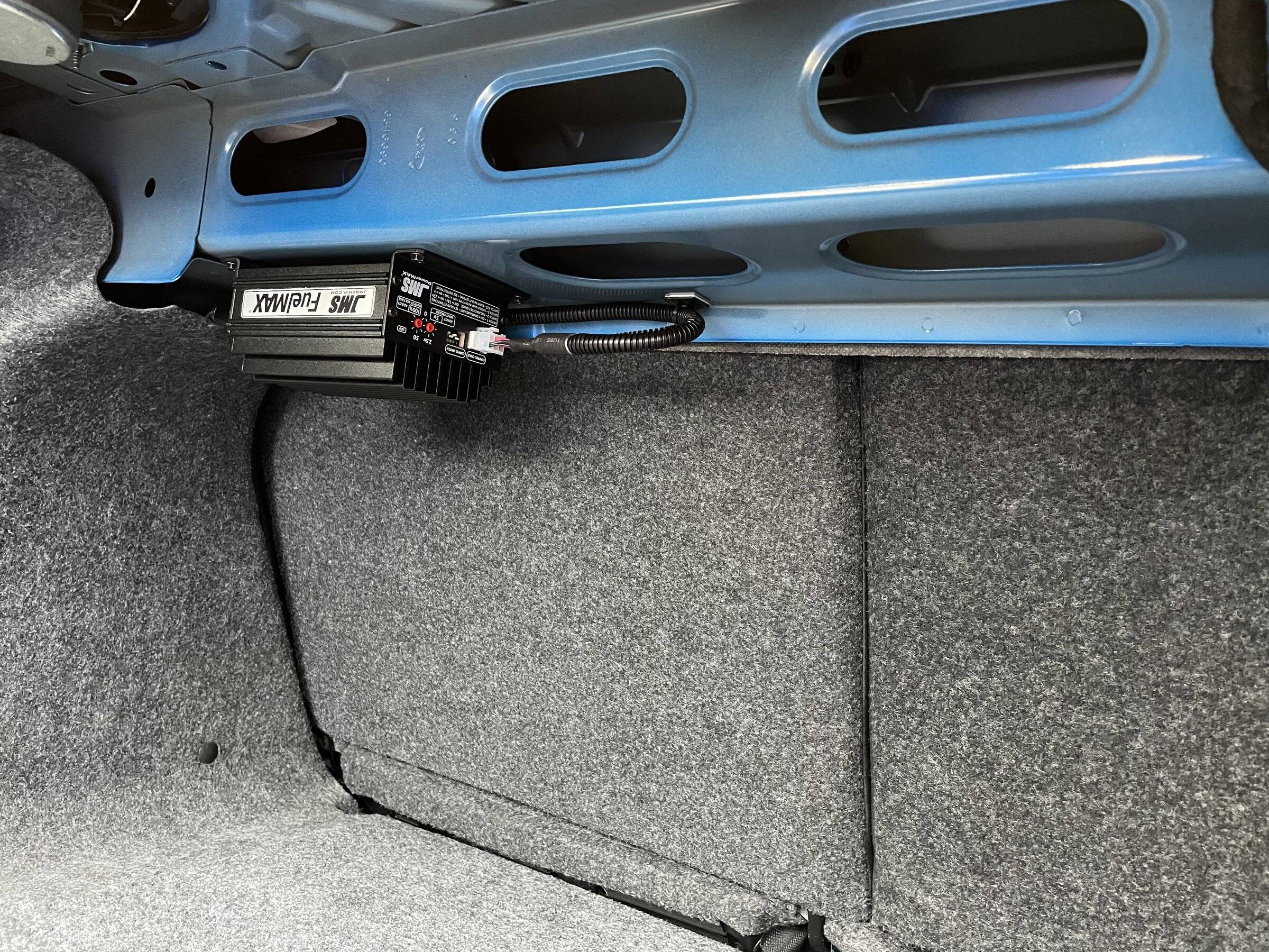

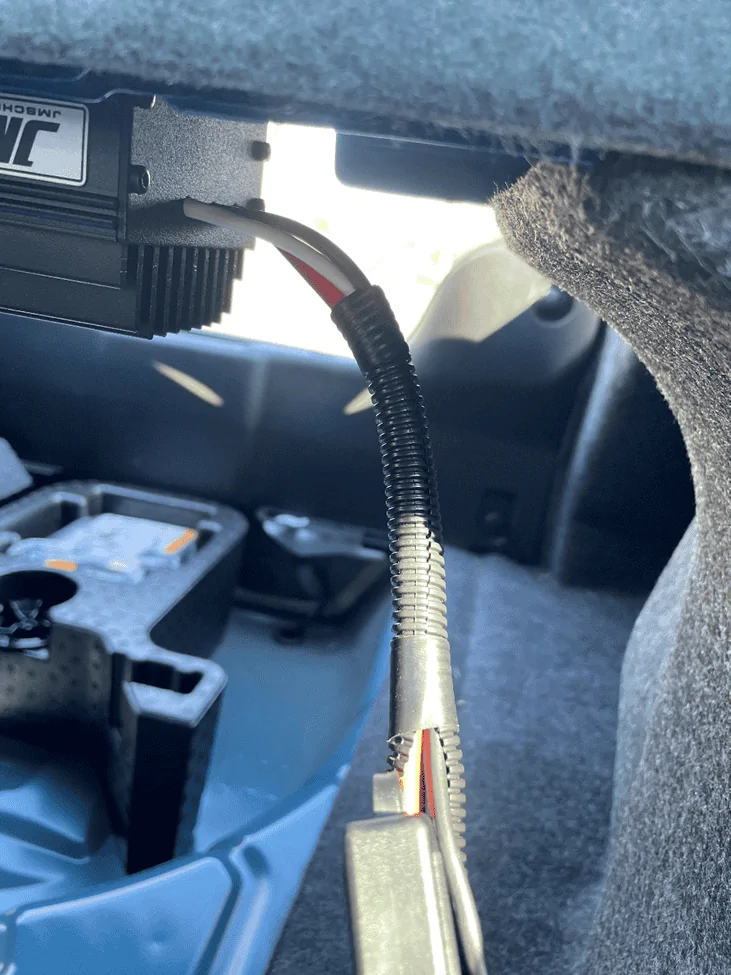

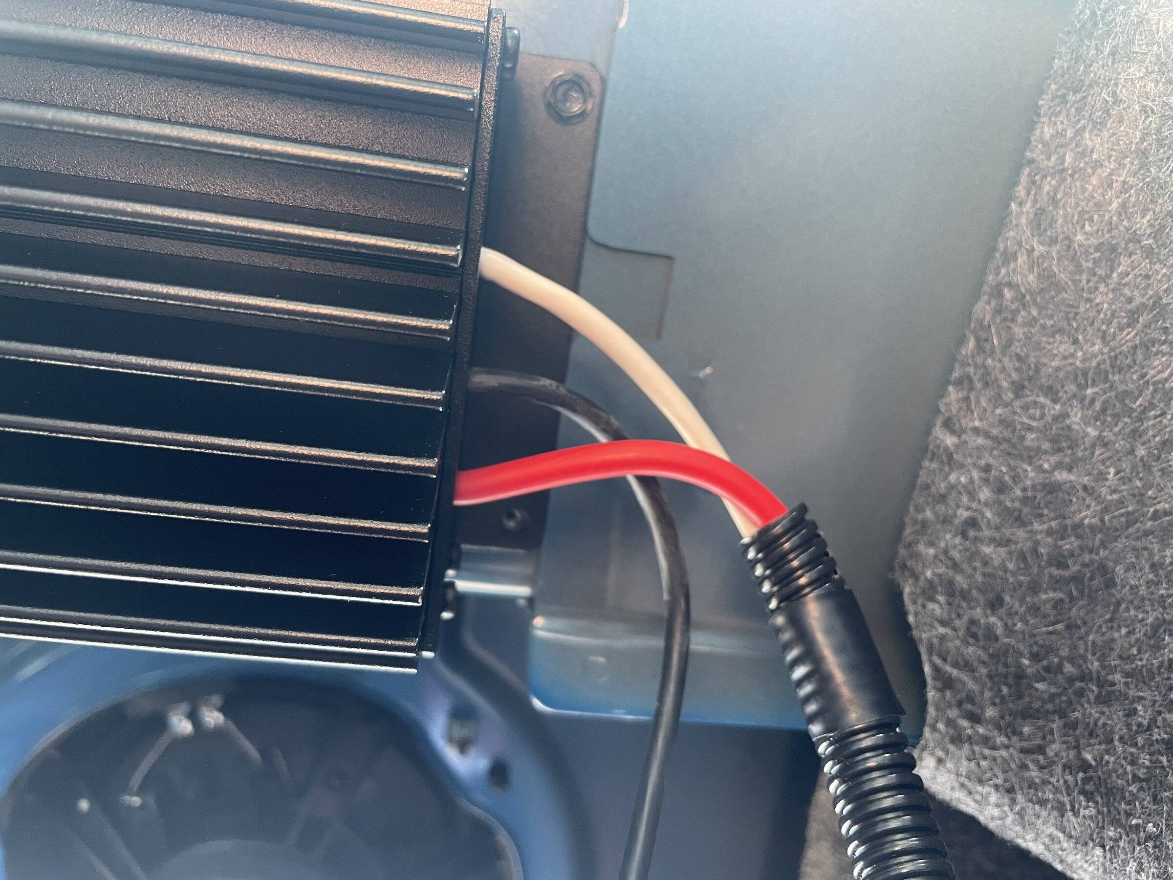

Installed: P2000PPM15 JMS Fuel Pump Voltage Booster
Helpful links:
JMS install and programming videos: See post #21

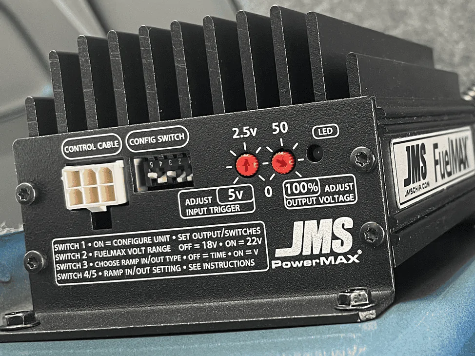

I for the most part followed American Muscle’s install video and the voltage booster arrived preprogramming for my build needs. The install took me a few hours because I’m OCD with wiring.

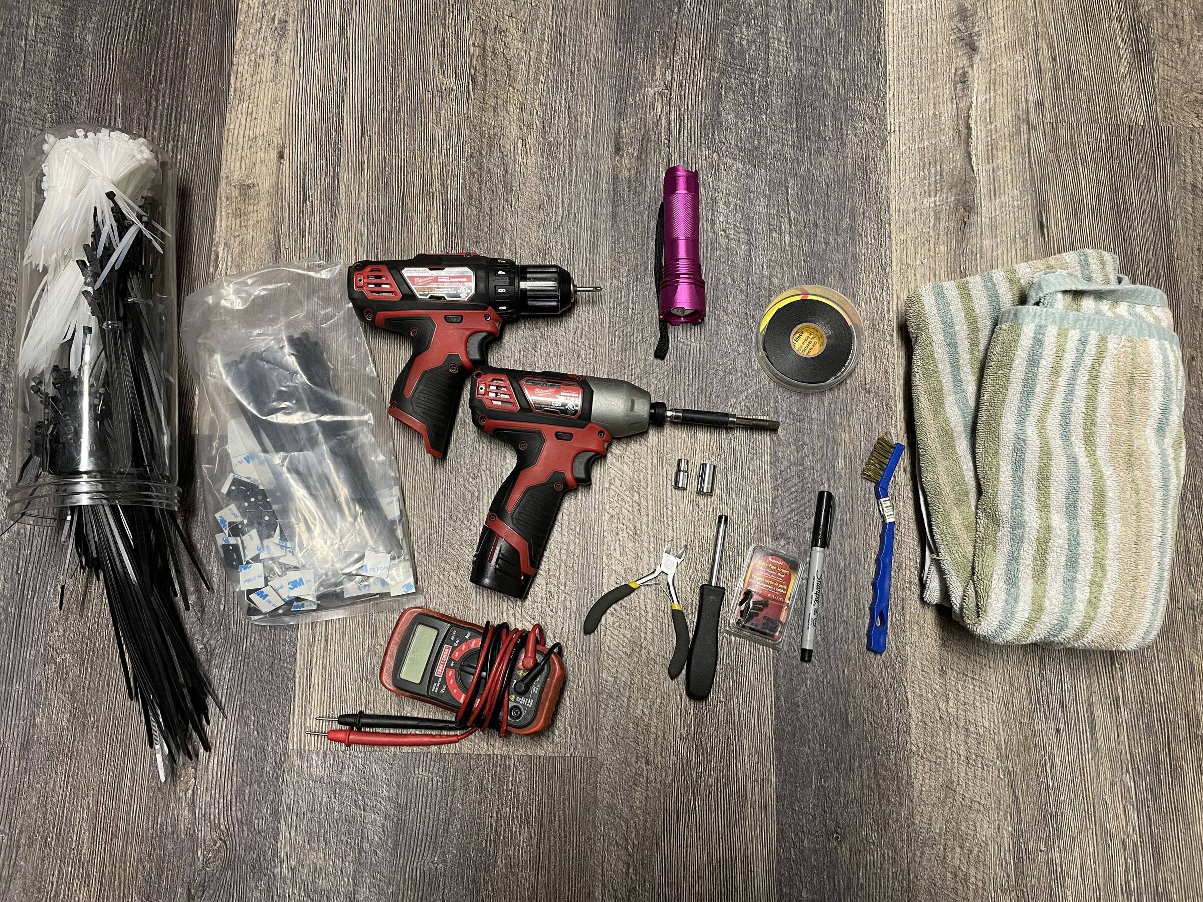

Tools used:
Tools will rust in my garage, so I’m stuck lugging everything up from the workshop in buckets. I intend to snap a pic of what’s in the bucket(s) after each install for this build.
I made a few minor deviations from the AM install video:

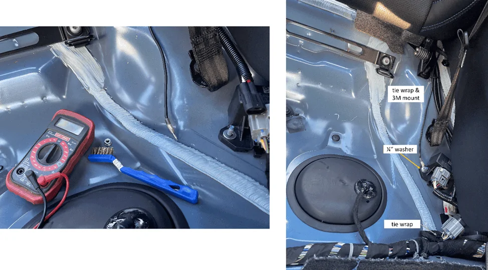

The booster unit sits nice and square when butted up against the crossbeam joint. I used #8-18 x ½” self tapping black oxide screws to mount the unit. A #2 center drill worked perfect for the pilot holes. I always snug self tappers by hand.

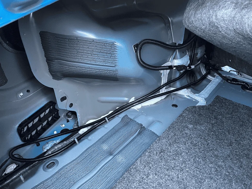

I was able to fit the ground wire into the cable sheath before fishing everything behind the trunk insulation.

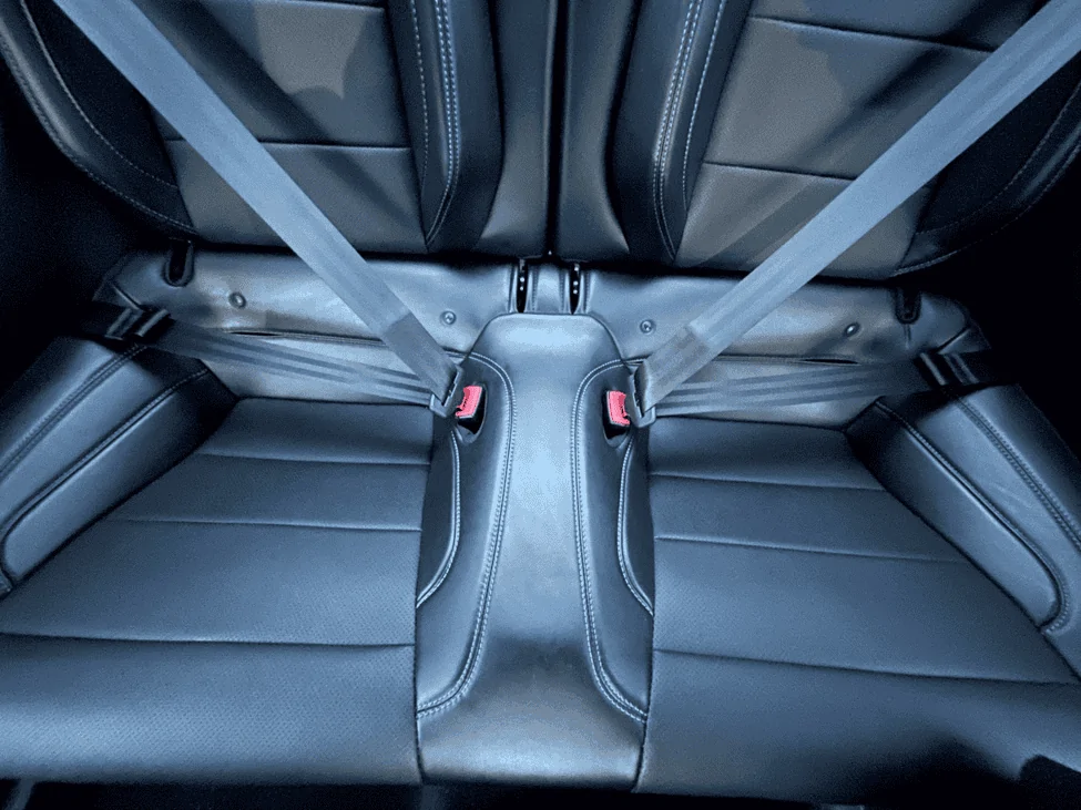

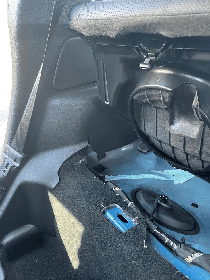

NOTE: Don’t damage the rear seats. There’s a driver side and passenger side release tab. Seats should lift out easily.

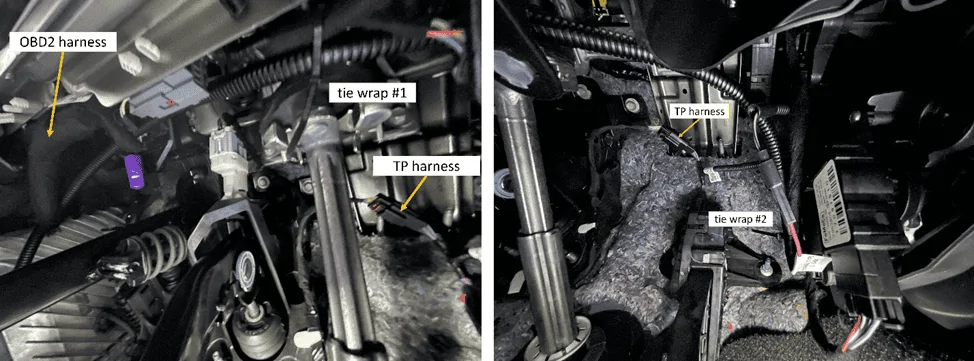

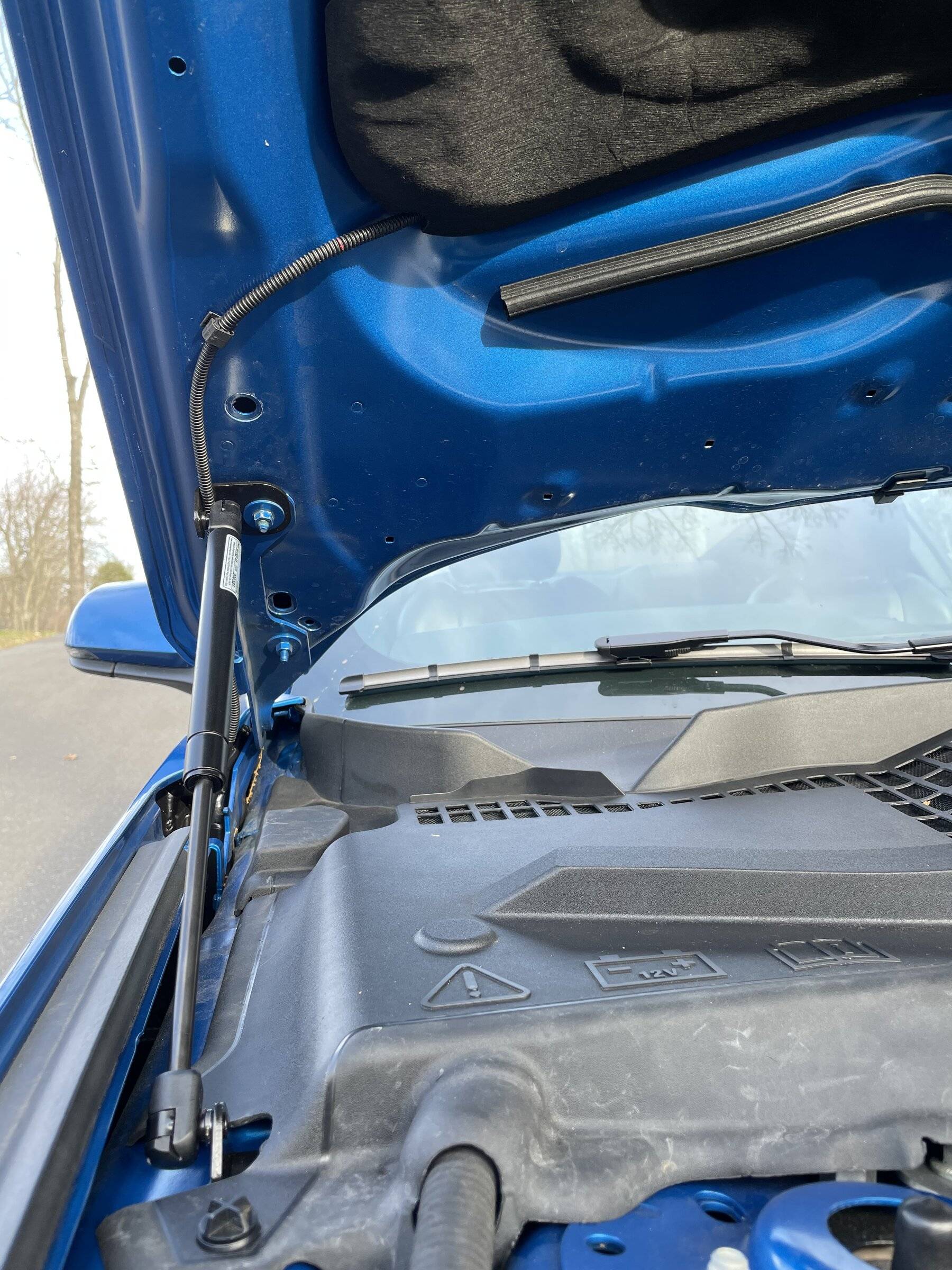

I loosely snaked the throttle position cable behind both the rear and front driver side seat belt mount points. I held off on tucking the cable behind the plastics to avoid having a coiled mess of cable above my feet.
I ran the TP cable up behind the OBD2 connector harness, then across to the gas pedal. Only needed 2 tie wraps to secure it.
I then tucked the cable behind the plastics working front to back and pulling the cable slack back towards the trunk.
Made my ground connection on the pump driver harness mounting stud by removing the paint from the threads with a wire brush and added a ¼” flat washer. I then secured the wiring to prevent rattling and pulled any remaining cable slack through to the trunk.
I secured the excess cable to prevent rattling and pinch points and reinstalled all of the trunk plastic and insulation that I removed.
I was able to fit the 4 pin cable for the optional remote voltage knob into the cable sheath and neatly tape the connector. I secured the control cable with 2 tie wraps and 3M mounts.
I found it easiest to buckle the seat belts while reinstalling the rear seats.
My booster came preprogrammed:
  • 14.5v to 18v output
  • 2.4v input trigger
  • 0.8v ramp
JMS confirmed that these are the optimal settings for the Roush SC making 12 psi. Surprisingly JMS also confirmed that it’s okay to run these settings with the car stock until the blower arrives. I still may turn the adjustable output voltage down to 0 until the blower is installed.

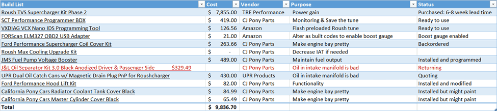

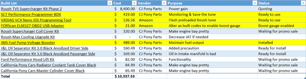

These price increases are insane.. I’m back within the $10k budget thanks to TRE performance! I got Phase 2 Roushcharger kit for $7,855 shipped. CJPP and AM are at ~$8,900 after tax with the latest price bump.
I’m returning the J&L 3.0 dual oil catch can kit:
The original game plan was to modify the J&L catch cans to fit with the blower. The material cost to modify the J&L’s mounting and plumbing makes the extra $100 for the plug and play UPR 5030-260-1-CSCC dual kit well worth it. Plus I think I like UPR filtration design better. The mounting hardware is a bit clunky looking through.

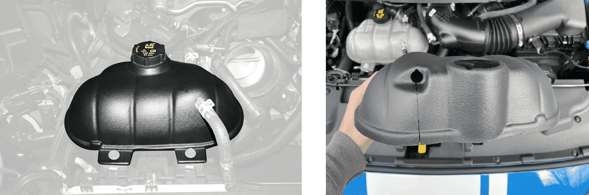

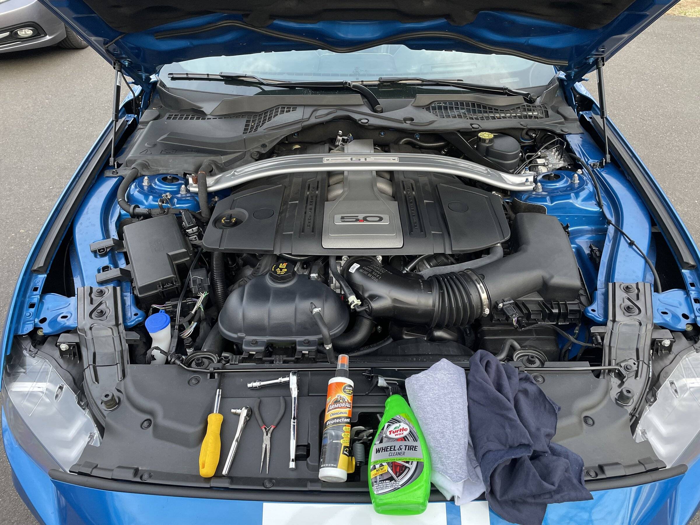

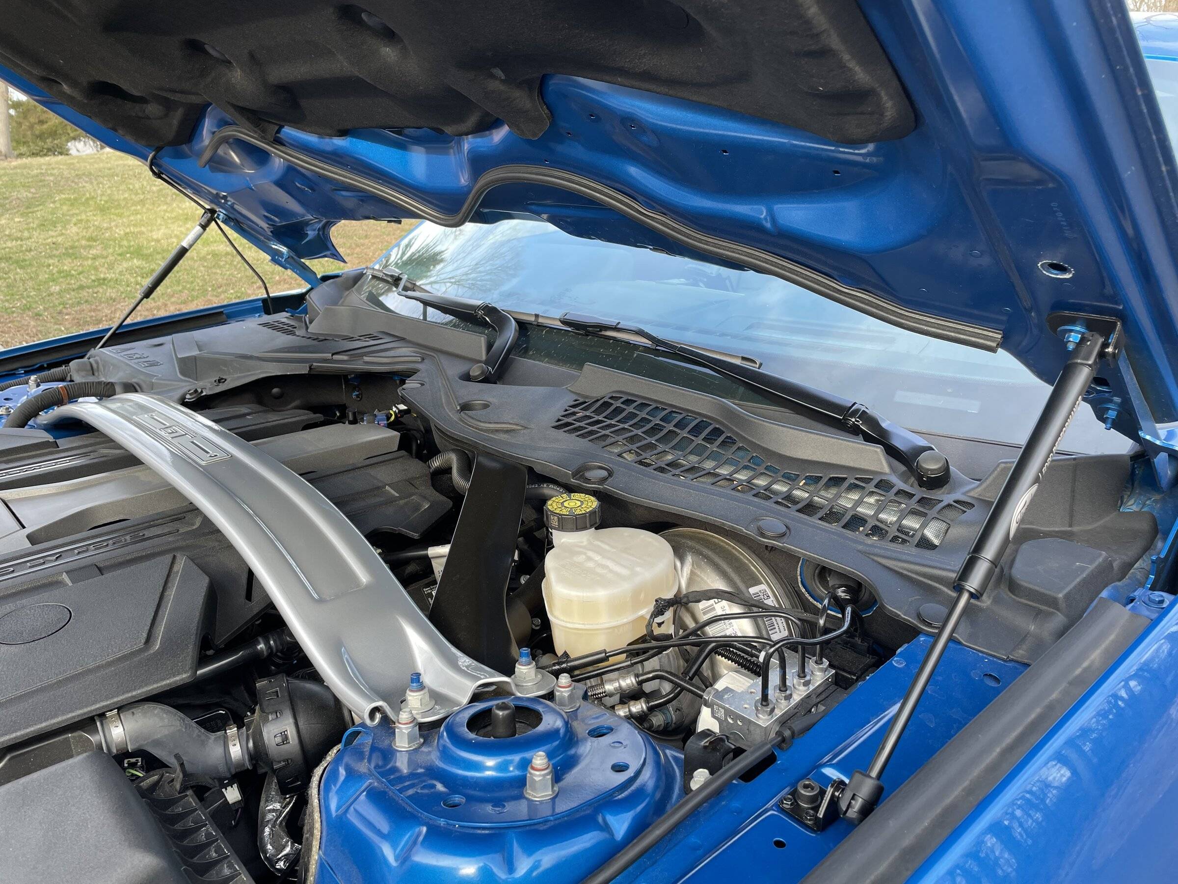

Installed: California Pony Cars Master Cylinder/ Radiator Overflow Tank Cover Kit Black
Meh..
The ENG-156-332 master cylinder tank cover is okay, but the ENG-015-333 coolant expansion tank cover isn't even close to the color advertised. I may spray them both with Rust-Oleum Truck Bed Coating for a black powder coated look.
Armor All darkened them slightly. I used tire cleaner to remove the smudged white paint markings from the hoses.
The coolant expansion tank cover also a has a split down the back for install which is not shown in the advertised pictures. I wouldn't install or remove this on a cold day. It needs a ton of flex at the split to pass the back nipple.

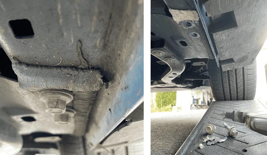

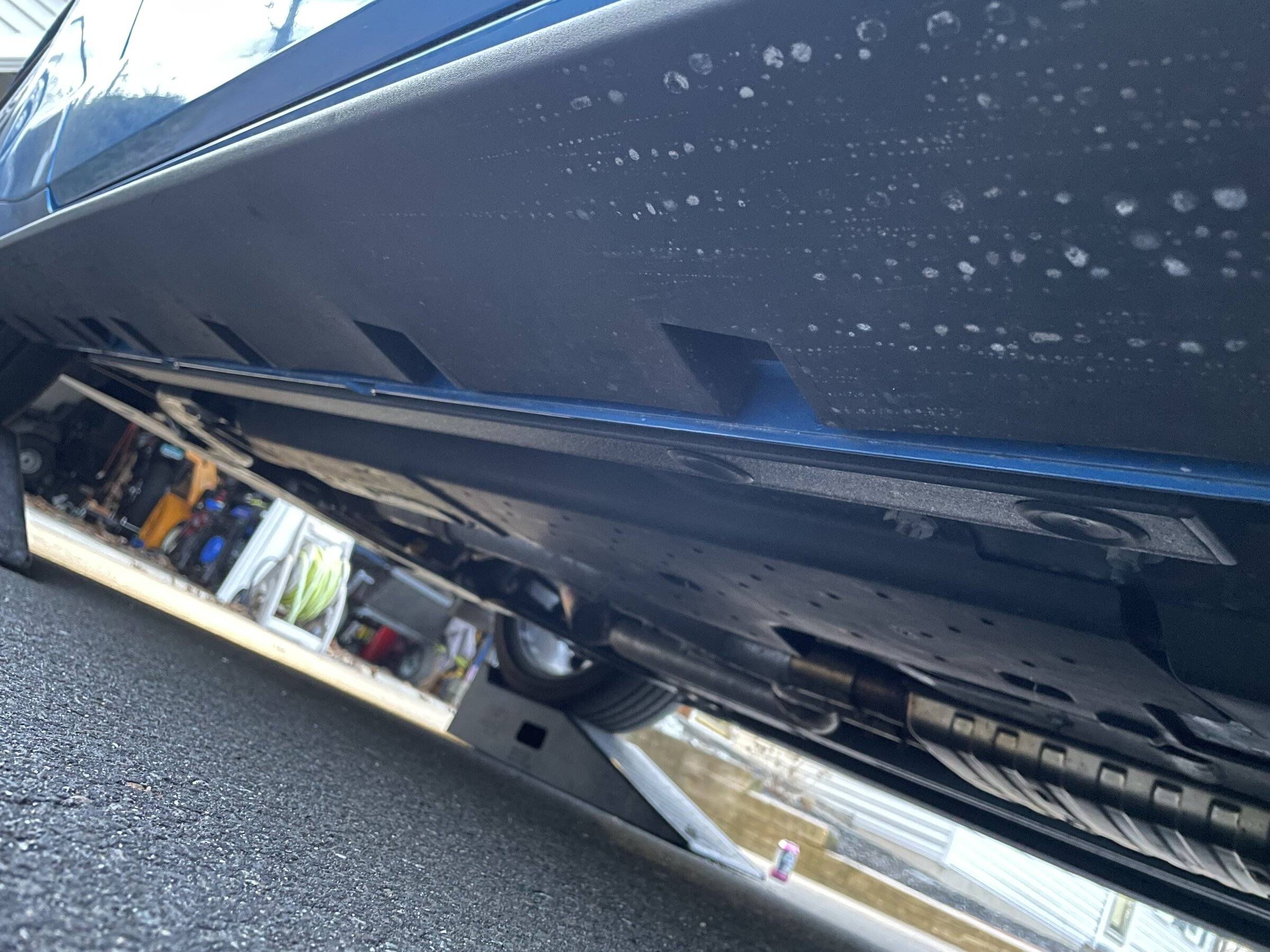

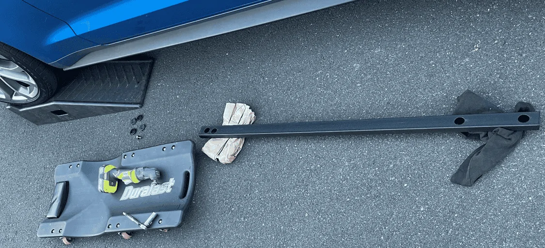

Installed: Steeda Chassis Jacking Rail Ultra-Lite Low-Profile
CJ Pony's install video is good.
The install is doable with 8" ramps.
I only used 2 of the Steeda short bolts and reused the factory hardware.
There were large blobs of seam sealer on both sides. A multi tool blade removed it quick.
I wish Steeda included extra plugs. Plug part number for future reference.

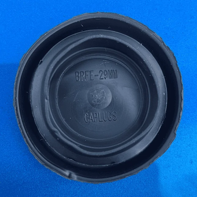

Also purchased 4 packs of:
I'm getting very tired of finding busted and missing plastic clips on this car. It had 4k miles from a 12 month lease when I bought it. Ford service tech carelessness...
