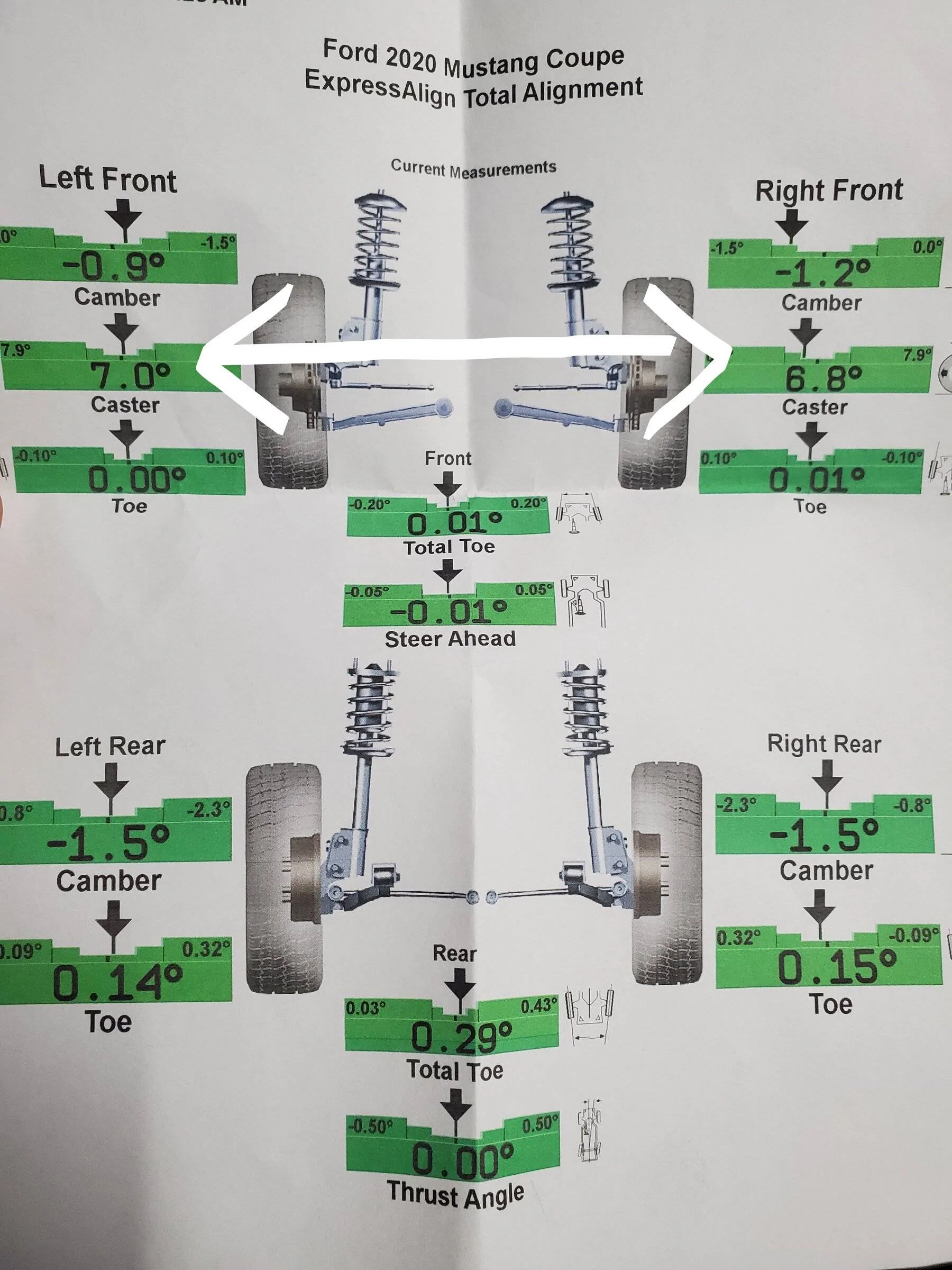

Are front camber and caster differences pretty normal then for stock suspension from factory?
My front cambers have always been 0.2 to 0.3 apart from each other even after proper alignments, obviously would be better if they mirrored each other more at like -1.3
My LF caster right now is at 7.0 and RF caster is 6.8, hoping that difference is fine too?
Yes that's pretty normal.
