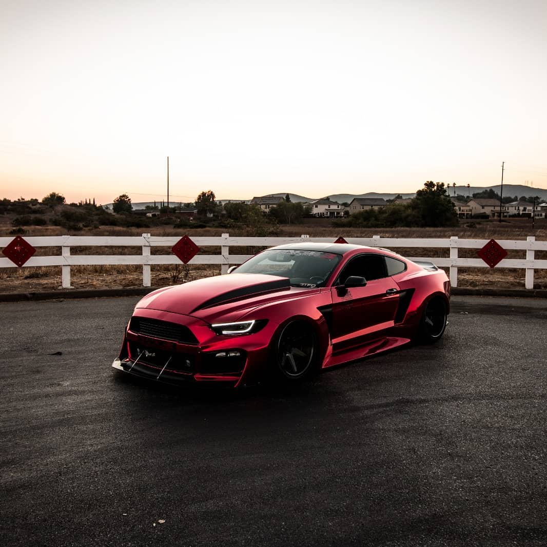

- Stage3Performance v2 widebody kit.
- Chrome red vinyl wrap.

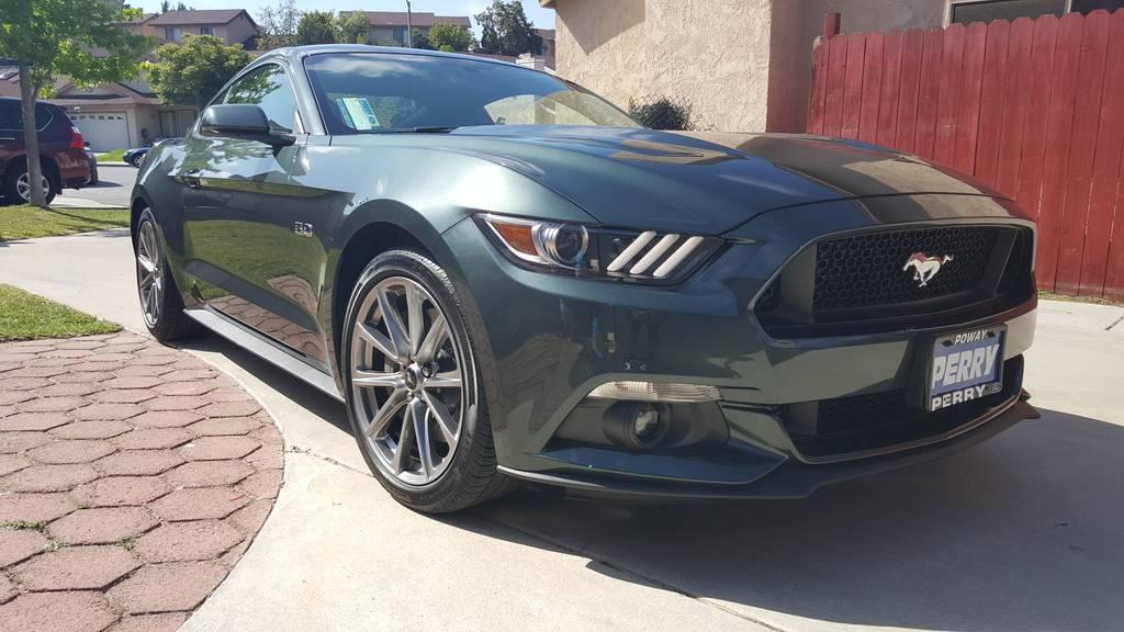

Picked up my 2015 GT premium in Guard Metallic 5-19-15

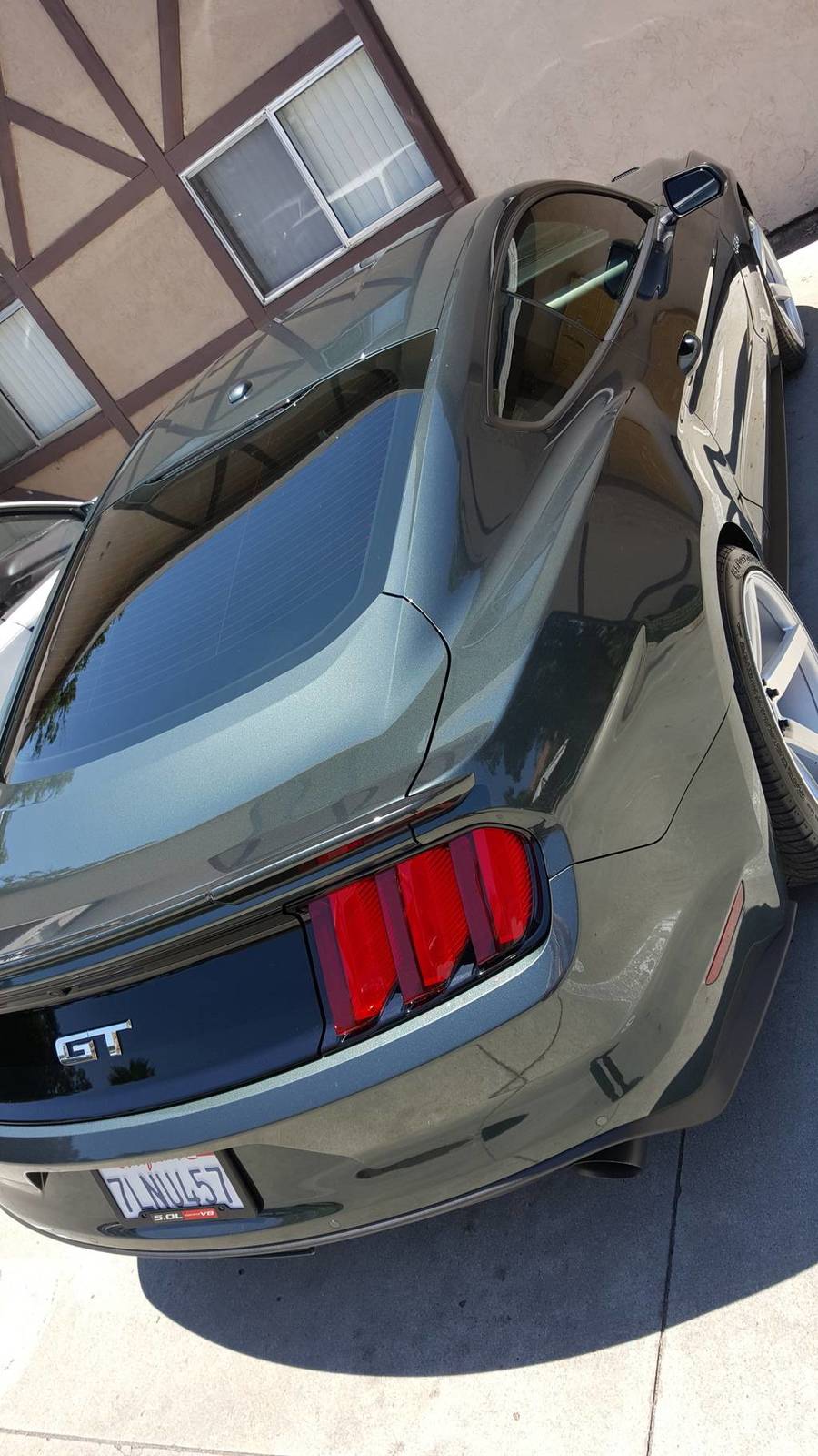

Tinted the windows.
5% rear 3 windows.
30% in the 2 front windows.

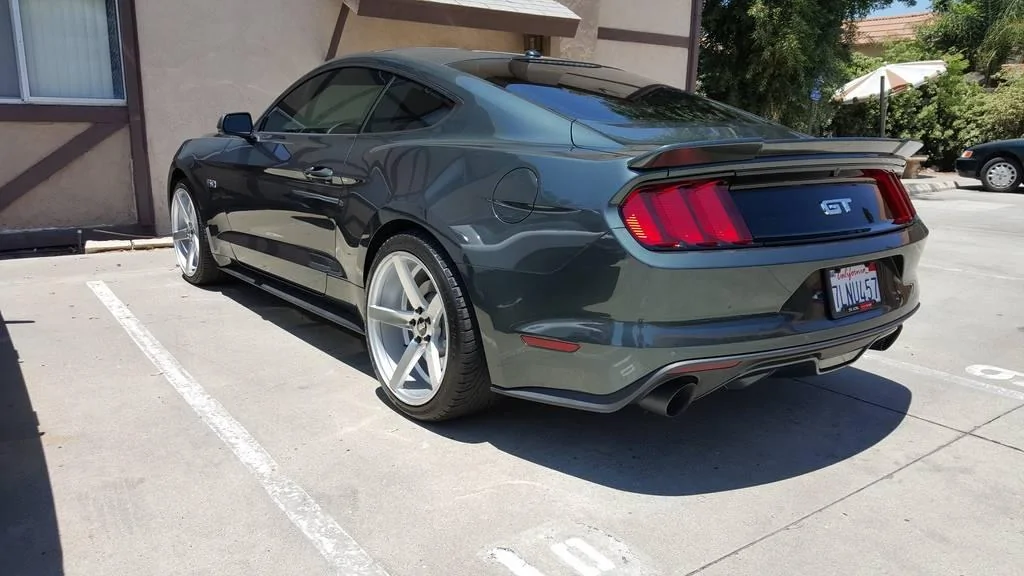

Color matched Roush Spoiler!
Gibson full cat back exhaust with black tips!

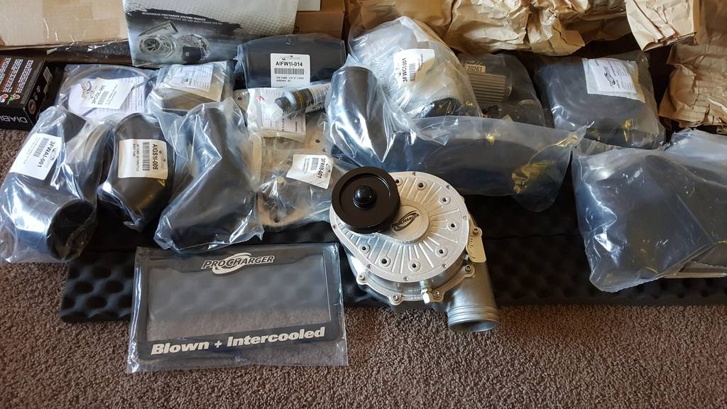

Received my Beefcake special Procharger H.O P1SC Kit with heli cut gears!

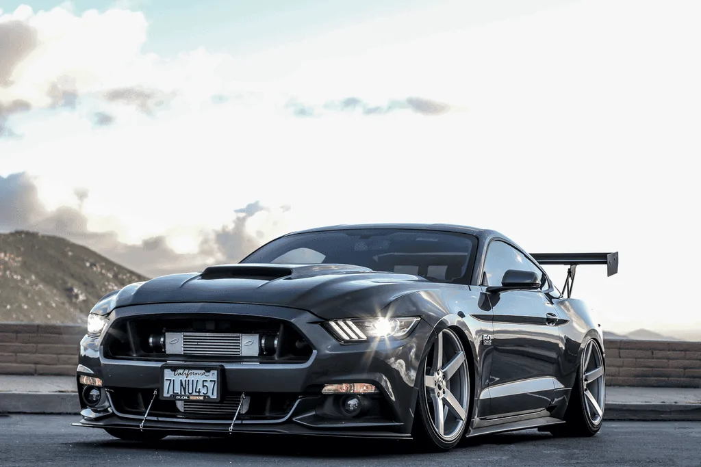

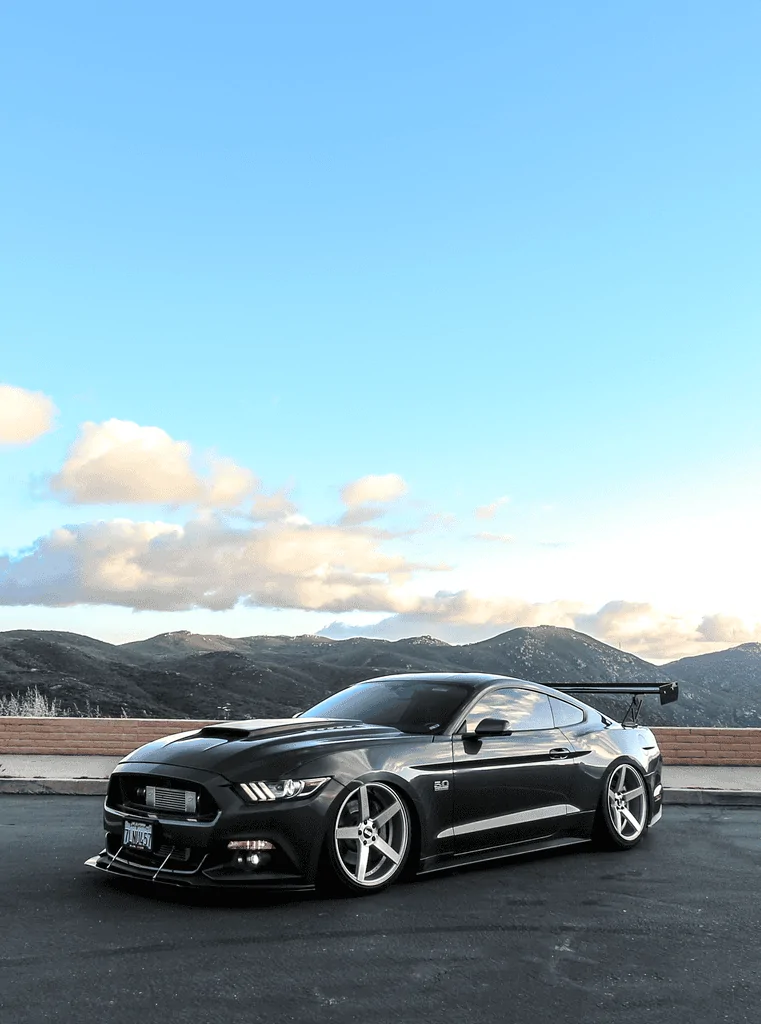

Got the Airlift V2 Digital Kit!
loving it so far! Here are some pictures!
