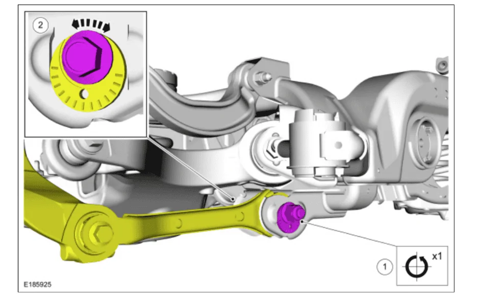

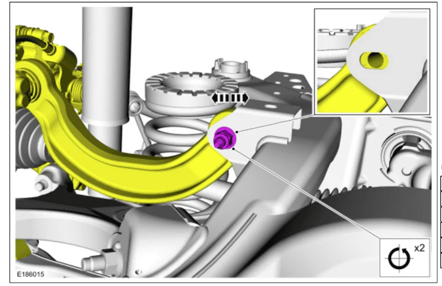

There is a lot of alignment information on the forum. What I learned is that wear on the inside edge can be due to toe settings more than camber. Front camber is not adjustable unless you modify the stock setup, and the rear camber adjustment is hard to find if you don't know where to look. Someone was kind enough to post these diagrams a while back, and the guy who did my alignment really appreciated them.
Rear camber:
Rear toe:
