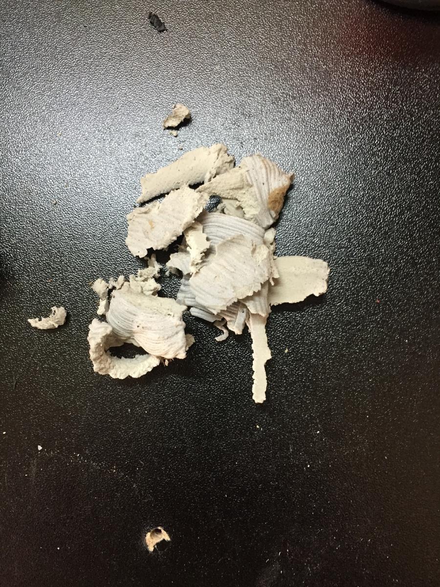

Installed mine today. Both sides I had to scrap off the extra putty/sealer/adhesive whatever it is called near the two bolts toward the front of the car. The rails would not lay flush with out doing this. It appears to be over application of the material and nothing is harmed by scraping it away. The jacking rails cover the area anyway. It was not bonded to the paint in anyway, just where it had been forced out from the seams.
The only somewhat of an issue I had was on the driver's side. For some reason the last bolt on the rear was not quite lined up 100%. I had to squeeze the rail against the pinch weld area as hard as possible to get it to start without cross threading. Once started, no problem. Passenger side was no issue. I did this with the car on the ground.
The pic is a pic of the material I scrapped off. This was from the driver's side. Passenger side had the same amount. It did not require hardly any force. I used a scrapping tool and it came off rather easily. For scale the piece top right with the tan on it is about the size of a dime.

Yeah, some are lucky & there isn't as much crud to scrape off.
Glad it worked out!

Went to put mine on today and in the process said a few swear words for being sent the wrong rails before I realized there are two extra holes back of the ones that fit the rail and that is where the factory bolts were as I was on the ground and couldn't see all the holes. Used the factory bolts for the rails and the Steeda bolts in the other holes for "spares". BTW scraping that crud off was not easy.
Glad you figured it out. The "crap" was not too hard on mine but I had a scraping tool with a handle and it made short work of it for me.
Was yours only just before the front two bolts? My car has an underbody coat over it too so might have to scrape all of that off too :headbonk:
Just the area near the front holes. Mine is a 2017 and it had a decent amount of it but all near the front.

Didn't have to crape any of that seam sealer stuff on mine. :shrug:
