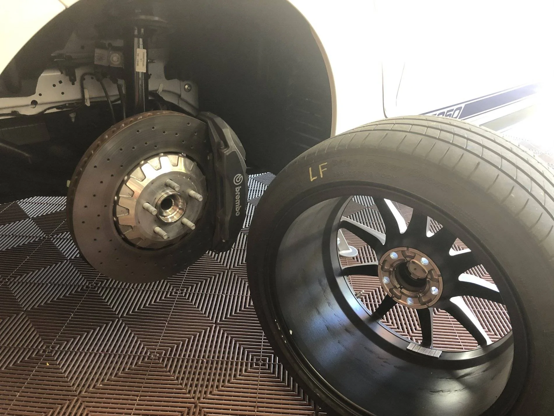

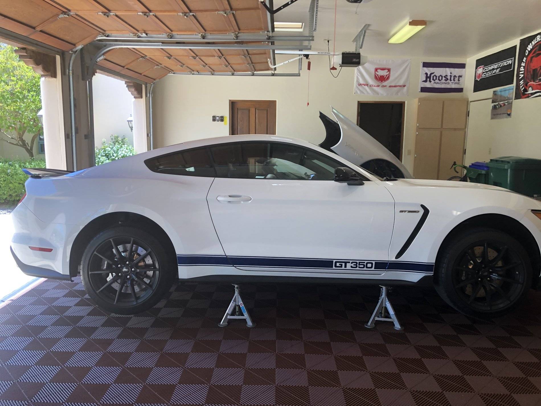

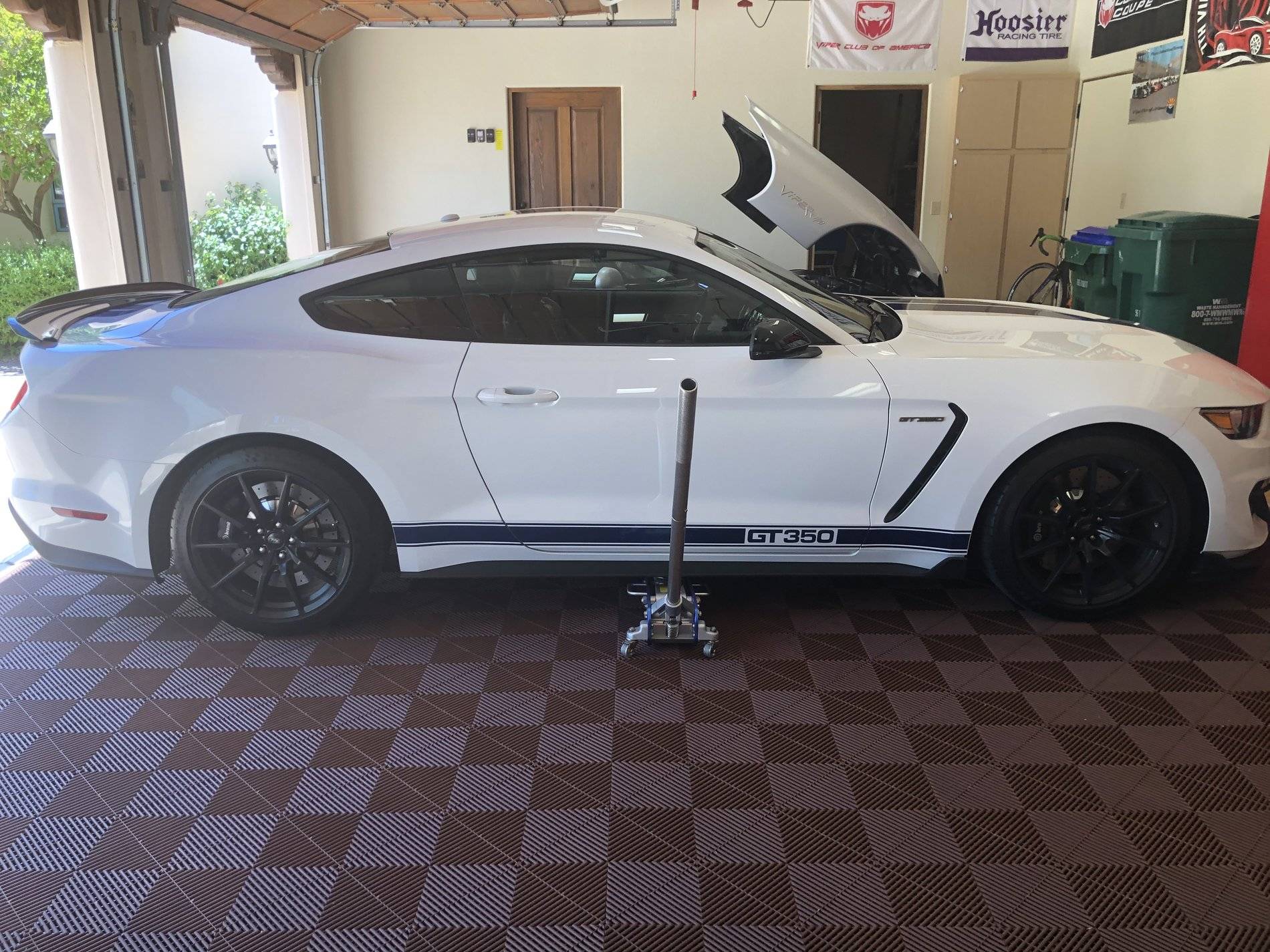

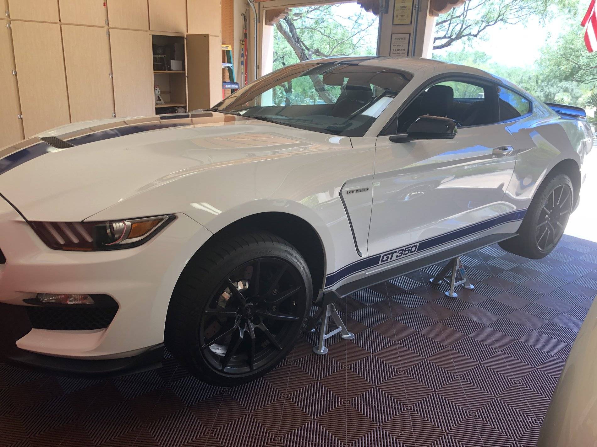

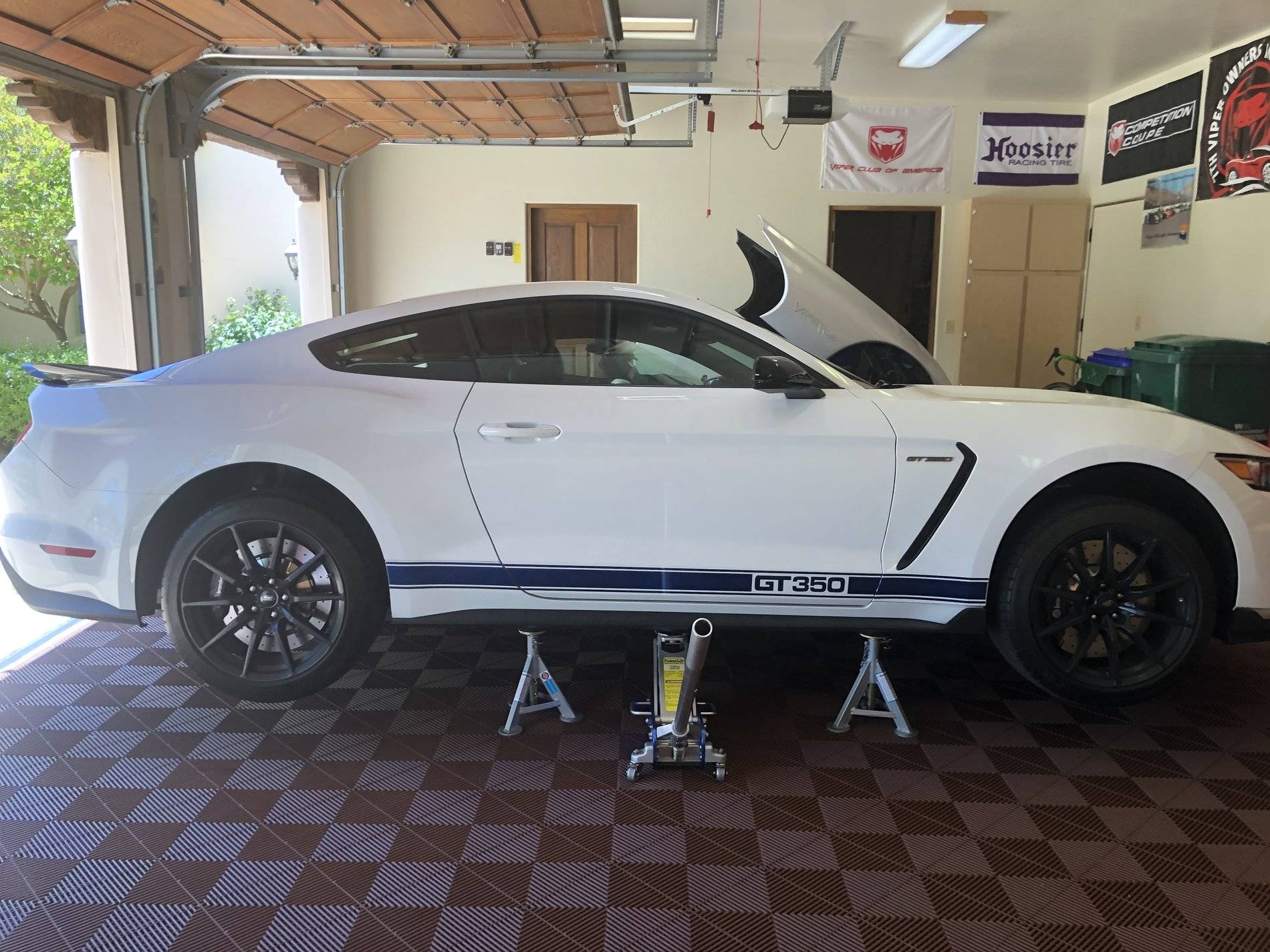

Place the jack in the middle of the rail. Jacking will lift both front and rear enough to place jack stands in the factory designated position, both front and rear. Do one side at a time. Jack stands under all 4 corners before you get underneath the car. Perfect time to remove all 4 wheels to clean thoroughly, also clean the wheel wells, suspension, frame rail, etc. Living in the desert, the bottom of the car is easy to maintain in showroom condition.
