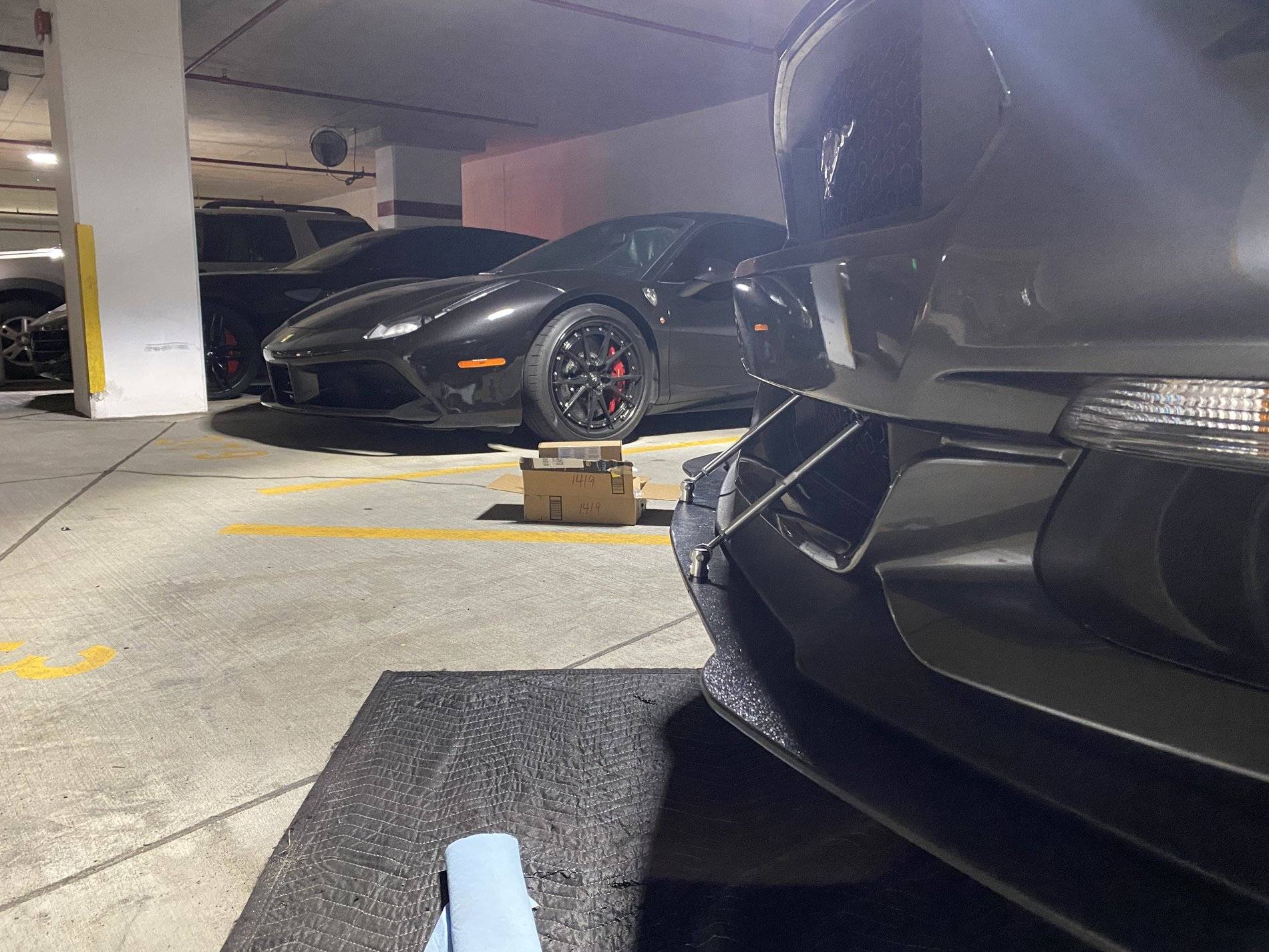

Yes sir! Everything is done in the apartment garage. I'm just fortunate its an underground garage that's not at full capacity. When I was in my studio unit, I had a nice parts corner going on.

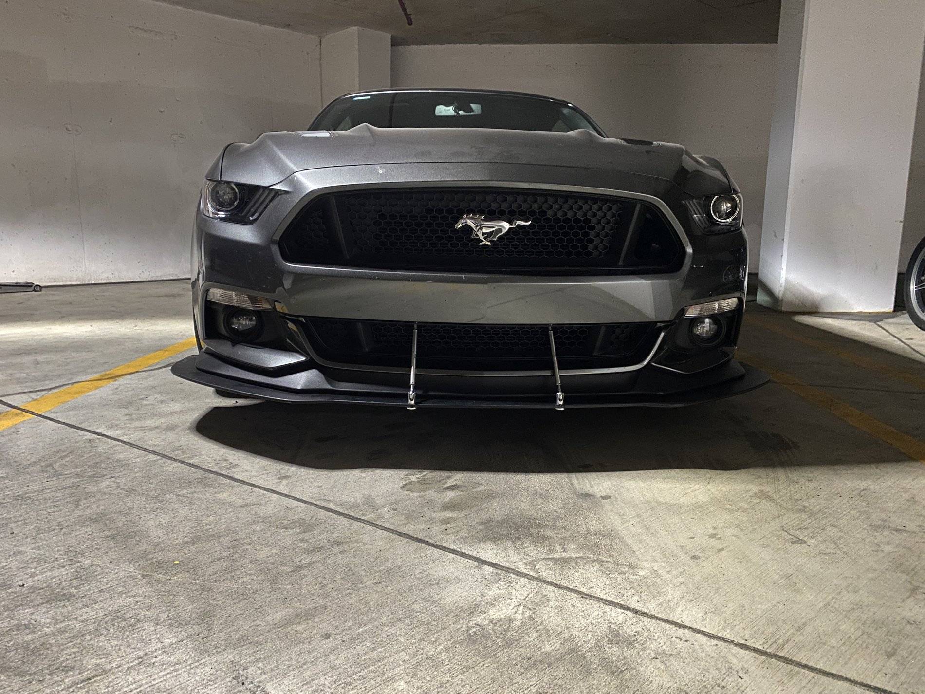

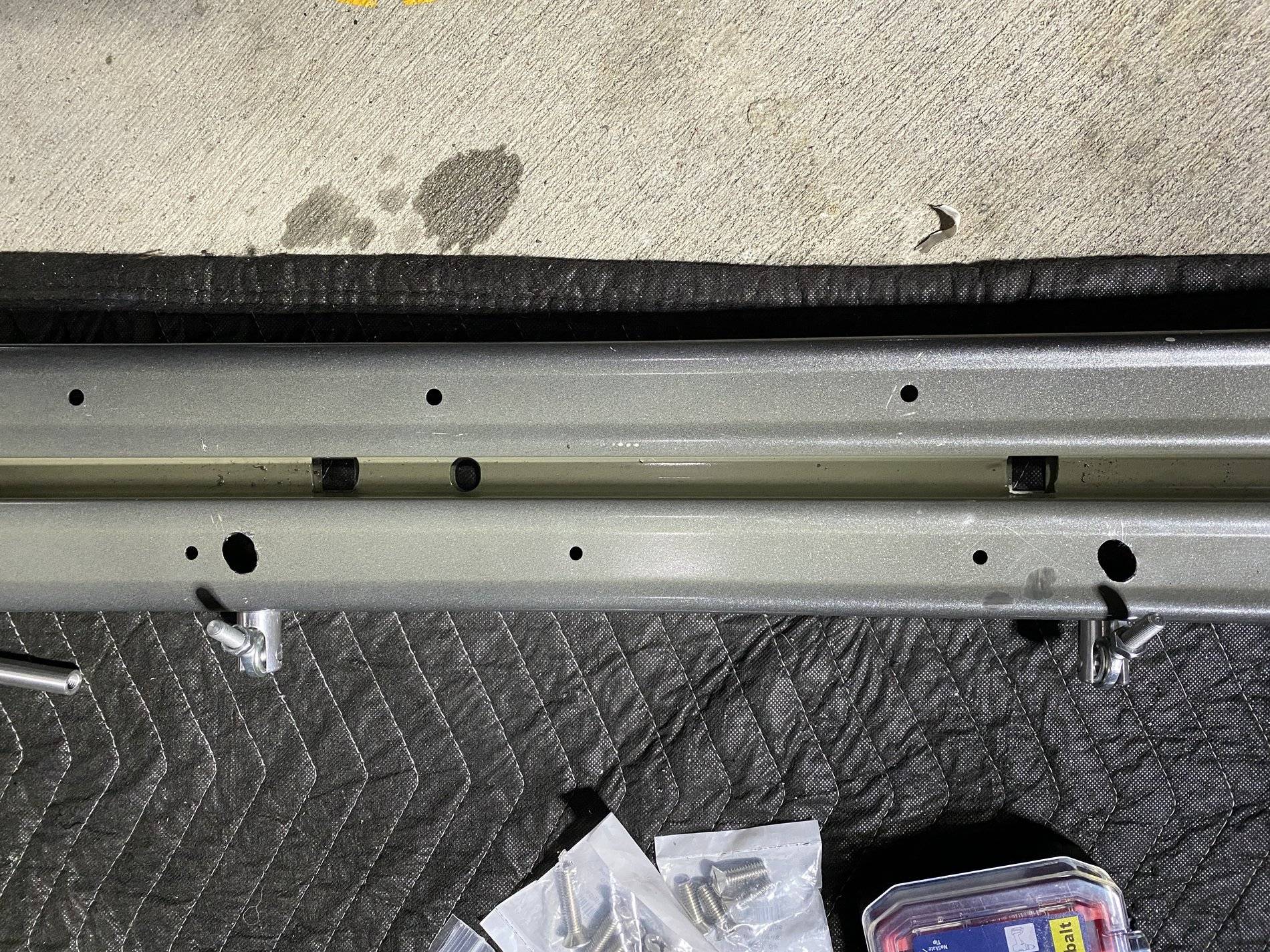

Okay so I made my second and final attempt to mount the splitter rods to the crash bar. This attempt took me about 6 days so you can imagine that my patience was tested. To spare a long story, I am happy with the results and now I know on the track my splitter isn't going anywhere. I posted the link to Jeff's video that I followed but I definitely had a harder time than he did.
I ended up taking off the bar to drill the holes instead of doing it with it on the car. Instead of of drilling holes fro the top-down, I had a shop drill holes behind the bar so I could access the the top bolts.

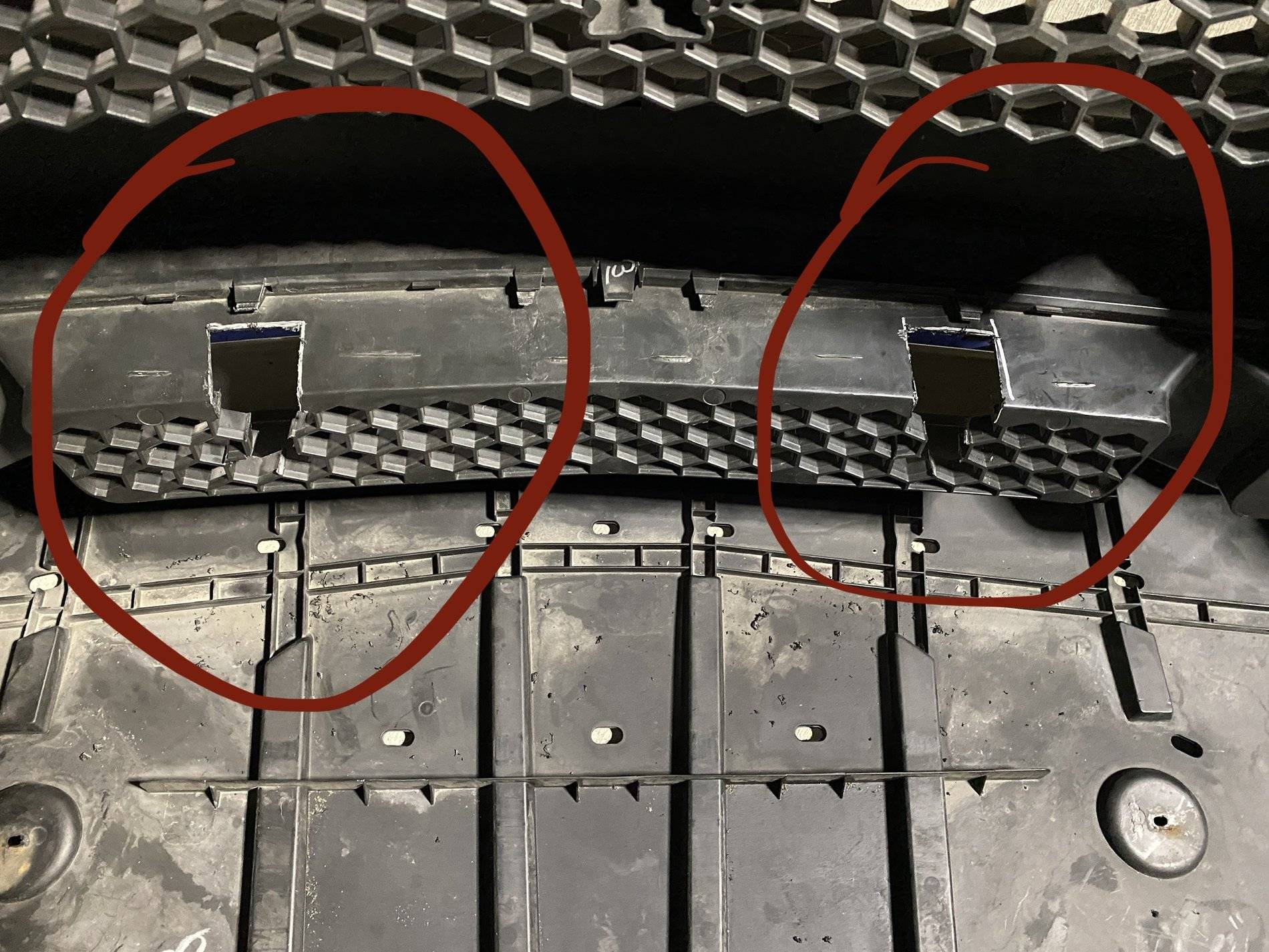

Next I mounted the top bolts and put the bar back on the car. Made holes in the lower grille but it was interfering with the top end of the rod so i had to dremel out a section of the lower grille to get access to the top of the rods.
I put the bumper back on and made measurements to drill into the splitter. I tried the best I could and its good enough that my OCD won't bother me.

Lol yeaaa as for the Ferraris those both belong to my neighbor...same guy. Before covid he said that he would let me drive the 488 while he drives the FF but that has been postponed.
