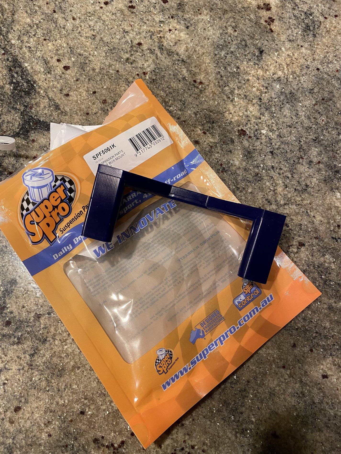

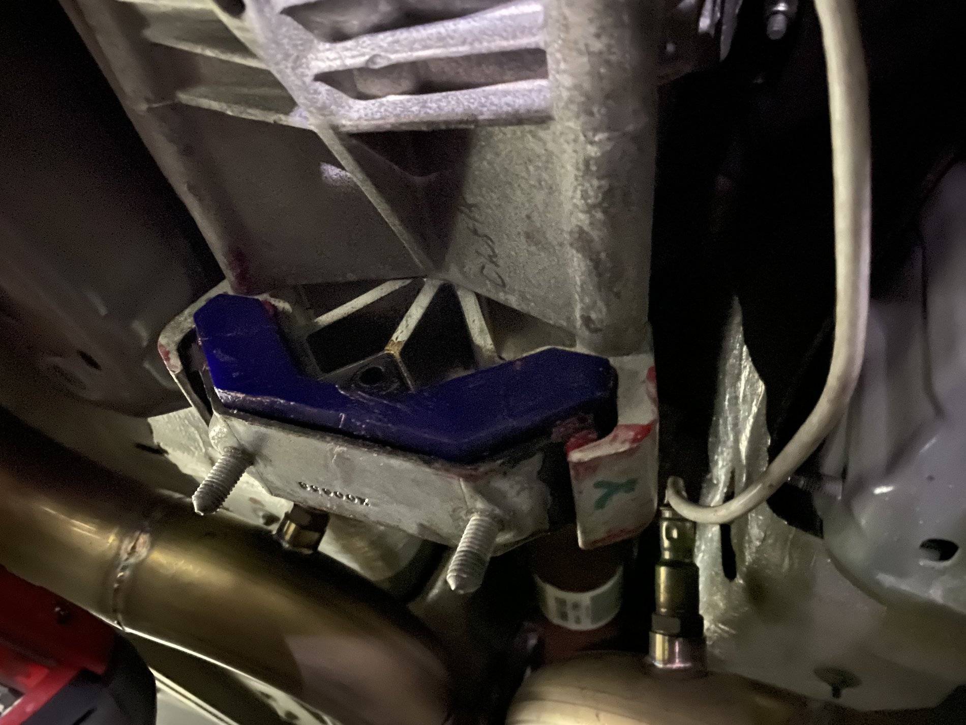

Last week I installed the SuperPro Transmission bushing and shifts feel much better than they did before. I dont have any increase in NVH versus what I already had. Great purchase. Thanks for the recommendation @Brian@BMVK

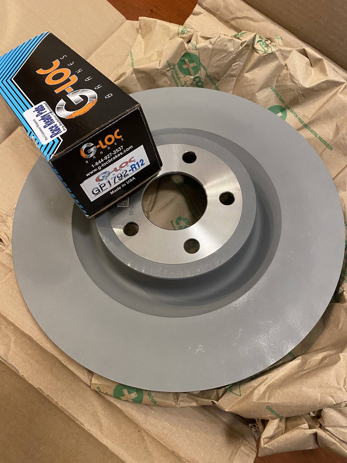

Went ahead with R12/R10 G-LOC track pads and OEM rotors that I got for a great deal. Will put them to use this weekend at Trackcross event at Summit.

Glad it worked!

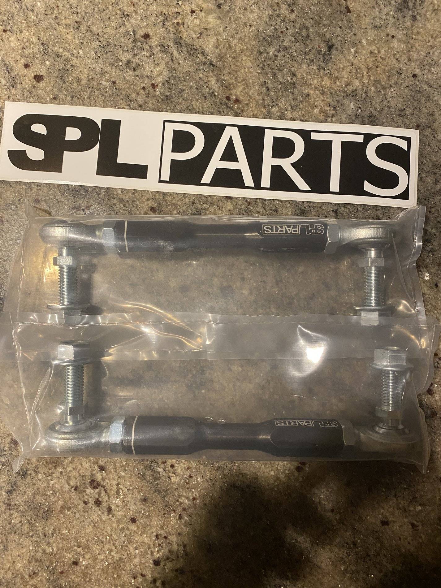

I know itā€™s been some time. No major update but just an FYI for whoever reads this...
if you have the track dampers and steeda end links, the grease fittings hit the struts. I have a dimple in my struts.When I turn at slow speeds I can hear it hitting. I decided enough was enough and got SPL links since they donā€™t use grease fittings.
