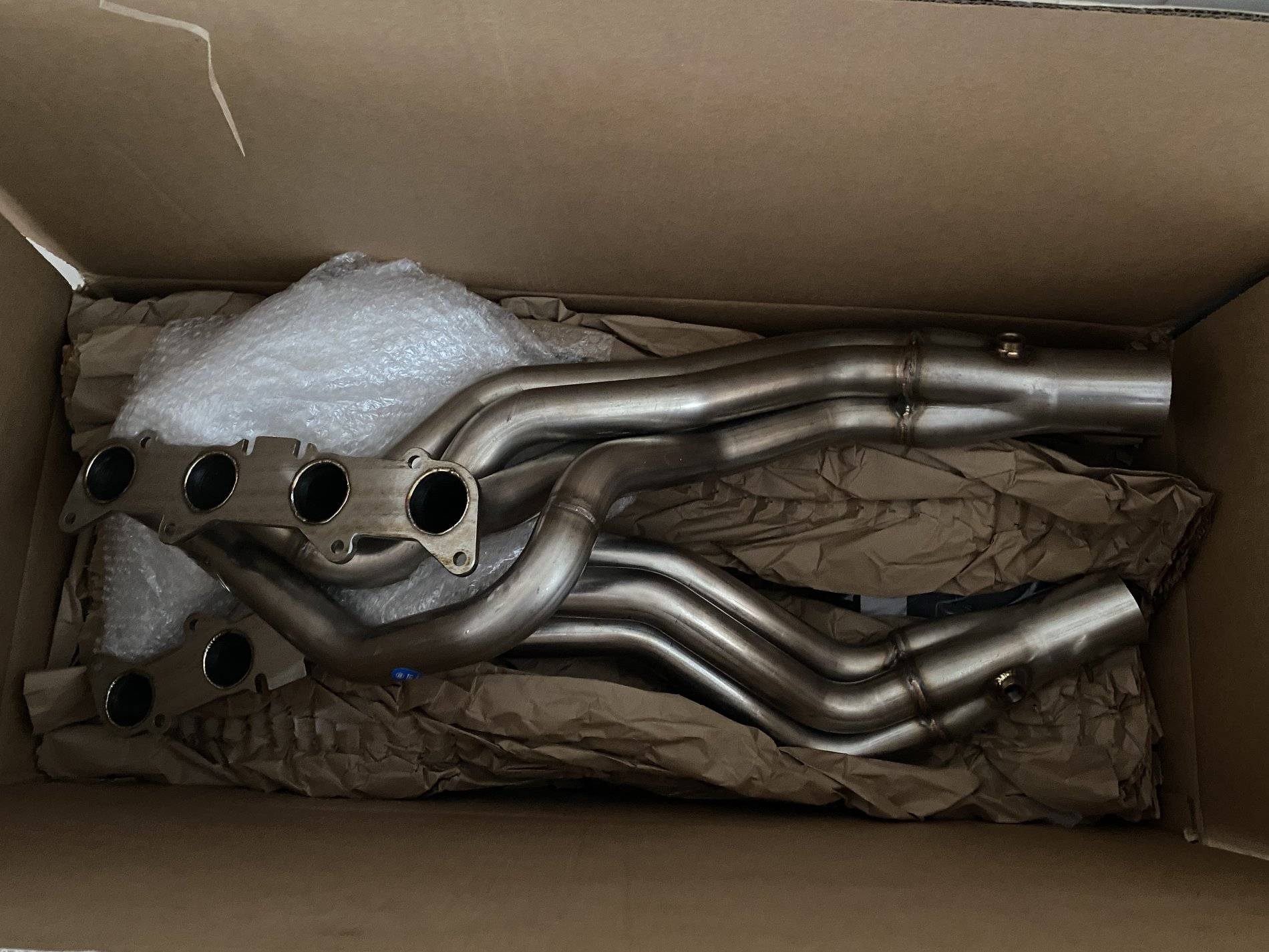

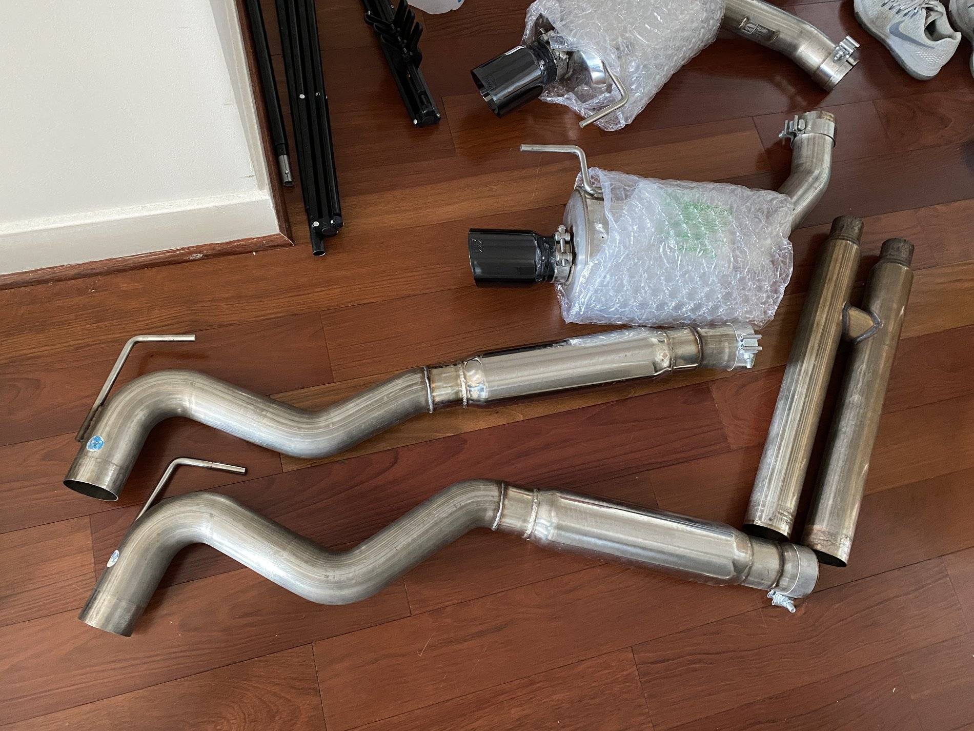

Sooo since we have all this down time I decided to give myself something to do. I got a set of catted SP headers and AWE Touring cat back. Great deal on both.

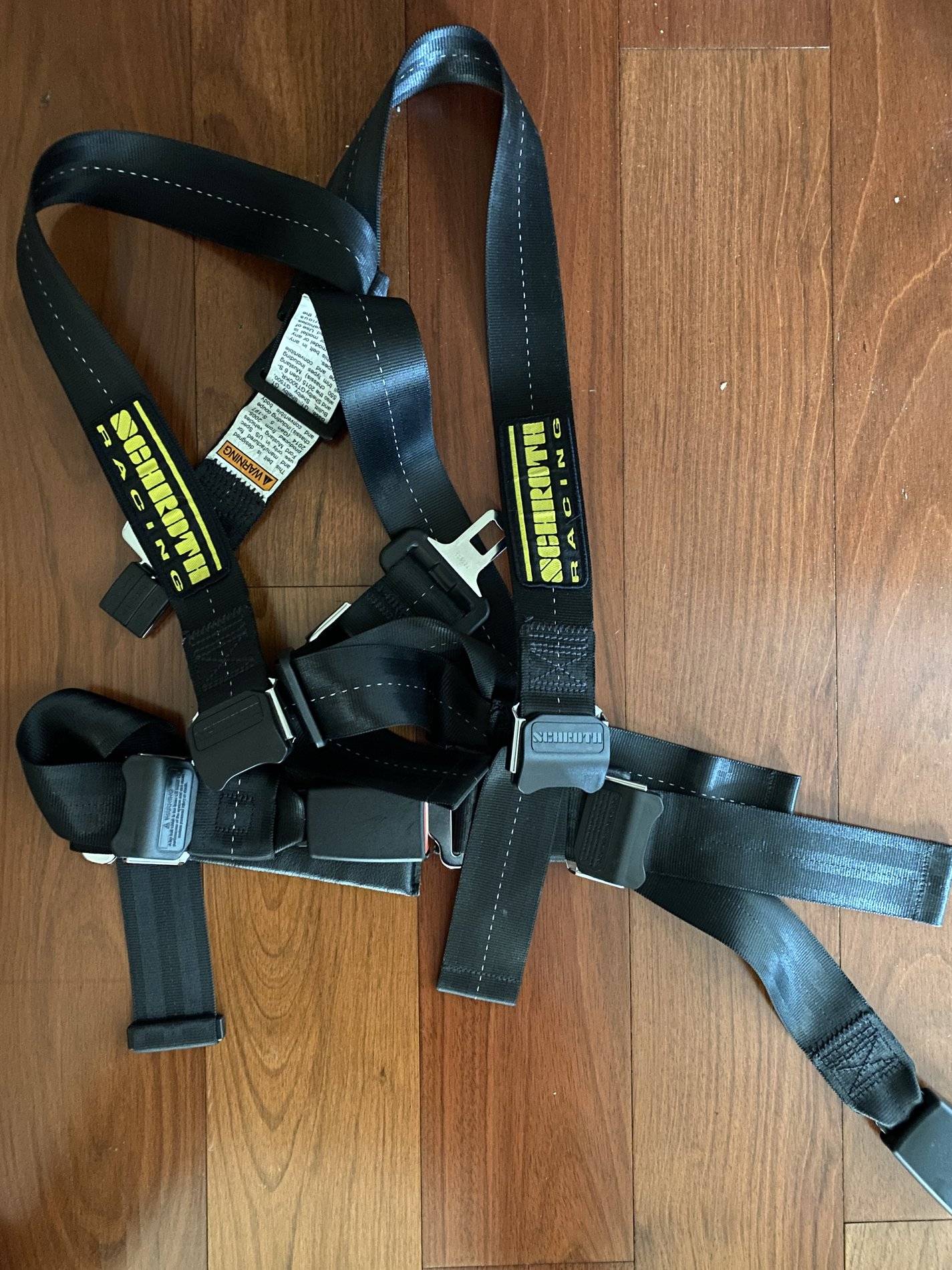

Also to be a little more track prepped, I got a Schroth Quick Fit.
Plan for headers and cat back to go on next week. I just have to re angle the O2 sensors at an exhaust shop so it'll be e85 friendly.

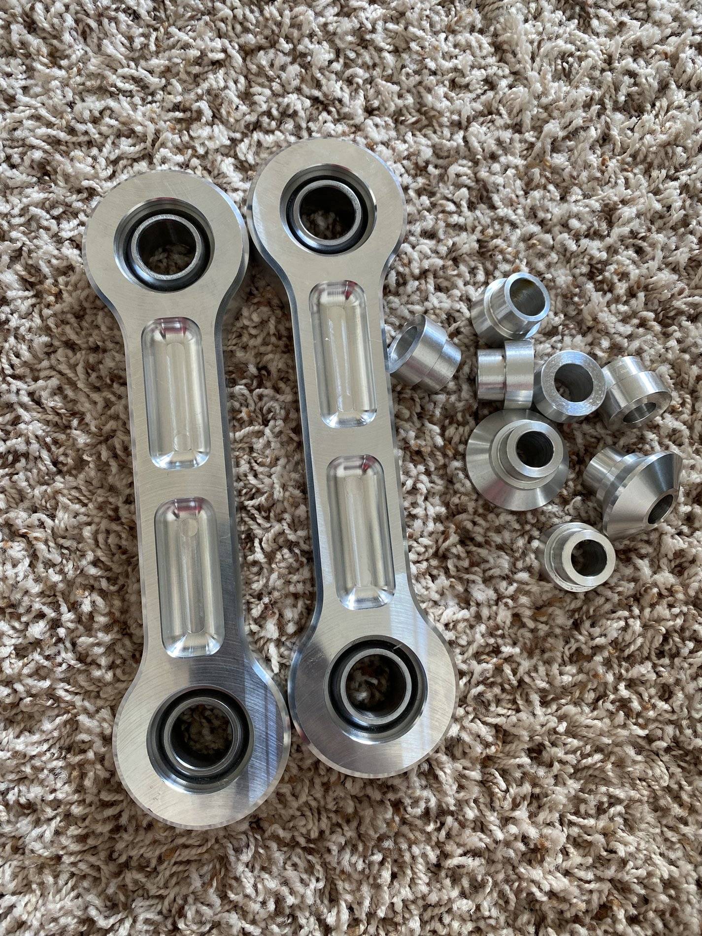

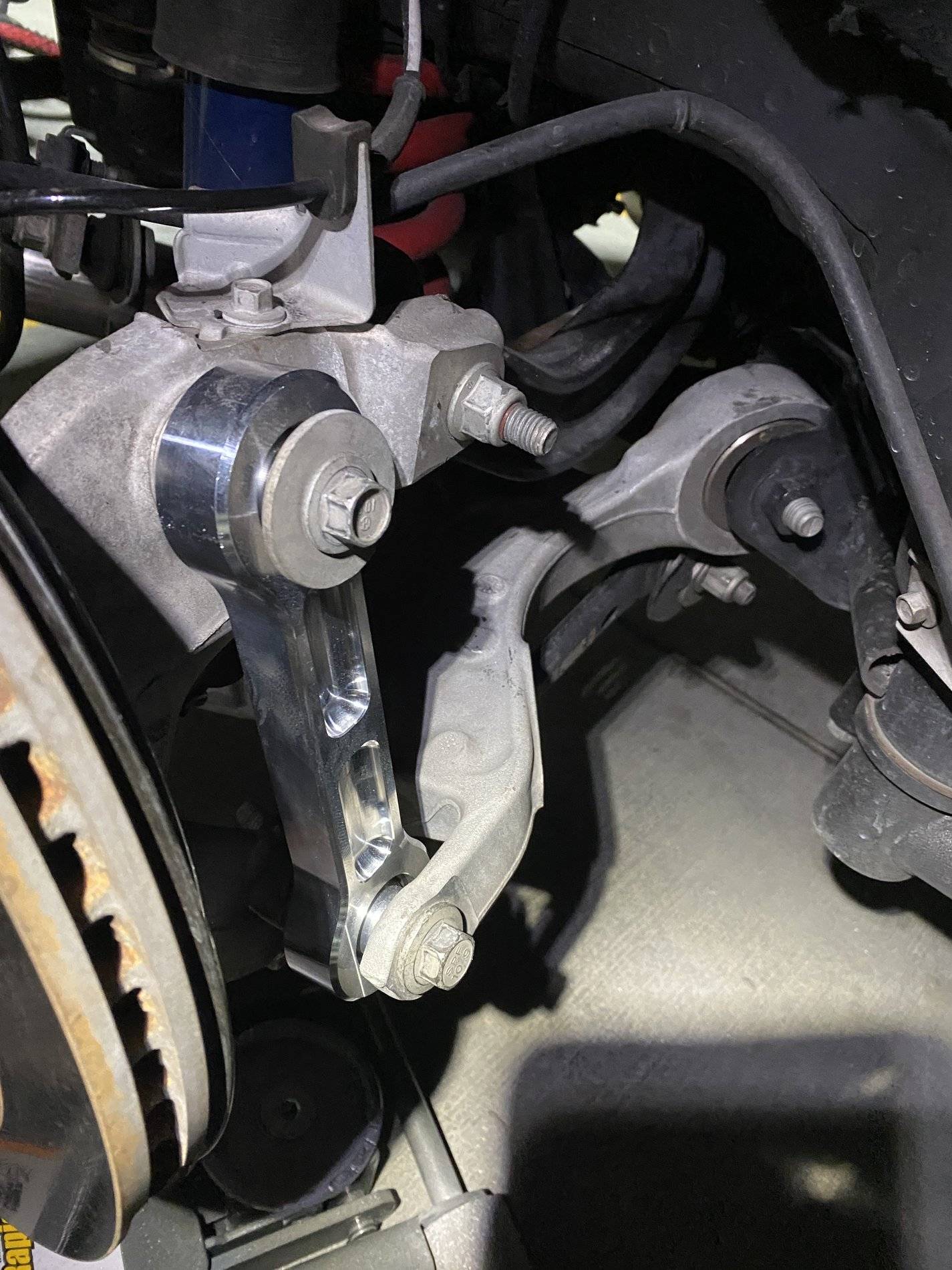

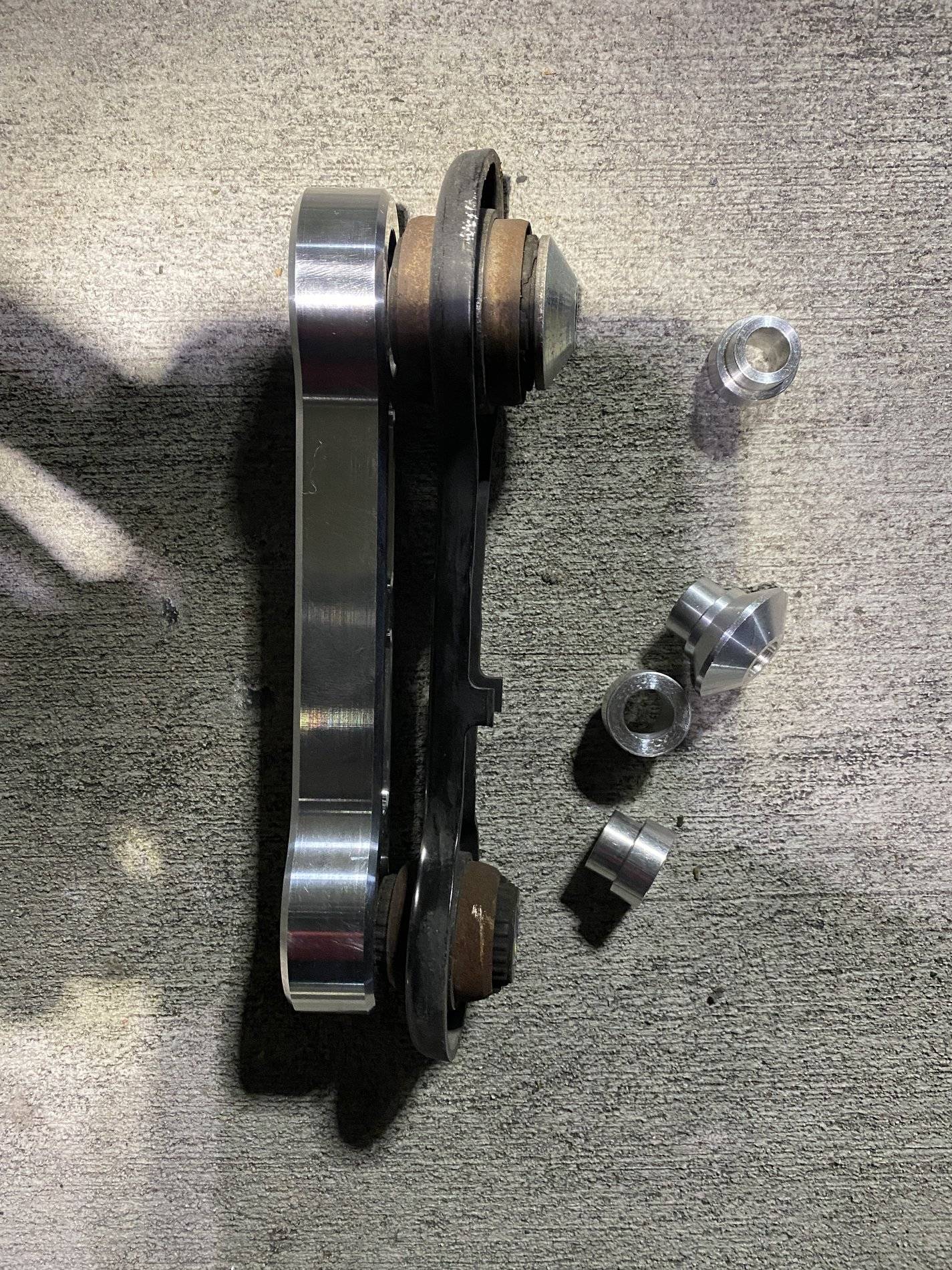

No big progress.
I put on J&M spherical vertical links. Went out for a drive and it seems like I 100% got rid of any wheel hop. It doesn’t drive any differently because of everything I already have. Everything is TIGHT. Can’t wait until warmer days on the track. Sooo that pretty much wraps up any suspension upgrade (except for adjustable rear toe links) that I can do. I don’t even remember what stock suspension feels like.

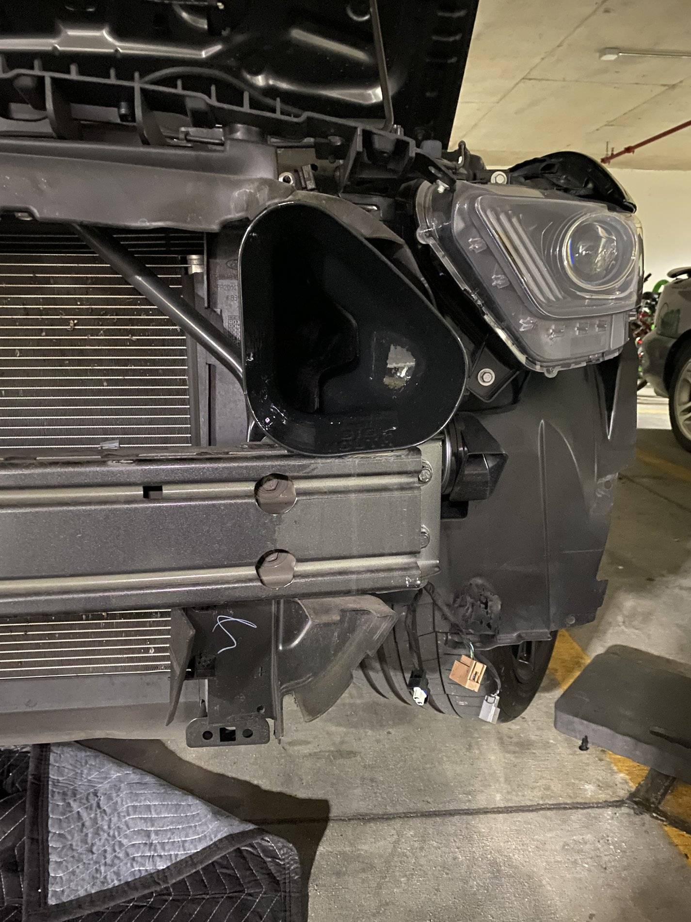

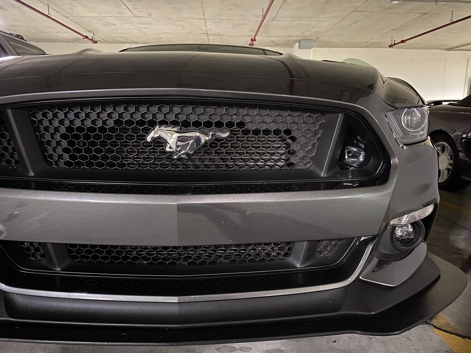

So the rods came in from Fully Torqued. I ordered 10" custom length rods with premium hardware. In case the rods were too long I ordered another rod that is .5" shorter.
So yesterday I had 3 things to get done: Velossa Tech Big Mouth, mount rods to crash bar, add more bolts to the ZL1 splitter to secure it in the corners.
Got the grille cut for the big mouth.
Next, with the rods, there was an issue because they sent out screws that were .75" long but the splitter is 3/8" thick. I went out to Lowes and bought 1" bolts to secure the rods to the splitter.
Jeff Ashton made a video of him installing his splitter to his GT350 and I followed his method of mounting to the crash bar (or at least that was the plan)

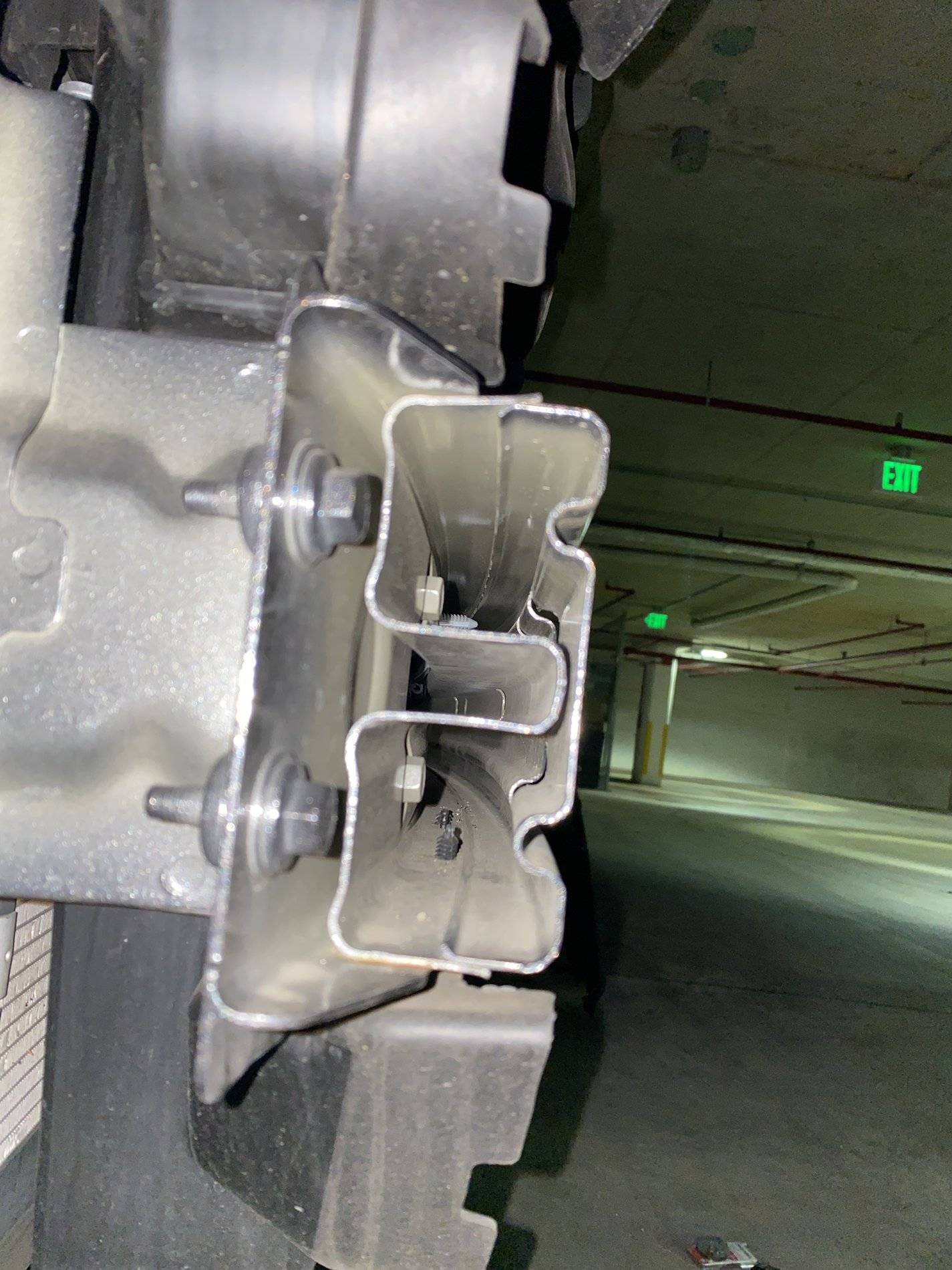

I had trouble drilling into the crash bar. Drill bits were breaking and didn't have much success. I decided that my splitter is good for now especially with the extra bolts. I will try again before my first track day June 21 at Summit Point. At least I got the measurements so to speed up the process, I will try a buy a crash bar and try again with it off the car.
For anybody who is mounting to the crash bar, the measurements are
101cm width
4.5 in tall
~2 in thick
To have access from top to bottom you will need a drill bit thats longer than 2 inches. As you can see the bar folds.
Its not difficult to do and had I used a stronger, better bit, I wouldve finished.

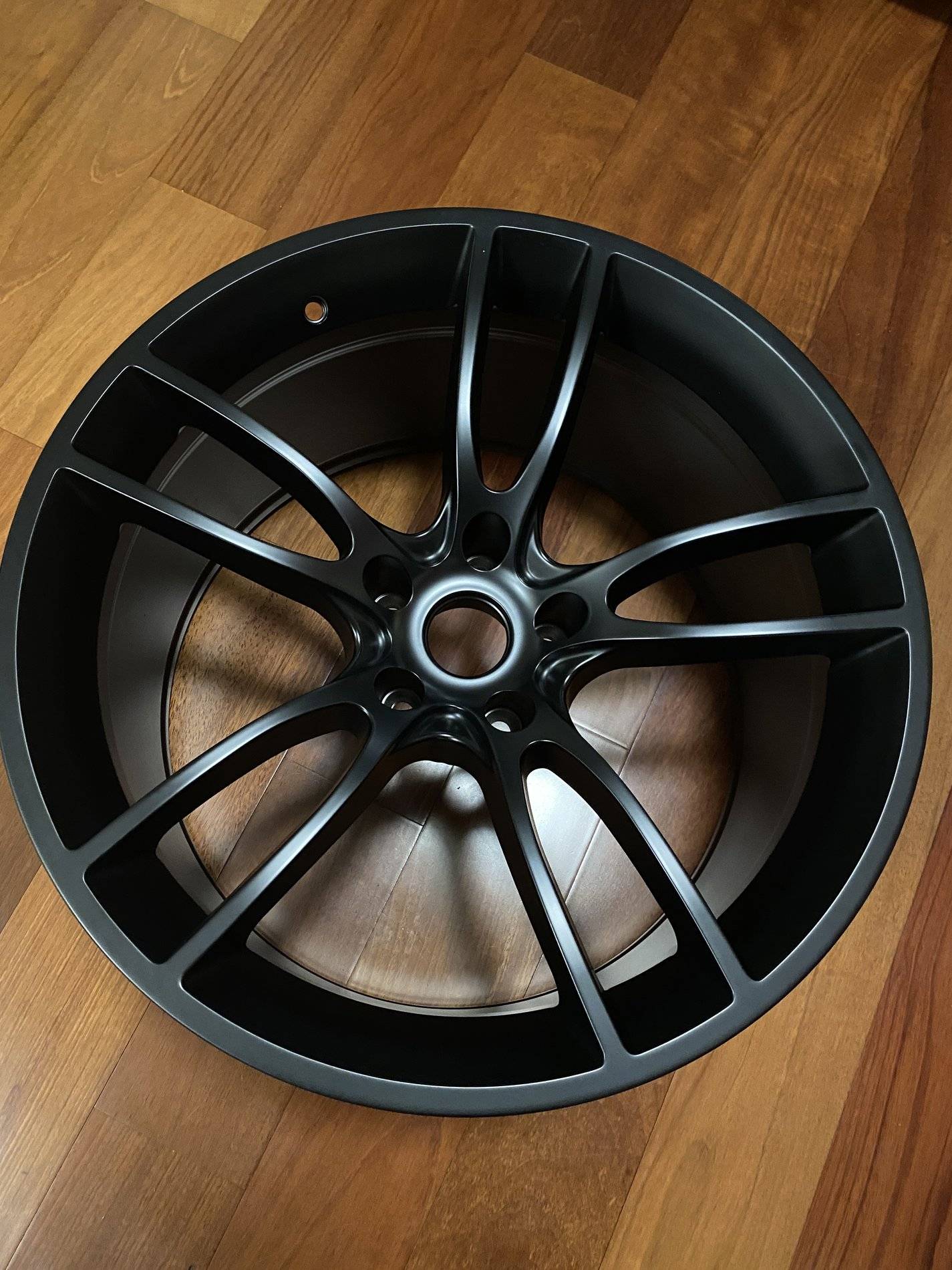

Lol I blame @Bluemustang and @BmacIL for this purchase
MRR M600 19x11 squared (+24/+50 staggered offsets)
