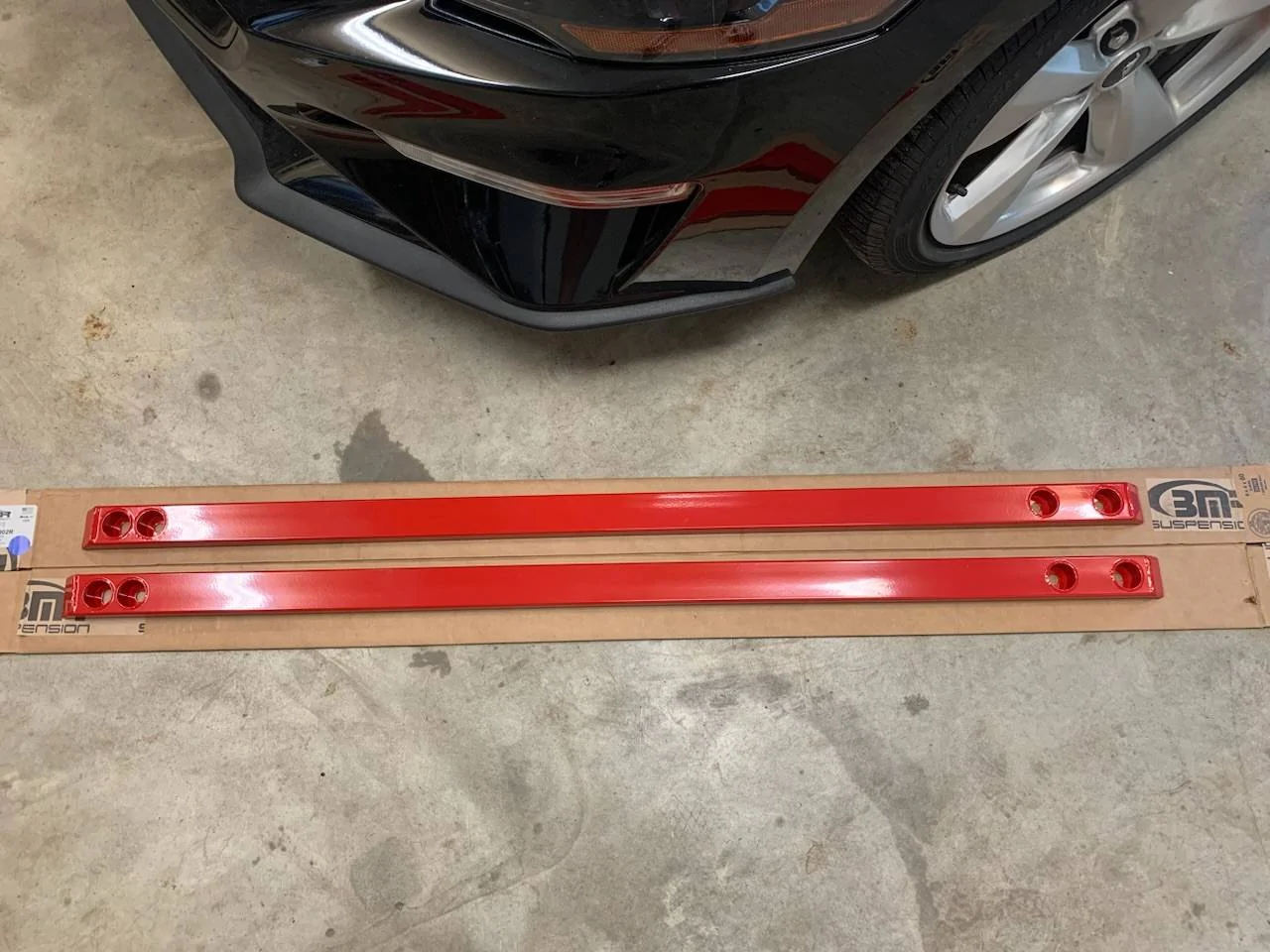

I went with the BMR Chassis Jacking Rail, Super Low Profile (CJR002). It’s really a shame that no one can see them ‘cause these things are beautiful! Combined with a polyurethane floor jack pad (as well as polyurethane jack stand pads) you can jack the entire side of the car up quickly, safely, and scratch free 😎

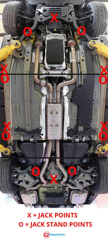

If you already have the jacking rails, you can install them while the car is flat on the ground with very little effort. If not, the image below shows the approved jacking points. Of course, it is entirely possible you will have multiple under body panels in the way of some of the front points.

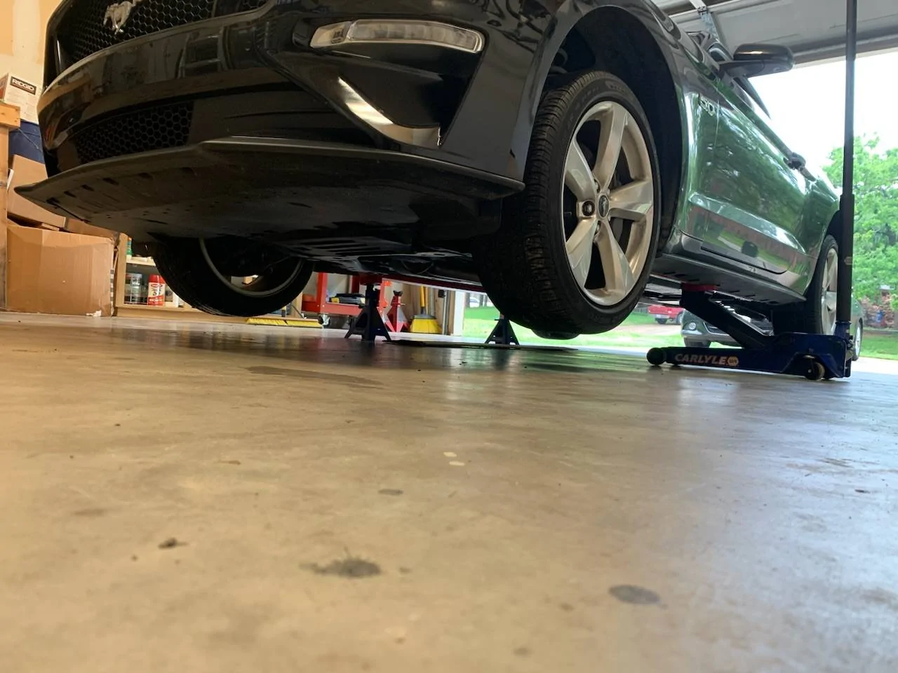

Rhino ramps clear mine just fine.
I use them both on the front or both on the back.
Also when I need to do jack stands I have a low profile jack so I can slide it up under the rear diff, and by lifting from that center point The back gets high enough to stick them underneath the brace that the rear of the car has. If you look at the pictures someone posted above of the underside of the car, where the lift is being used, (And where it should be marked but it isn't) is where I place the jack stands. Easy to line up and quick and stable.
When I need the whole car up I usually put the front on the ramps and then put the rear on the jack stands, and then if I need to get higher in the front I can jack it up easier. I'm a huge fan of the rhino ramps.
Oh. And I do have the performance package so I have that little extra lip on the front and it's still clears the ramps.
However when I am jacking from the rear I make sure the jack handle is slightly angled to the side to clear the light and the "diffuser" fins.
I thought lifting by the pumpkin is not recommended? Also the jack stands on the rear portion near pumpkin is a first for me. Thanks for this visual though. I believe most of these points are shown in my Quickjack Manual.
Yes, avoid lifting by the differential. Since Ford installed these diff's incorrectly, with the bolts in shear, I wouldn't risk putting thousands of pounds of force on the bolts. (Especially the aluminum carriers in the non PP cars)
Yeah, I would only lift by the diff in the live axle cars in the past.
