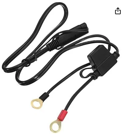

I would like a battery minder/charger that comes with a quick-connect/disconnect set of O-ring adaptors that allow me to keep the two wires connected to the battery but allow me to easily/quickly disconnect it when I go to drive the car.

Really, it doesn't matter that much though. The connectors are inexpensive and readily available on Amazon. If the one you want doesn't come configured the way you want just make your own quick connection pigtail.
I'm getting ready to buy one for a car that sits for 2-3 months at a time. I'm going to make a pigtail that reaches the grill so I don't have to open the hood to connect or disconnect it.

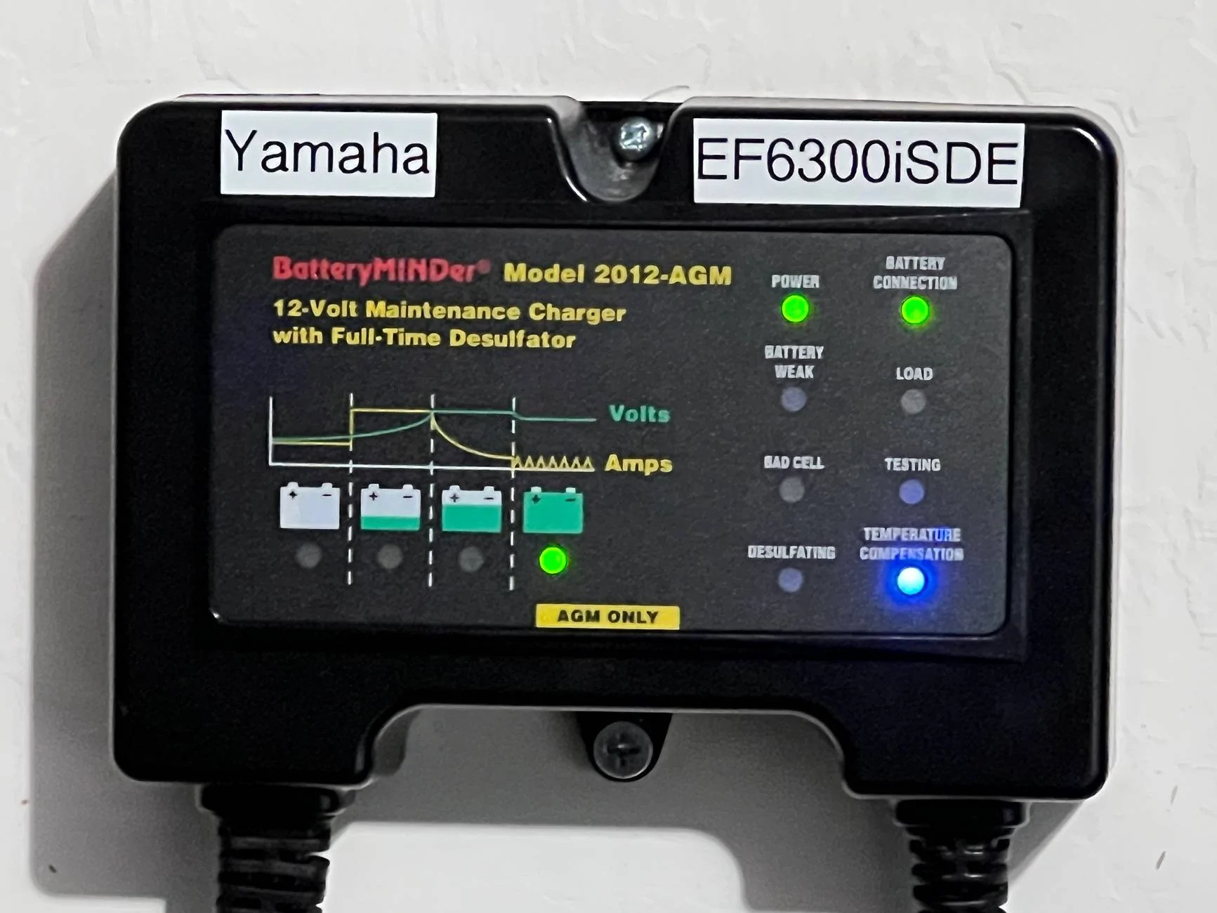

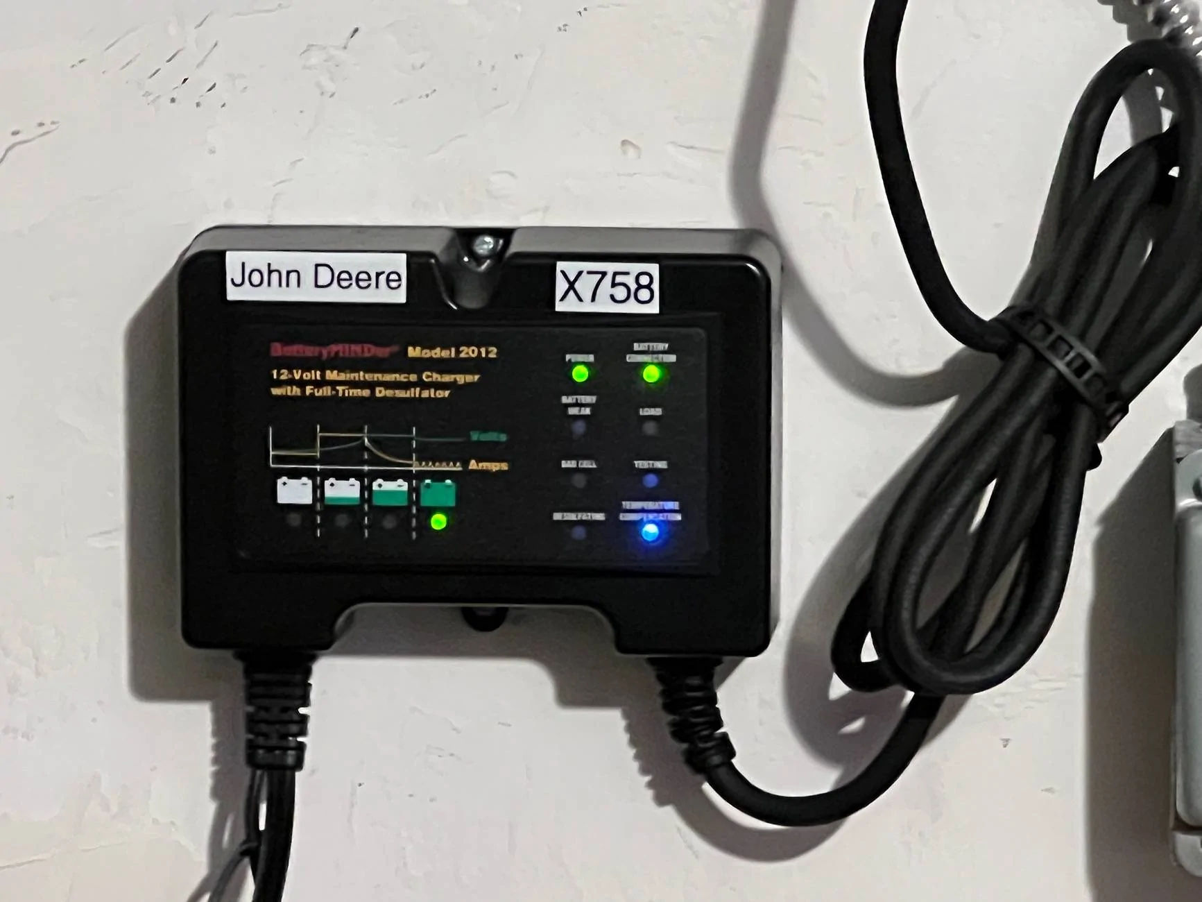

I recommend Battery Minder here are two of mine, the first one is for a flooded Cell non AGM battery and the second photo is for AGM batteries.

I have ring terminals bolted to the battery and use the quick disconnect.

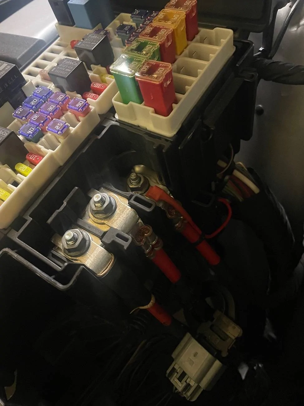

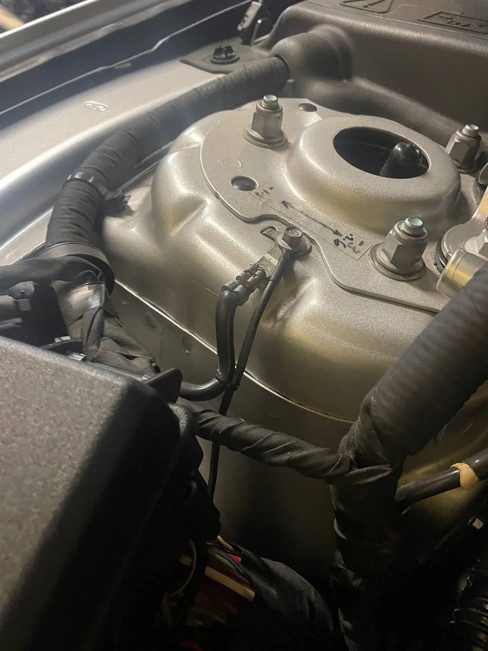

You don’t want the battery charger connected directly to the battery. That play havoc with the Bms ( battery management system)
Connect the ground directly to chassis and the positive to 1 of the positive posts under the fuse box cover
See pictures below
Btw, just to be safe, fuse the positive lead

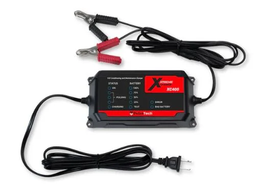

I use the PulseTech battery maintainer / reconditioner. It has been fantastic at restoring / desulfating the battery. It utilizes an in-line standard SAE-2 connector, comes with a matching pigtail for permanent installation on the vehicle, and general purpose terminal clips.

I put pigtails on all my vehicles that don't get used every day. I have expanded to having 3 PulseTech chargers and move them around between the vehicles as needed.
See pictures below
I did not realize a lead acid battery would even have a BMS. I’ve got a lithium battery for my bass boat and it has one built into the battery itself. Are you referring to a BMS on the vehicle itself?
I’m confused because the Battery Tender support staff never mentioned doing this and he knew it was a 2023 Ford Mustang as he asked me.
