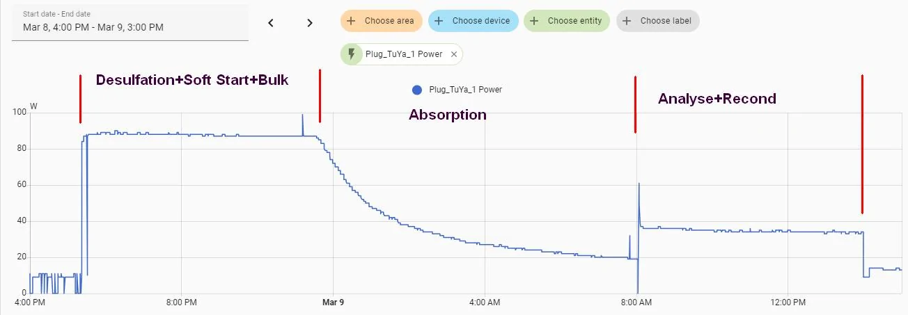

Since I had to face the similar situation yesterday and found this thread to be quite inspirational, I would like to add few more observations.
To the caveats already mentioned by @Bman5150 there is one other interesting detail in the owner's manual:
Remove and Reinstall the Battery
To disconnect or remove the battery, do the following:
1. Apply the parking brake and switch the ignition off.
2. Switch all electrical equipment off, for example lights and radio.
3. Wait a minimum of two minutes before disconnecting the battery. (emphasis mine)
Note:The engine management system has a power hold function and remains powered for a period of time after you switch the ignition off. This is to allow diagnostic and adaptive tables to be stored. Disconnecting the battery without waiting can cause damage not covered by the vehicle Warranty.
4. Disconnect the negative battery cable terminal.
5. Disconnect the positive battery cable terminal.
6. Remove the battery securing clamp.
7. Remove the battery.
8. To install, reverse the removal procedure.
I had to remove the battery from the car for the charging, so did not have to connect the charger to the car, but the from the electrical point of view, you should be fine with connecting the positive cable to the battery and negative cable to the chassis. This should ensure that the BMS stays in the loop for the charging process.
In my case the battery was able to unlock the car with the remote, power on the dashboard but did not have enough juice to run the starter and eventually died. When removed from the car the measured voltage was 11.33 V. Which is pretty low, according to the internet wisdom and the battery should be dead.
I was able to charge it though and even run "reconditioning" on the battery, using a charger option. Now I am just wondering if the battery will hold the charge. Technically the charger also run a test for that, which passed, so I will see.
FWIW since I charged the battery in home on a measured plug, for the interested here, following is a charging recorded in input wattage (the 10 W consumption visible before and after the charge is related to some other device).
The charger I used was EU version of this https://www.ctek.com/us/battery-chargers-12v-24v/mxs-5-0-na and the description used in the above graph matches the charger vocabulary.
