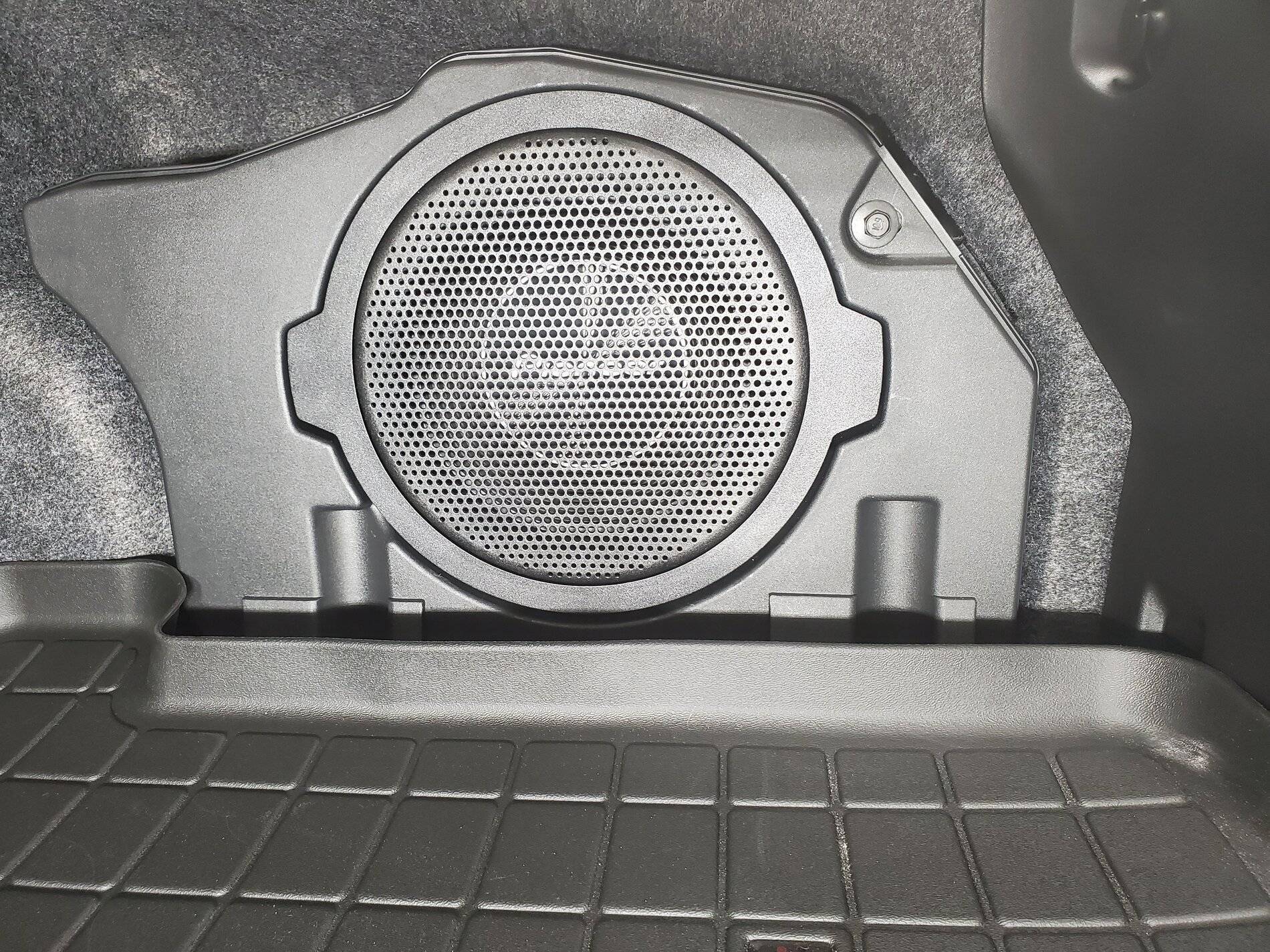

Yes, but without the trim ring. E6000 clear adhesive will hold two pieces of steel together......ok, kidding on that, but is a really strong adhesive that I use for a lot of projects.
So actually you glued the grille with E6000 - on what - the speaker rim?
Can we see the picture of final installation?

I will try to get a pic of it today.

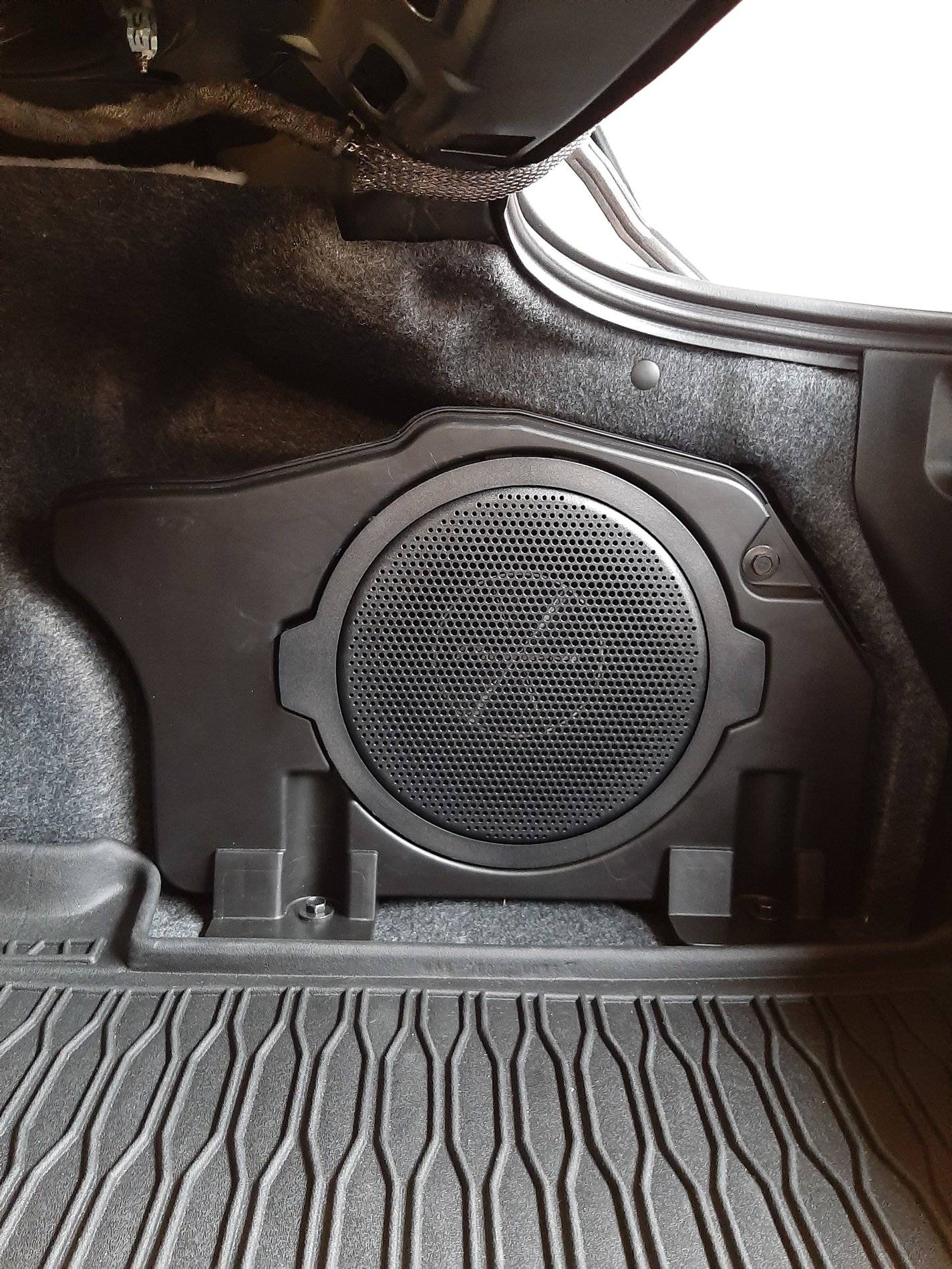

OK for one last time - the Pioneer sub fits perfectly and the trim ring fits back on top. It seals perfectly and there is no issue with the screw locations as it is only a mm or two different. The stock sub is trash and the sound difference with the Pioneer is night and day better.

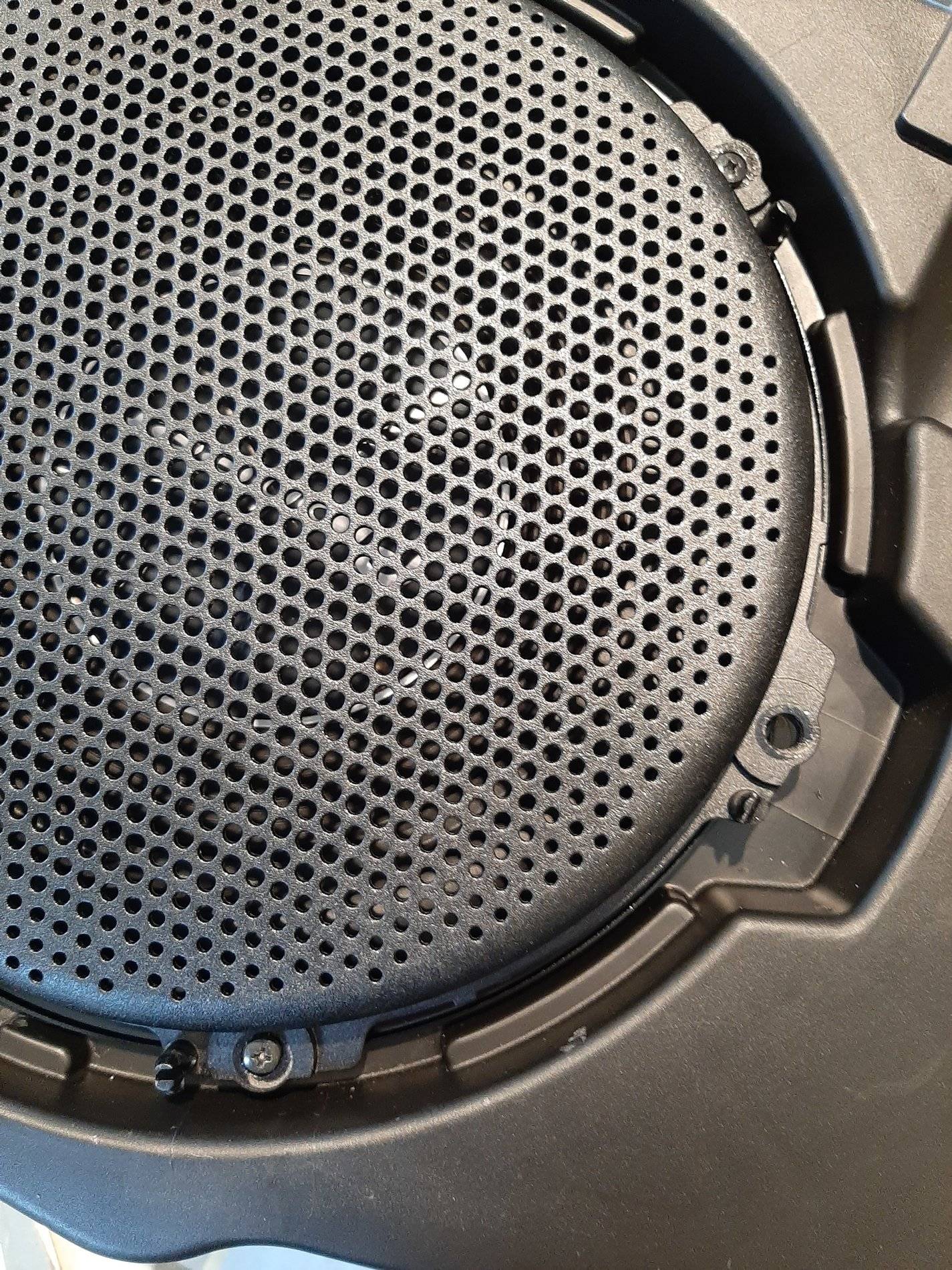

There is enough adjustment to then use the new fitting screws with the OEM grille for the remaining 4 screw holes. The OEM screws will not fit.
Finally refit the trim ring (that you probably broke when you removed the original speaker) and refit in the car.
So finally how does it sound ? Night and day better ! The bass is now controlled and tight as well as not overpowering and at the same time the OEM look is retained.
Is it possible that OEM grille obstructing the cone excursions at high volume?

The install with the Pioneer Woofer is pretty straight forward. I got the trim ring off without breaking anything with the exception of one of the pegs (?) that the trim ring snaps in to. It's not completely broke but the part that retains the trim ring is so, the trim ring is a bit loose at that point. I am wondering what the best method would be to make sure the trim ring is secured at that point. I suspect it will cause a rattle at some point. Any ideas?
