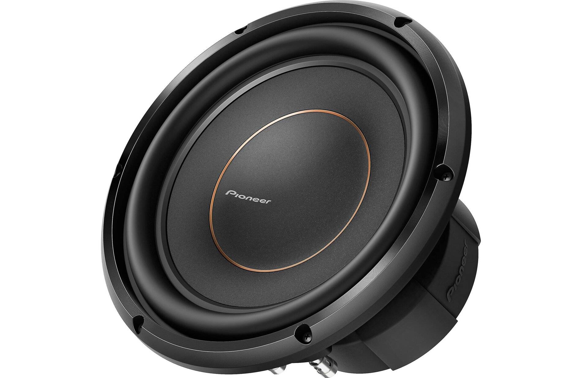

I ordered this one (TS-D10D4).
It's on the way.
Is it a dual-voice coil?
As far as the connector, no way I'd cut any factory wires, but in this case, I don't mind cutting the harness inside the sub box, since you could replace it, if required. But I wouldn't do anything to the one that connects to the sub box. But if somebody wants to replace the sub box, then I'd find the mating connector to avoid messing with the factory harness.
Yes, Pioneer TS-D10D4 is dual voice coil (D=dual, 4=4 Ohm each coil).
I will cut off OEM connectors inside the box and connect bare wires to speaker terminals.
Outside connector will stay untouched.
I will save OEM connectors with OEM Sub for potential future use.
Thanks. So what's the difference between the TS-D10D4 and the 'original' TS-A250D4? I actually like yours better, since it has a more inconspicuous 'Pioneer' logo, hence my questions. Which is better for the stock amplifier? Are they identical in dimensions? Thx.
Pioneer D speakers series is a bit more advanced then A speakers series.
Is there any real difference in sound, you have to discover yourself. There are differences from ear to ear and different expectations, also.
On the paper D10 has a bit better characteristics then A250.
- Sensitivity: 76 dB against 74 dB,
- Cone: Aramid Fiber Interlaced Injection Molded Polypropylene vs Glass fiber and mica reinforced Injection Molded Polypropylene,
- a bit heavier magnet,
- better power handling: 500W against 400W,(don't know the power of stock amp anyway),
But I never try any of them on stock amp. I just (blindly?) believe extra bucks will do some job.
They are practically identical in dimensions.
Try to find some more detailed specifications in attached documents.
