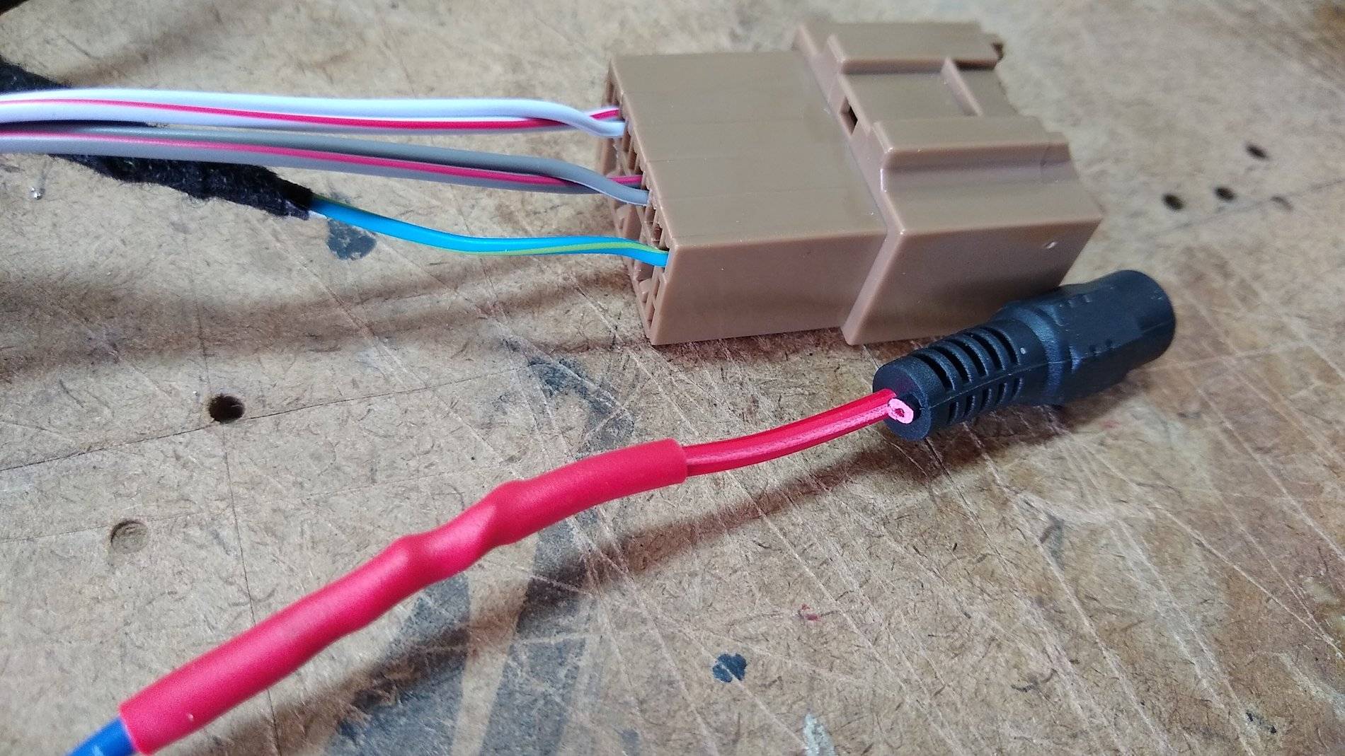

You have two options for a turn on signal. One is easy and the other isn't. There is a 6-volt turn on signal in the brown molex plug that connects to the stock amp.
It's the blue wire with the green stripe in this pic.
Supposedly there is also one in the rear speaker harness, but I've never found it and it doesn't make sense that it would be there in a non-factory-subwoofer-equipped car. If I'm wrong, someone please correct me. Even if you used this signal, it's only 6volts, so you'd need to use a relay or a PAC TR-4 (tiny relay) to switch a 12v signal.
https://www.amazon.com/PAC-TR-4-Rem...&qid=1604286620&sprefix=pac+tr,aps,175&sr=8-1
You could tap the power wire you'd be running from the battery for that +12v signal.
The far easier idea is to use an amplifier that has "signal sense." The JL Audio XD amps have it, just as an example. So do many other brands/models. When the amp senses positive voltage at the speaker-level inputs, it turns itself on. There's a 1 or 2 second delay, but that doesn't matter. I used this method back when I installed my amp and Stealthbox. Worked great, every time.

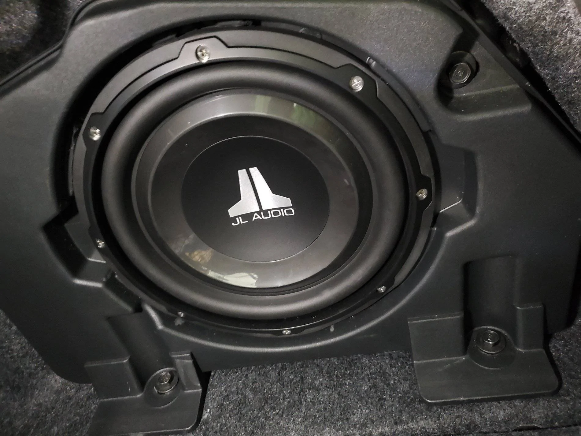

Yes, but without the trim ring. E6000 clear adhesive will hold two pieces of steel together......ok, kidding on that, but is a really strong adhesive that I use for a lot of projects.
Did you manage to reinstall OEM grille over JL 10W1V3-4 Sub?
