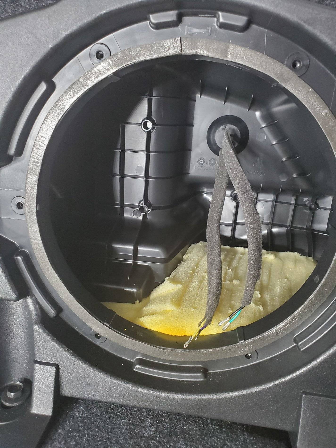

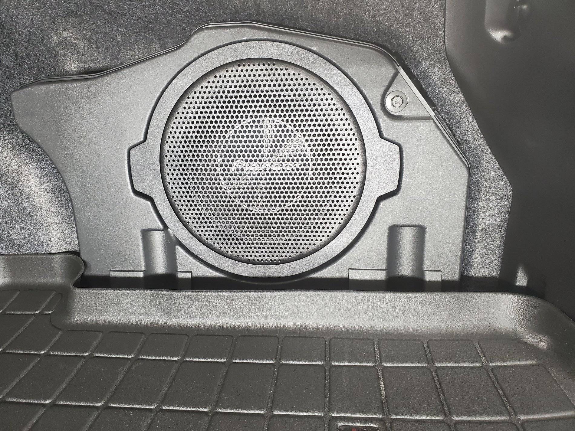

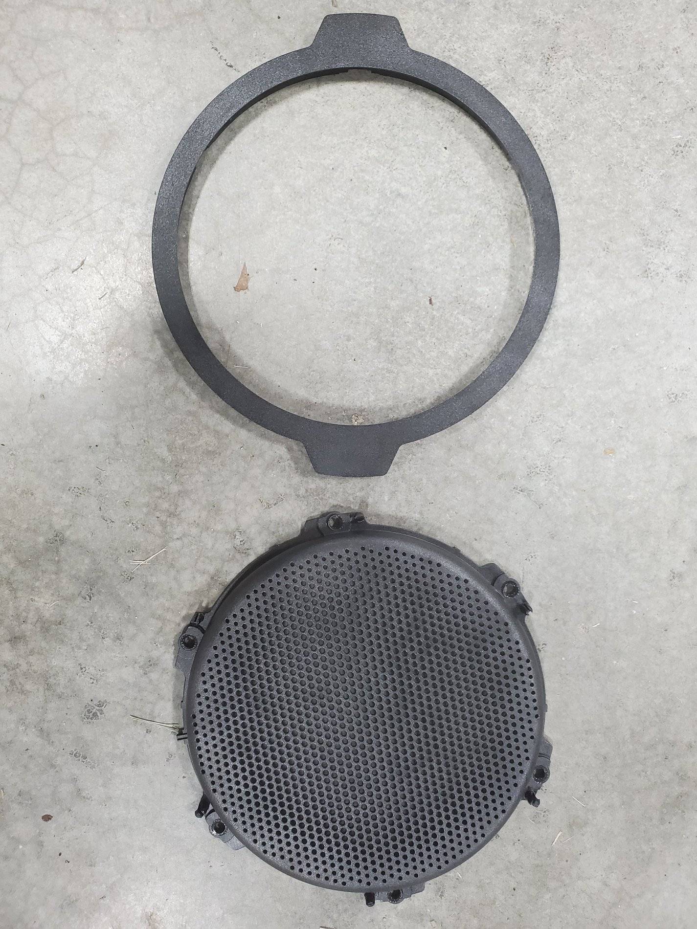

Many thanks to the OP for this thread and all of the provided information. I never anticipated the sub in the optional $995 sound system to sound like an adult bullfrog stuck in a galvanized trash can.

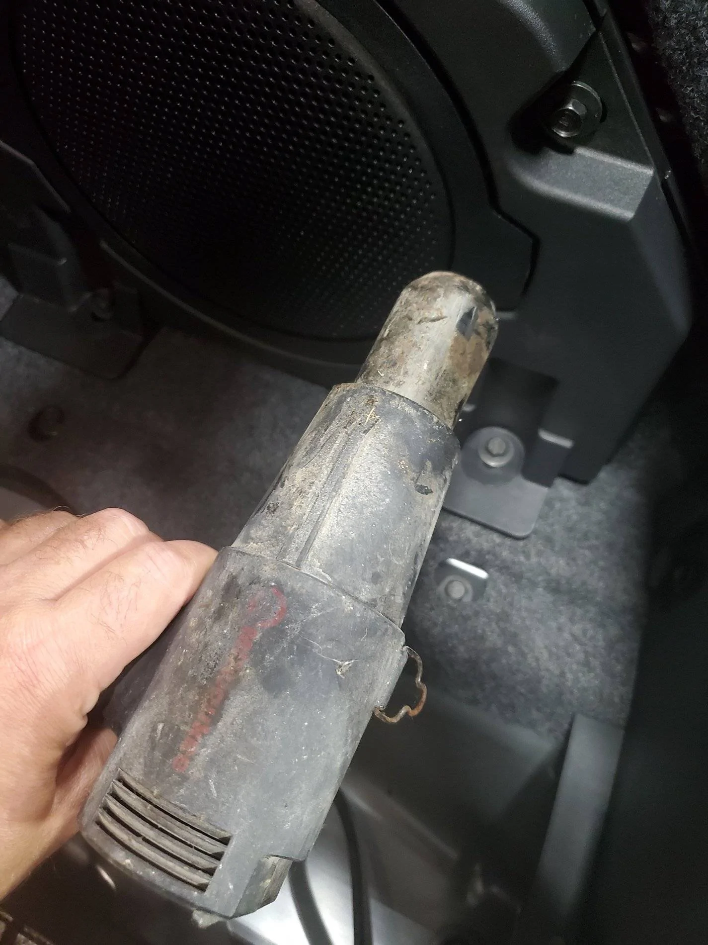

The trim ring comes off fairly easy if you apply a little heat and then use trim tools to pry it off the studs. A few of the tips might break off the studs but you'll be fine.
I used memory foam to insulate the box. It's all I had but worked well. If you are prepared with everything needed, this installation takes only an hour and provides a big improvement in sound for little money.

^^ Congrats on your successful sub upgrade and nice tip on the heat gun. I'll bet many folks wouldn't have broken their trim ring into 20 little pieces with this tip.

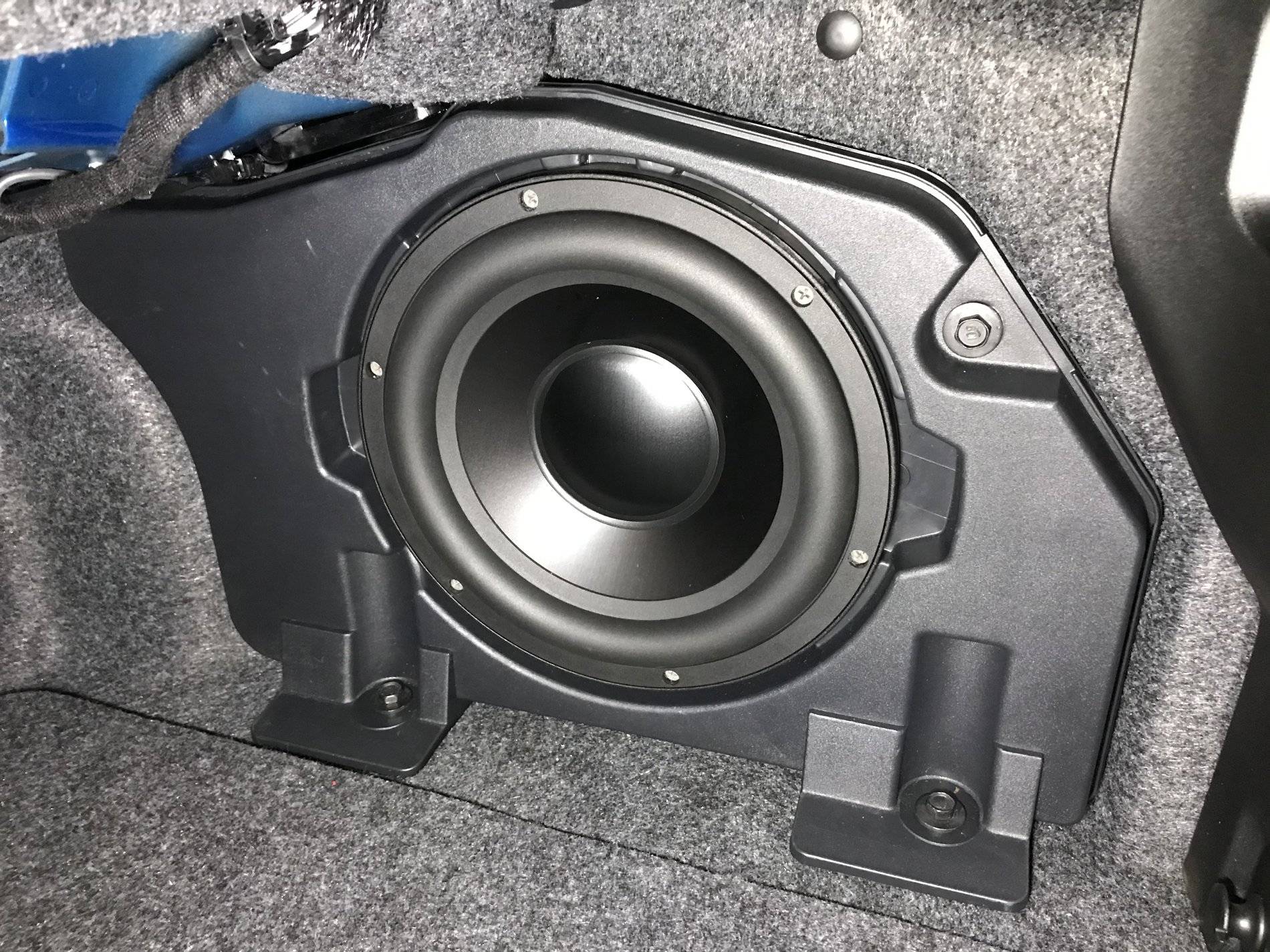

I installed the Dayton RSS265HO-44 in my 20 convertible, no mods to then enclosure, and I'm just going to put a waffle grill over the top of it. I did use a gasket on the back of the sub as it does not fit fully between the ridges, nor does the basket fit in the hole unless it is cut. But I'm happy:)
