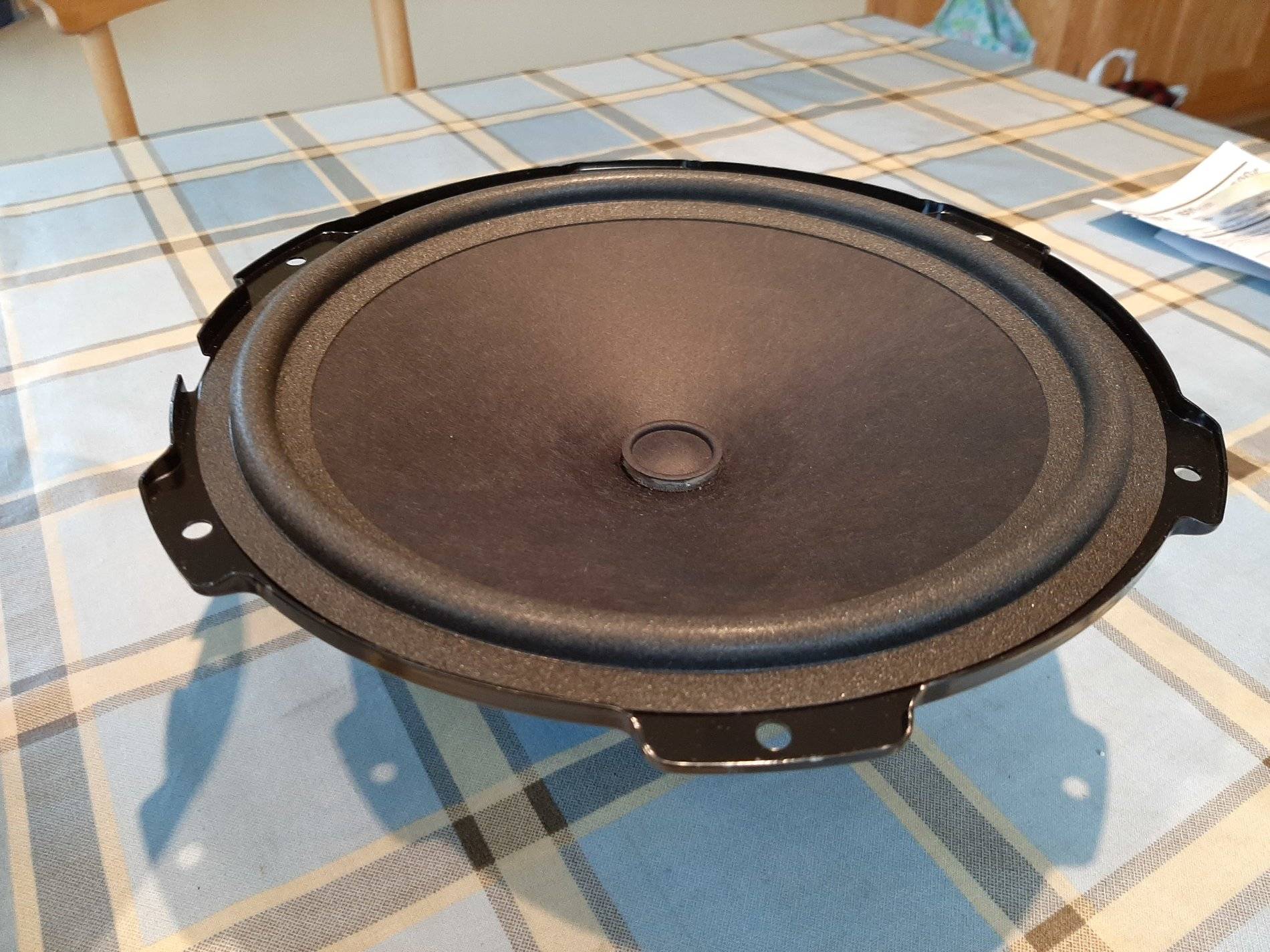

The 10" OEM sub in the B&O equipped cars is generously described as low quality ! It is nothing more than a $12 paper cone speaker and is a huge weak link in the standard system with a horrible boomy muddy bass that overwhelms everything else. I have played around with settings and added polyfill but it is still pretty woeful.

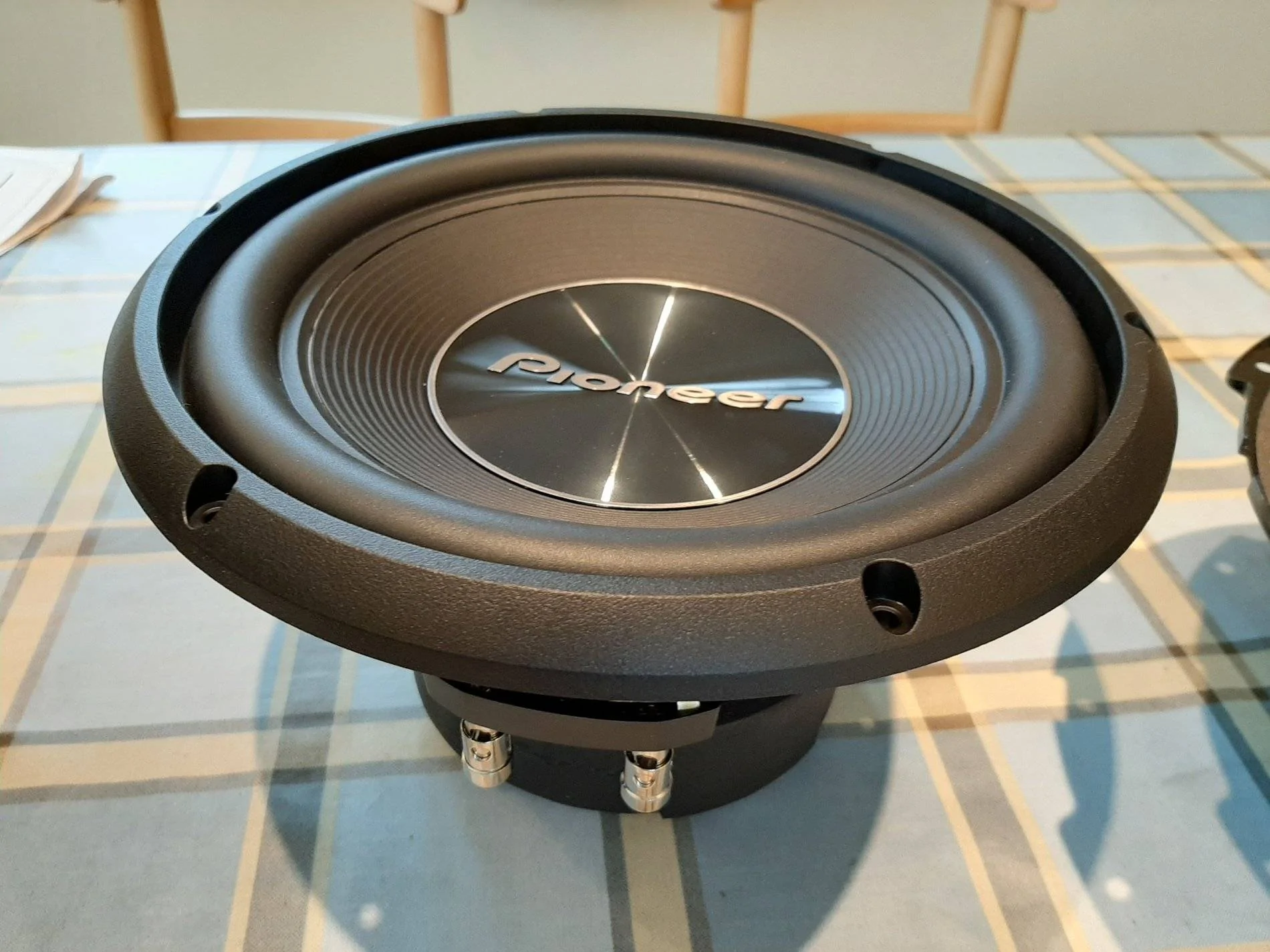

I settled on the Pioneer TS-A250D4 10" subwoofer (TS-A100D4 in the US). This will fit the box almost perfectly, is dual voice coil, 4 ohm and has a relatively low sensitivity of 77dB which helps to overcome the bass heavy settings Ford use. At this point I should say I am NOT looking for a thumping bass but a musical well controlled base. In the UK this is around ÂŁ65 so is not an expensive speaker. There are very few other speakers that will fit this box without significant modification so be warned - it is not as easy a swap out as with the 8" box in the Shaker system.
First picture of the woeful OEM sub - seriously Ford why bother !
Next the Pioneer TS-A250D4 10" subwoofer which at least looks half decent !

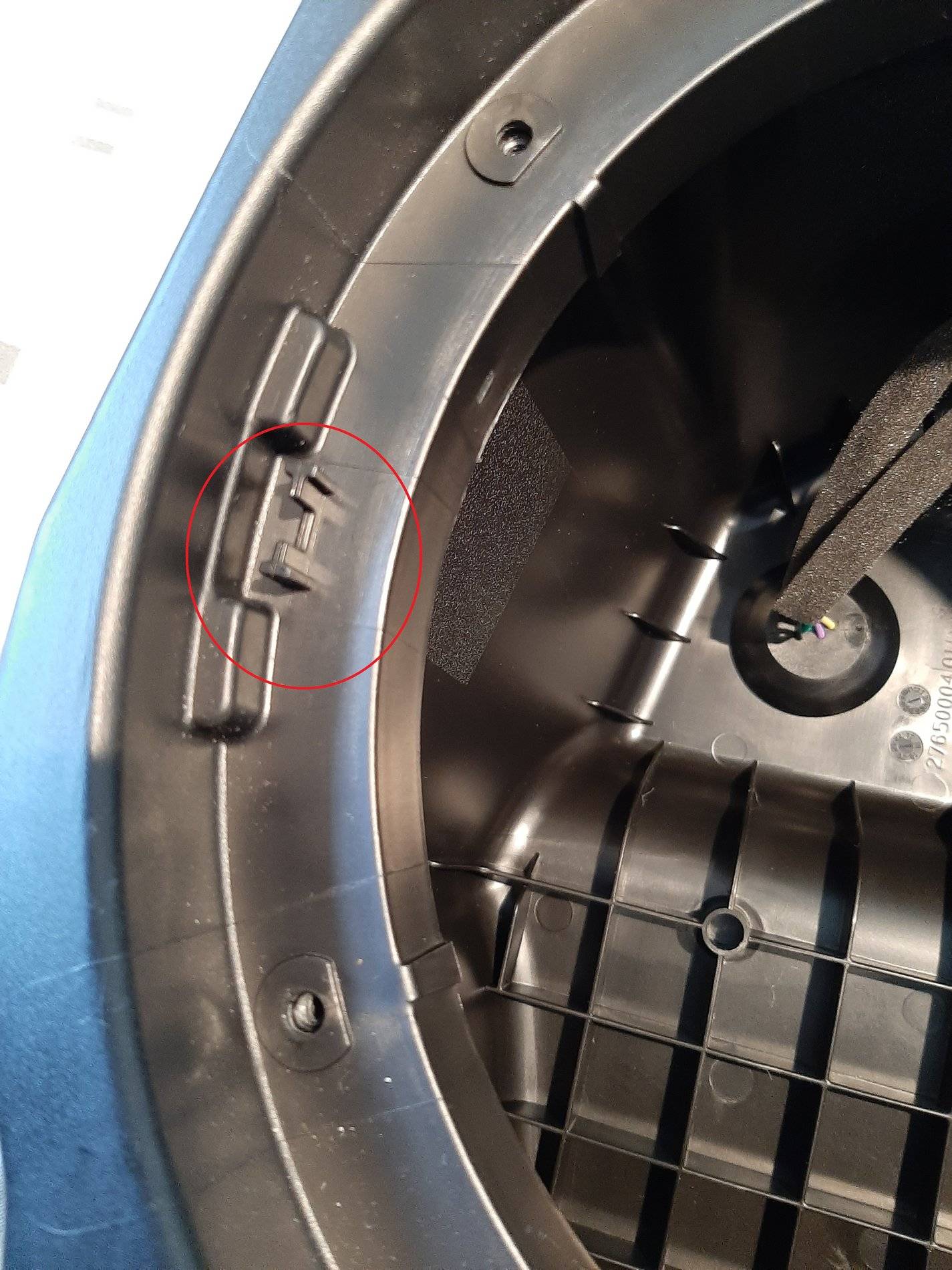

Remove the trim ring - you will not need it. Remove the small lug on the OEM box as it gets in the way - this is the only thing you need to remove.

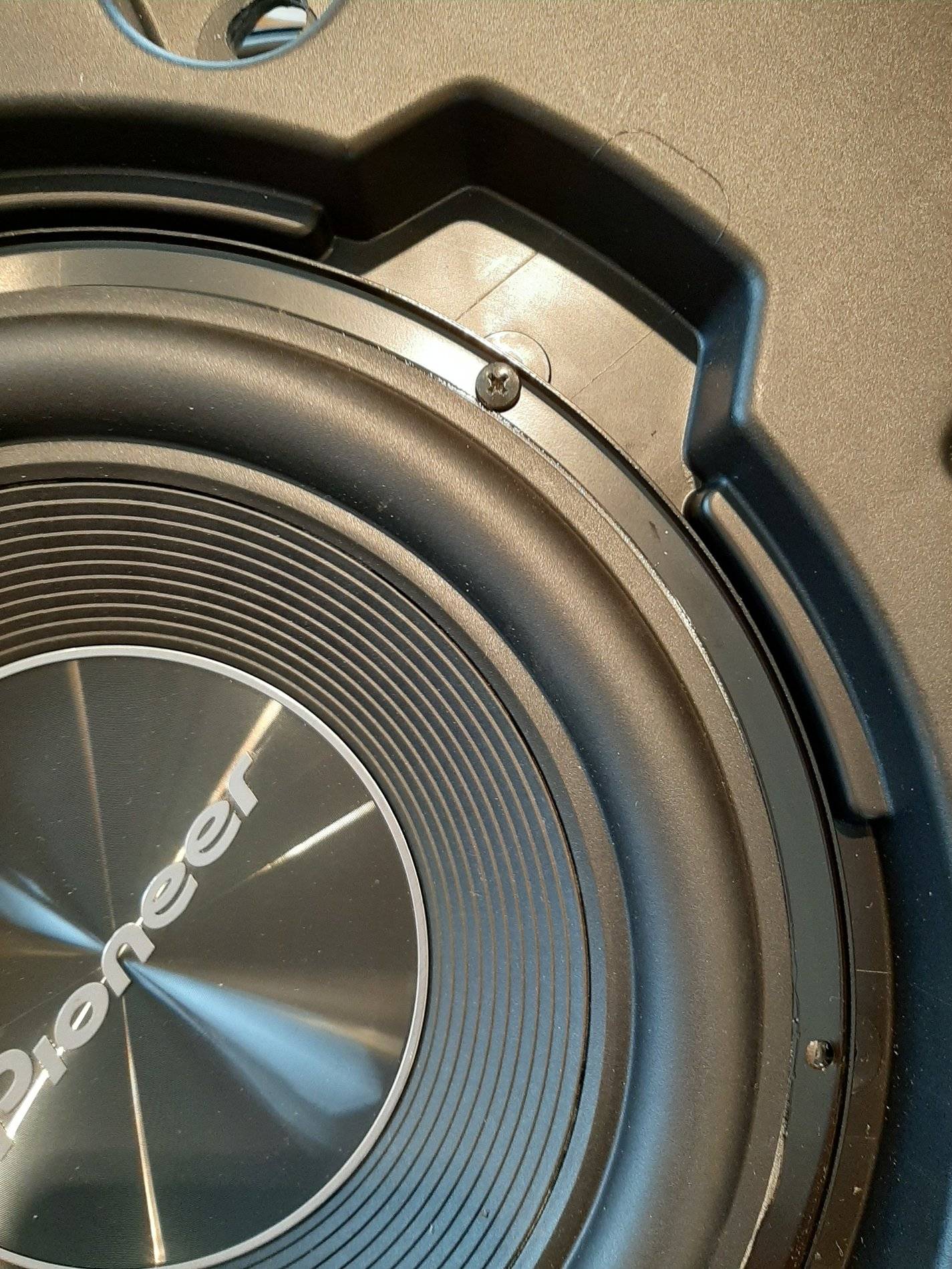

If you offer up the speaker to the enclosure you will find the holes are almost in the right place but not quite. I drilled holes just to the inside of the originals.

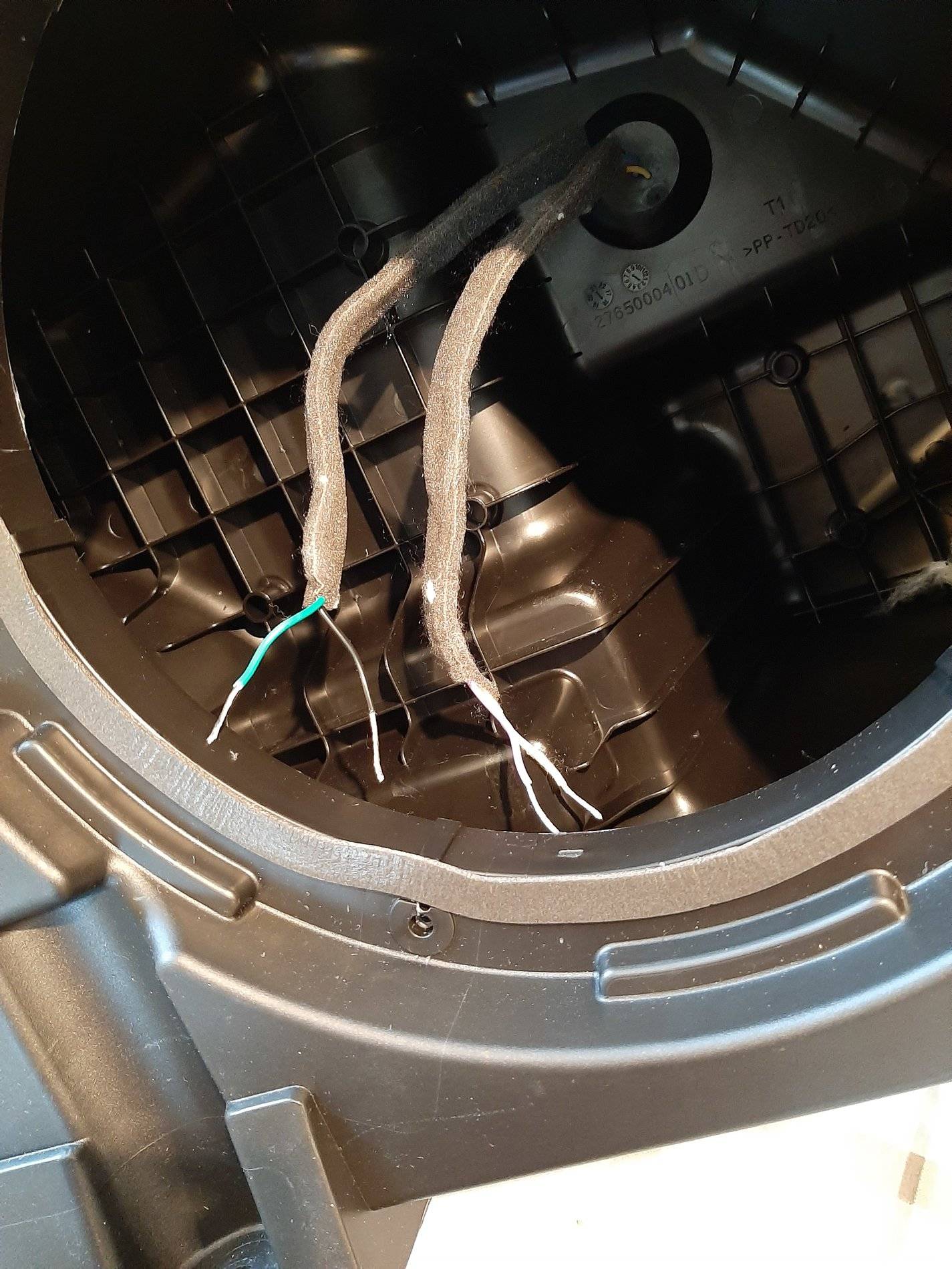

Remove the plugs from the original wires and strip back to expose the metal. The black and purple wires are negative, the green and yellow wires are positive. I added the sealing strip to the enclosure rather than the speaker because it is a lot easier.

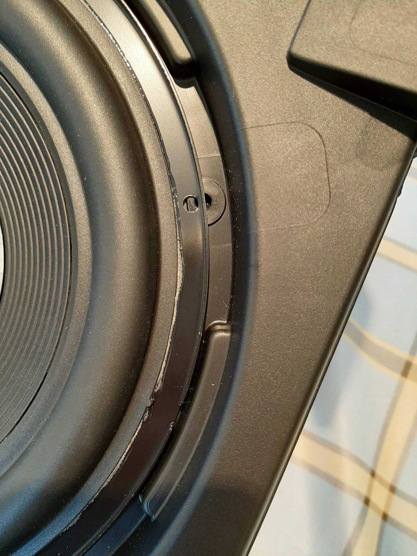

Once all connected and polyfill added I fitted the speaker with two of the screws directly - I did it this way to get a good seal with the box. Leave the others for the moment.
There is enough adjustment to then use the new fitting screws with the OEM grille for the remaining 4 screw holes. The OEM screws will not fit.
Finally refit the trim ring (that you probably broke when you removed the original speaker) and refit in the car.
