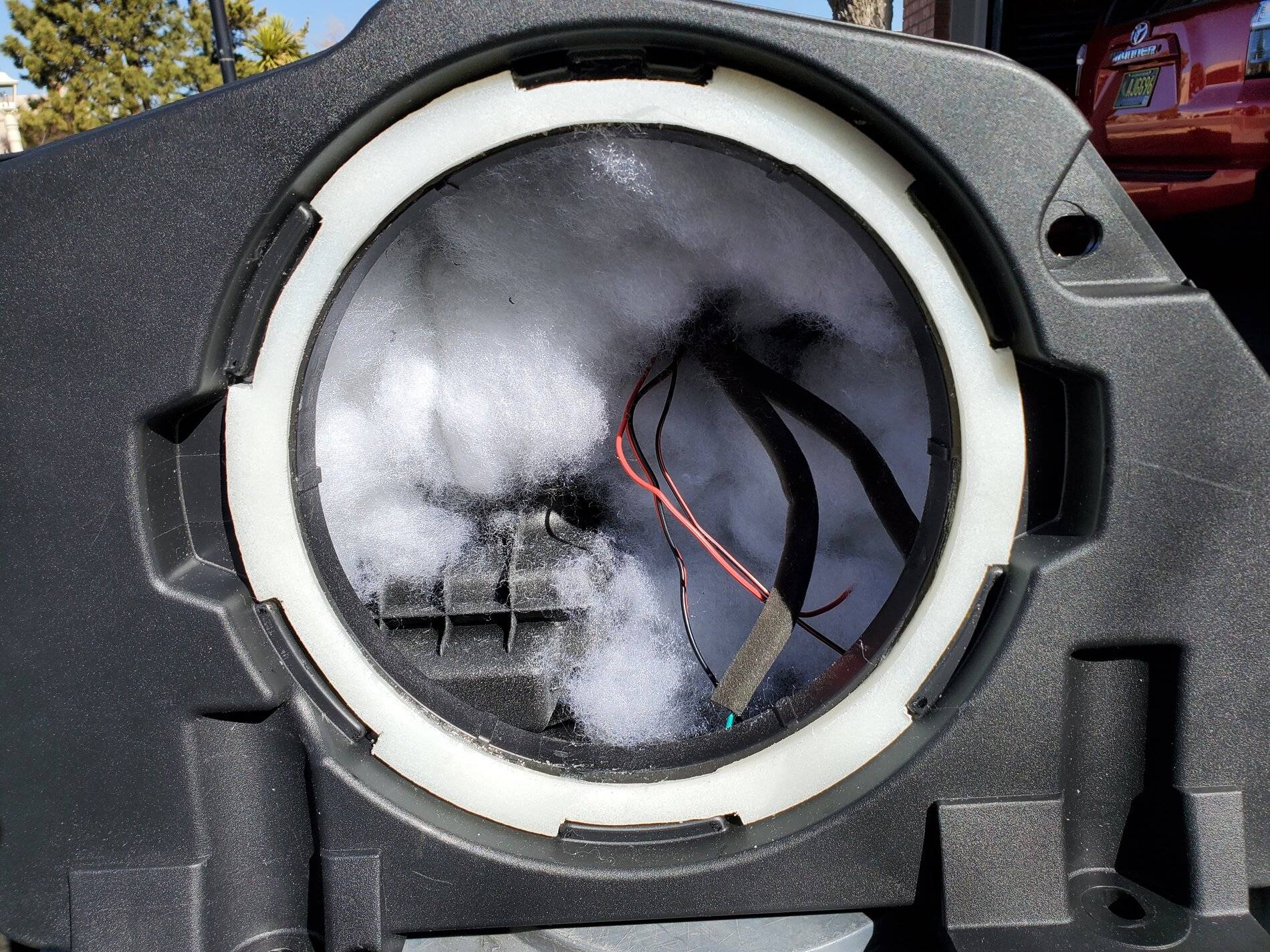

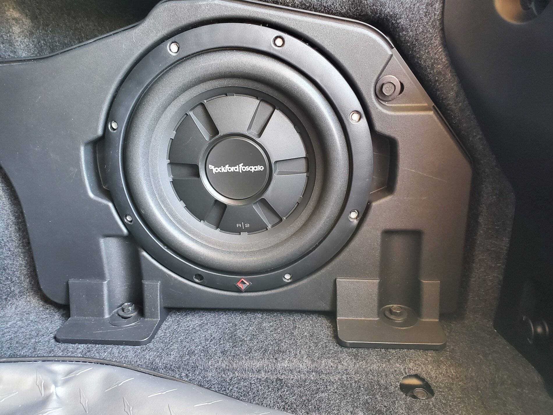

A big thank you to Gregs24 who started this thread and provided accurate and helpful information! I decided not to hack up the B&O sub enclosure. Instead, I found a cheap cutting board at Walmart that is the same thickness as the plastic ridges/tabs/protrusions that are around the edge of the original speaker mounting surface. Last evening I cut an adapter ring that gives me a mounting surface for a Rockford Fosgate R2SD4-10. Nice thing is this resulted in the sub surround sitting flush with the outer edge of the enclosure depth. I try and post a pic of the final intall.

I think it looks pretty good. One screw short! I would give the sound a 6 out of 10. Going to add an amp and sub.
I’d amp that one, see how it sounds first
With proper power it may sound 8/10
