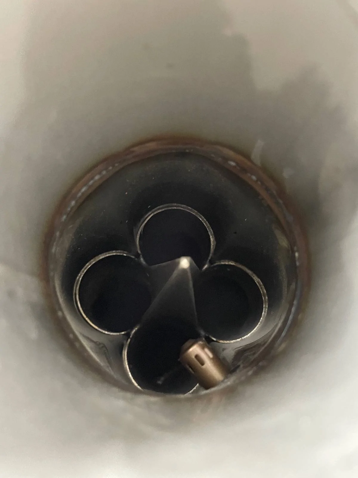

Here’s a shot of the inside and outside of the Ultimate Headers that are on my 2019. I never paid attention to the cone inside the collector until reading this thread. Does the length of the cone play a role in the header’s torque output?
I haven't studied it but I believe it is there to straighten the airflow. Stop or reduce turbulence. That collector looks decent unlike the earlier Kooks.
The spike does a few things.
It fills an open void area where the primary’s join together to reduce turbulence or better said exhaust gas eddying. (As K4fxd posted above)
If the header primary’s are arranged correctly the exhaust gas exiting the primary will remain attached to the spike and collector side wall thus helping to create a depression or “low pressure” inside the adjacent primary. It does add horsepower, how much I’m not sure.
There is a term for the primary arrangement I’m referencing. I’m going off the cuff but I believe it’s referred to as rotational fired. It’s very effective especially on inline 5’s and 6’s

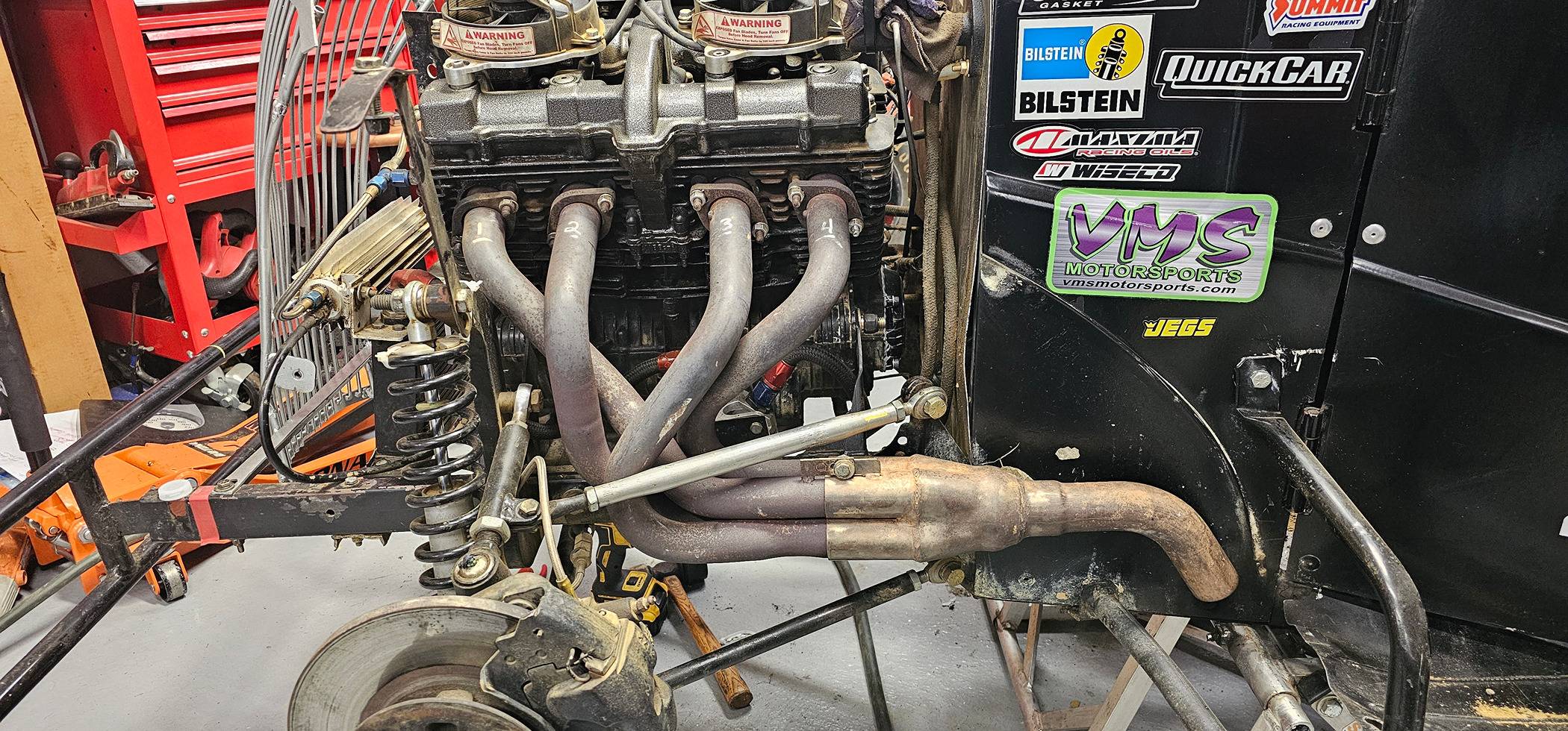

Anyone see an obvious problem with these?
