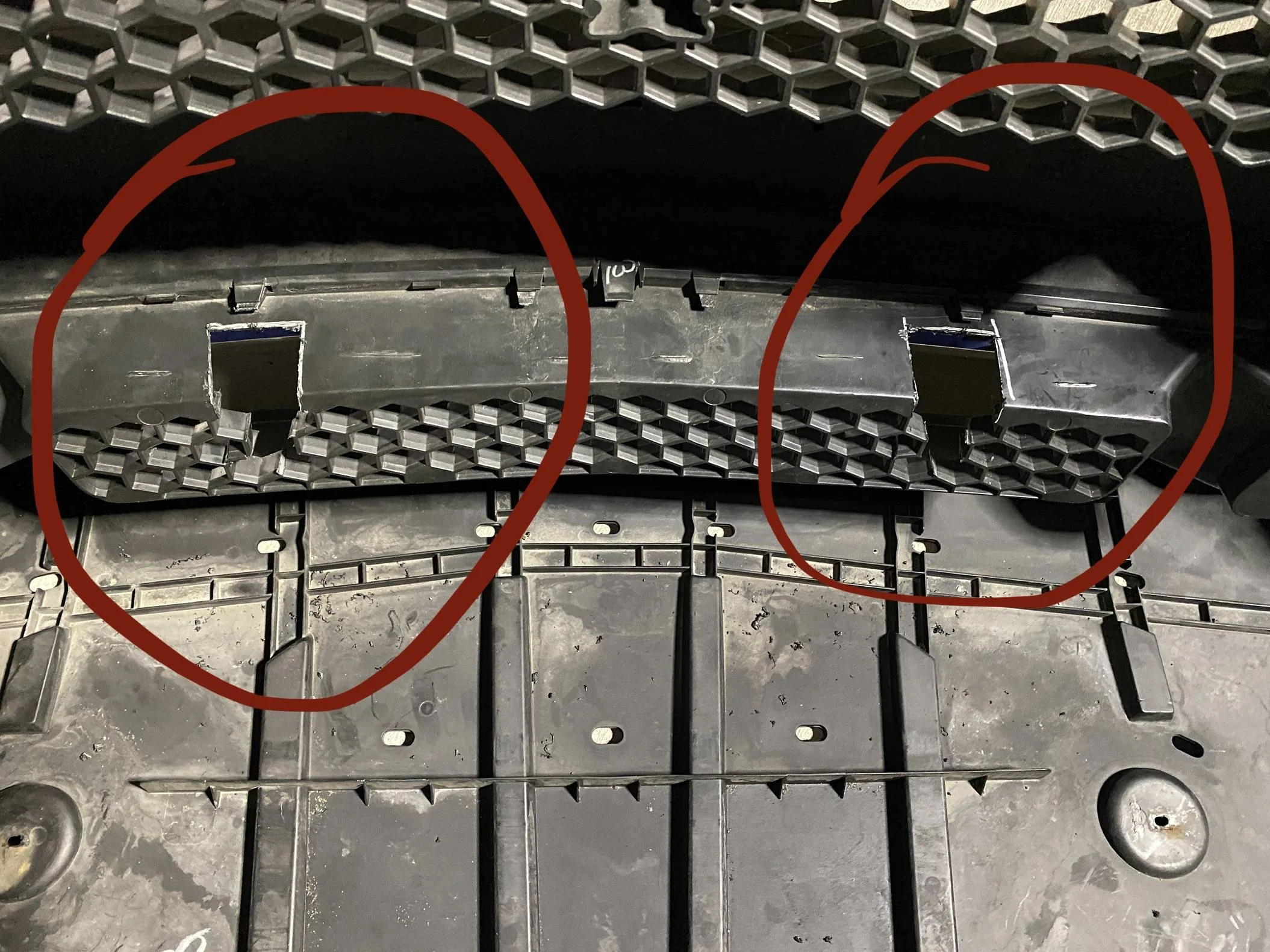

did you have to go through the bumper at all? Trying to figure out a way that will avoid having to drill through anything to get to the bash bar.
You have to put notches in the lower grille. That’s about it. Rather that than bumper

Basically same thing here. Holes in the plastic grill (not bumper) to pass the rods through to rivnuts in the bottom of the crash bar.

I had never thought about the rivnuts. I just got my rivnut tool the other day. I'm going to install those the next time my bumper is off.

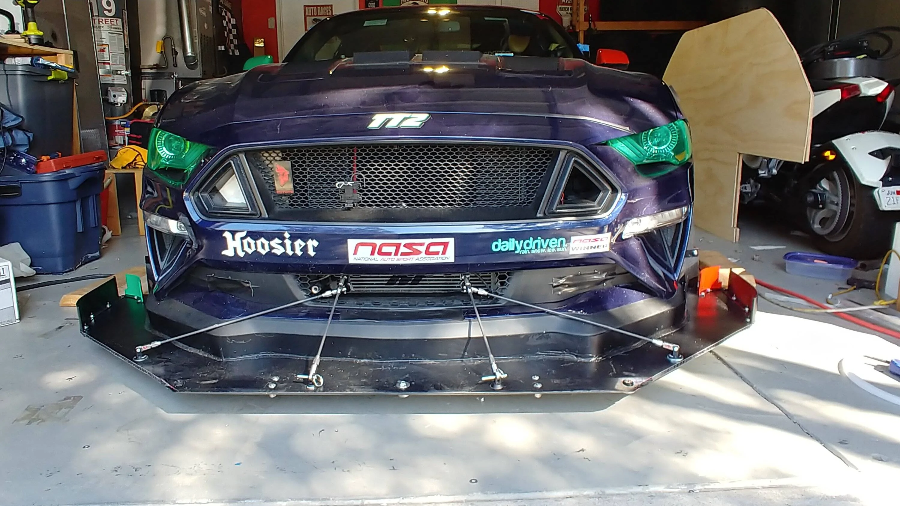

Did you purchase extended rods? Also have you guys seen this way? Just wondering how I would fabricate it to copy the setup. Not talking about the sides but just the front rods and support

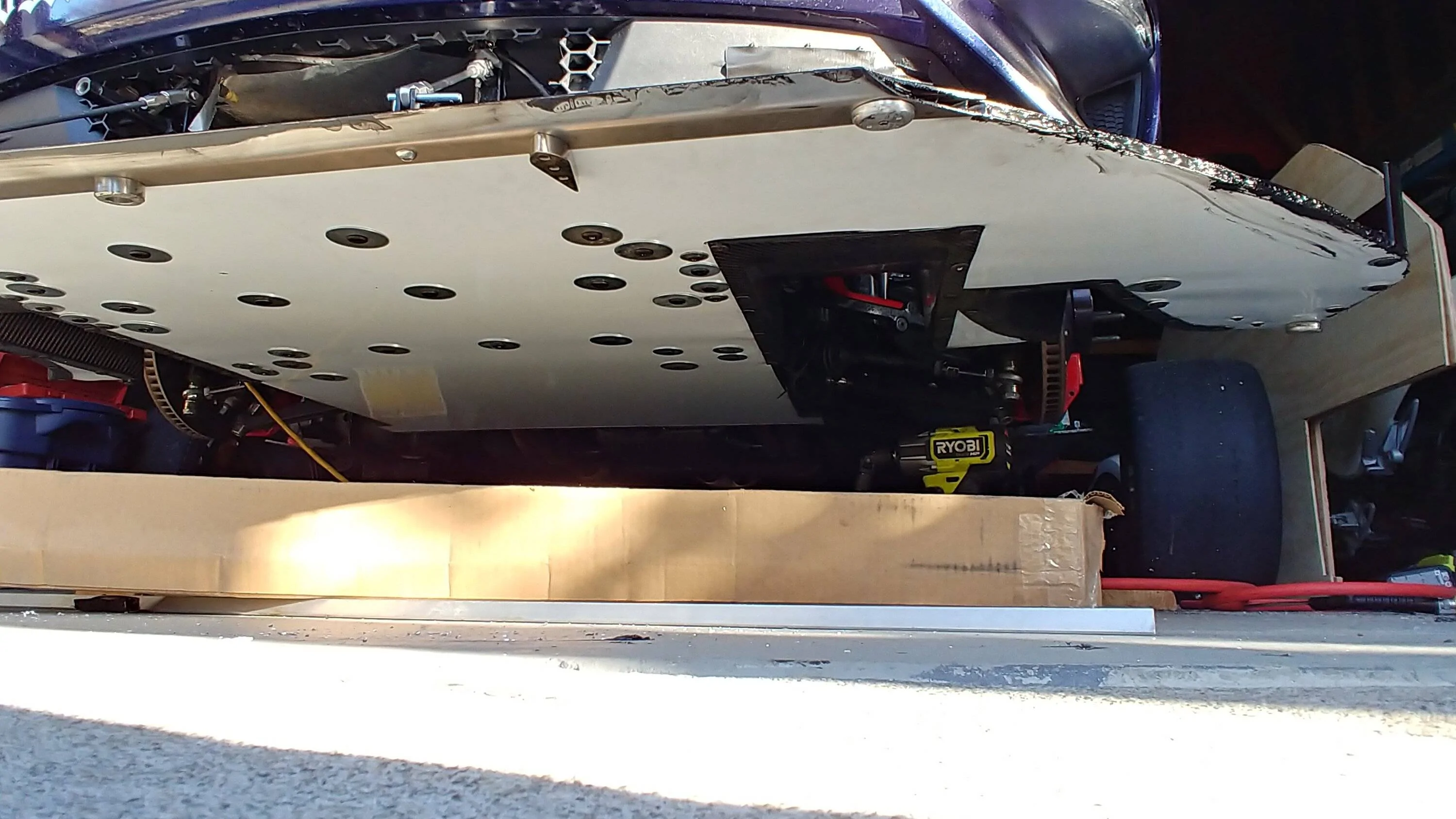

I hard mounted mine to the crash beams of the front subframe so no rods needed.
It was a trial and error process over the course of a few track days but I'm very happy with the results.
Do you happen to have a more detailed write up on your setup with the parts you used to mount it to the subframe? Did you get yours down to 3" off the ground? So the quick latch on the bumper just allows for easier removal if needed?

Alessandro, I was wondering if you had a write up for your homemade splitters? I believe your latest one is designed to be removed quickly since it's a street car ;). I would like that option. I also don't need nearly as much downforce as you (yet) so I would build it a little smaller and just make it down to the 3" mark.
I don't quite understand how it gets down 3" above the ground. Based on my measurements the stock splitter (without the PP2 add on) would be about 5.25-5.5" off the ground. If the new splitter gets down to 3", how do you fill the 2+ inch gap?

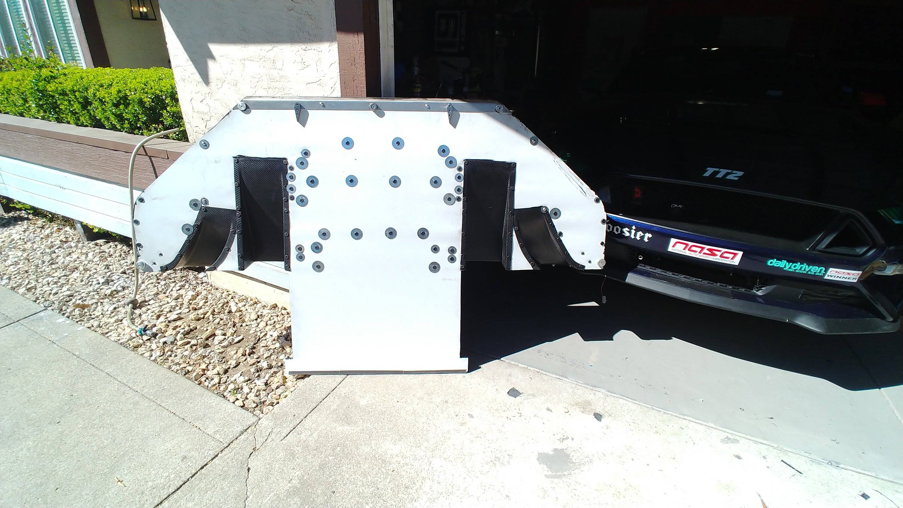

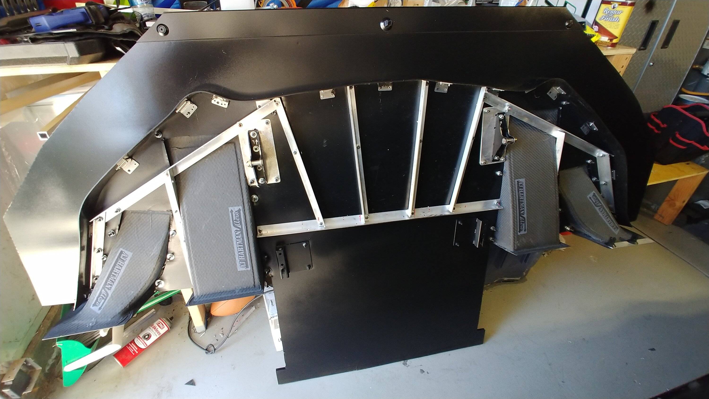

Good video, but why even bother with the OEM plastic belly pan then? Seems like it's redundant and being sandwiched there for no reason.
You could have cut out the venturi part of the OEM belly pan and riveted that over the APR splitter then tossed the rest of the pan leaving only the APR splitter. Basically combining the 2 into a single piece.
2morrow
DesignR/DriveR/RiceEatR
Nov 15, 2015
58
6,500
6,121
NorCal Bay Area
Todd
'16 Mustang GTPP
Thank you, thats what I did in the second part of the video.
It was a more complicated assembly but relieved a lot of problems

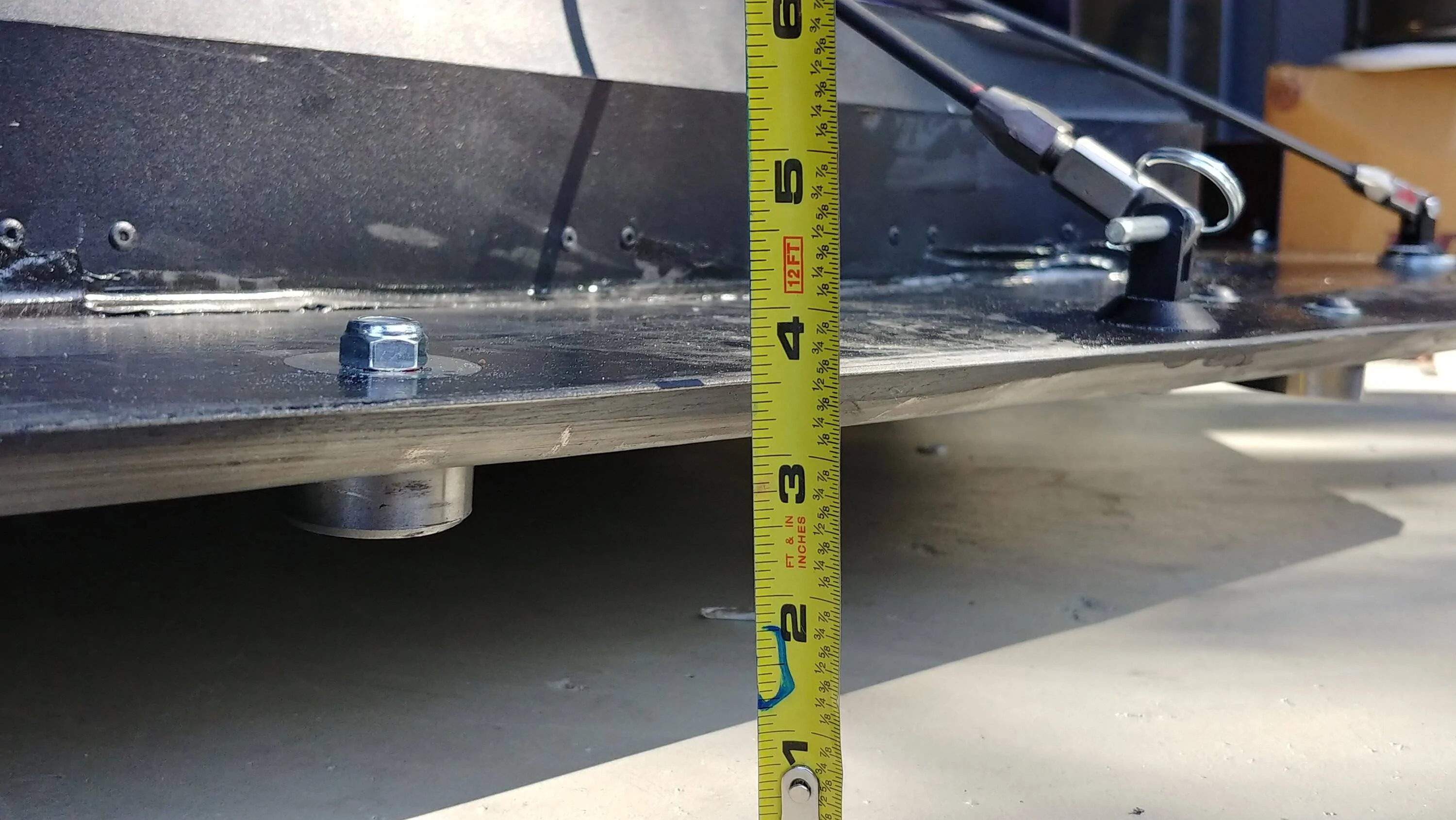

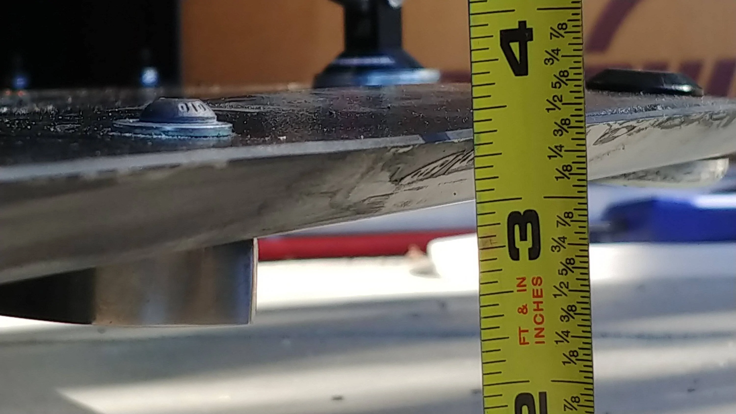

I like the ZL1 option with the fender extension. However, being made of ABS plastic, is it too flexible to be effective?
What tunnels would be added? More than just the brake cooling tunnels?
I do not. I might do a video maybe one day lol.
Check my IG. There are many post on it.
Yes to go at 3" u need to fill the gap
I use an abs sheet i bought on amazon. Called airdam
10 ft Roll of Airdam/Body... https://www.amazon.com/dp/B07B8TYCW4?ref=ppx_pop_mob_ap_share
And then u mold it to follow contours. And secure to the splitter.
I have an extra set of gen1 splitter (only blade) holder brackets if u want. Or you can use the prof awesome one but u need some fabricator to make an "L shape Bracket to o attach them to.the crash bar
