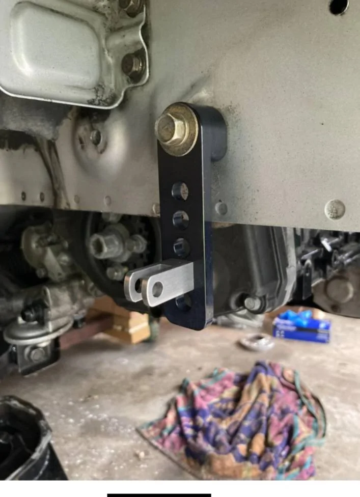

I found these and ordered a pair to mount to the crash bar. Your thoughts?
FUN2RIDEFAST
Jul 17, 2019
89
890
938
Ofallon, Missouri
2017 Mustang GT Premium/PP
I like that! now you can adjust the angle and length also.
I'm going to make an install video using those brackets. Any strain on the splitter is exerted top down so theg should do the trick. I'll let you know if I need longer rods than those supplied with the splitter. Thanks for the feedback.
