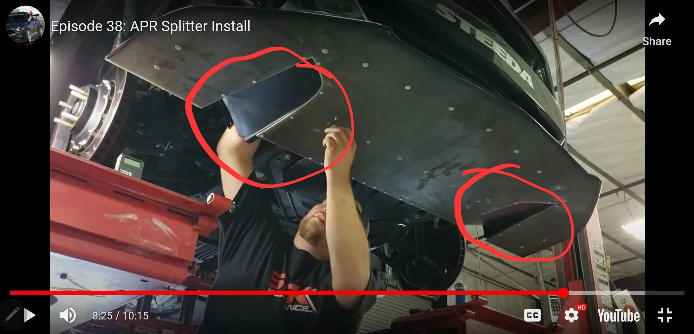

What's the purpose of those cutouts? Air flow to intercooler?
Those are venturis to feed the brakes. All PP cars have a belly pan like that that channels air to a deflector then to brake assembly. I simply grafted mine onto the splitter
