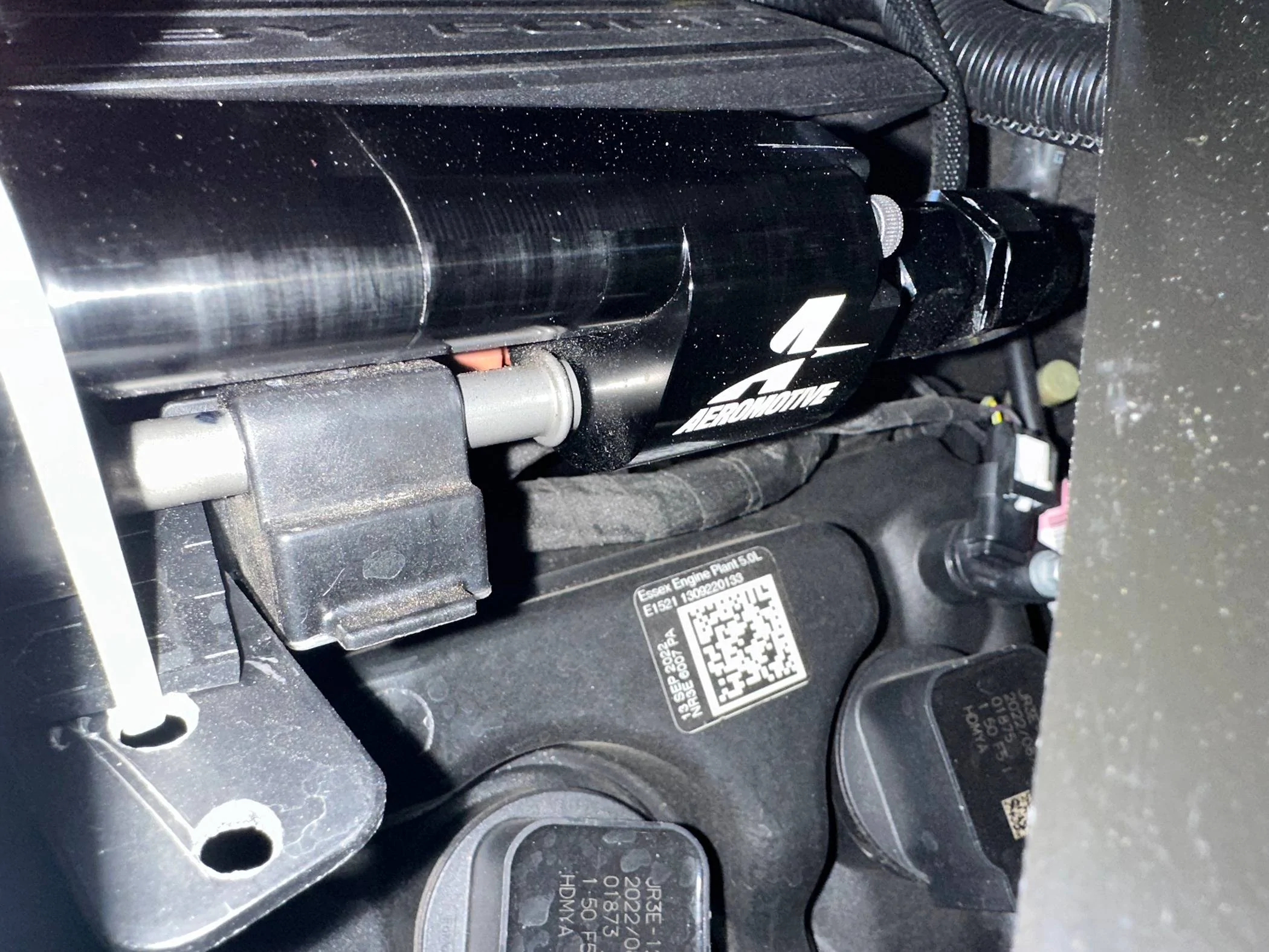

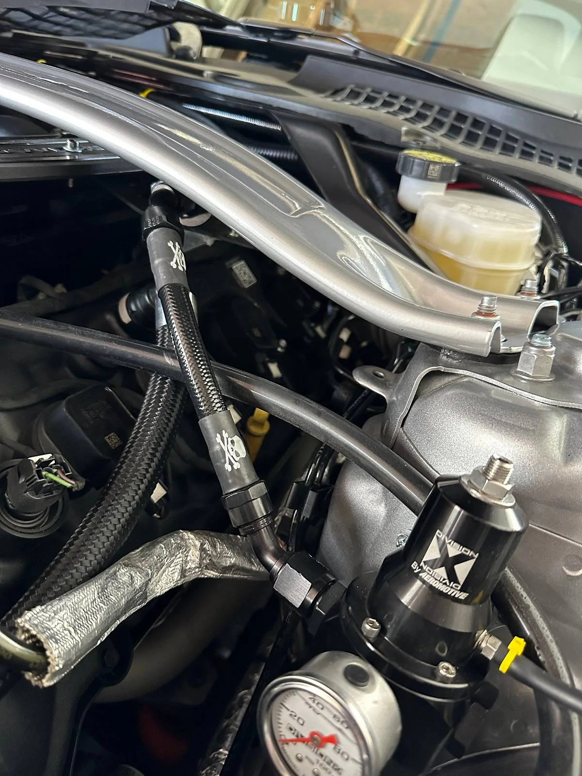

I have the Fuel it Bluetooth dongle and Continential ethanol sensor plumbed into the return side of my fuel system with -8AN lines, using an Aeromotive sensor adapter. The adapter allows up to a -10 fitting and line to be used. The harness on the Fuel-it kit has the output wire (white wire) already installed so that you can run it directly to CANBUS like @mejohn50 is doing so that you can have true flex fuel tuning capability with PCMtec, and use the Fuel-it app on your phone to look at ethanol content and fuel temperature. Kind of hard to see under my strut brace.

Nice setup. I don't plan on installing my fuel return and go to E85 until around Mayish. Thanks

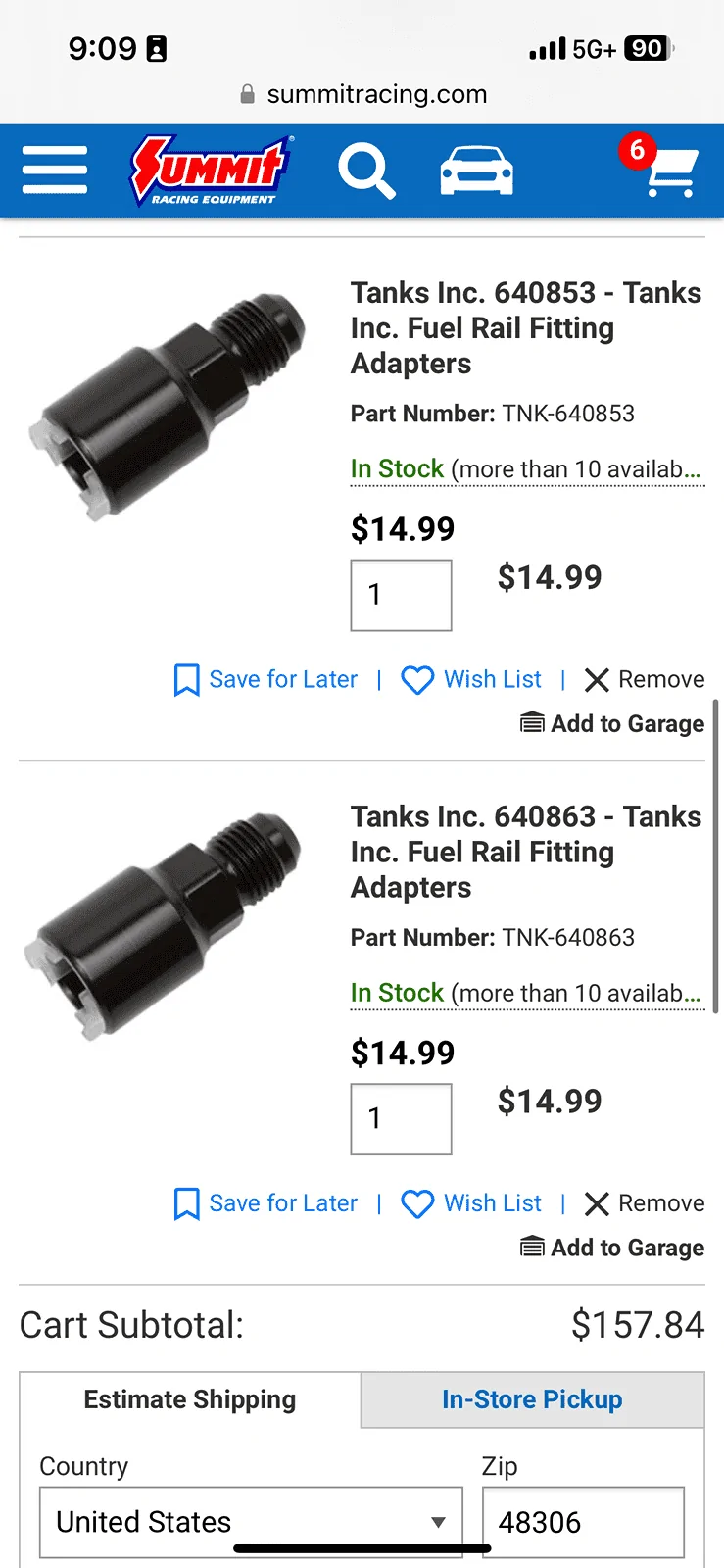

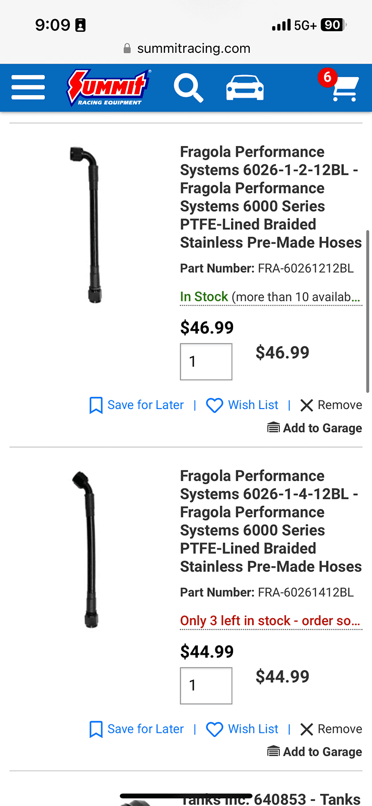

I’m running rubber hose right now, going to order these parts to covert to ptfe. Will let everyone know how it works out/if any substitutions should be made.
